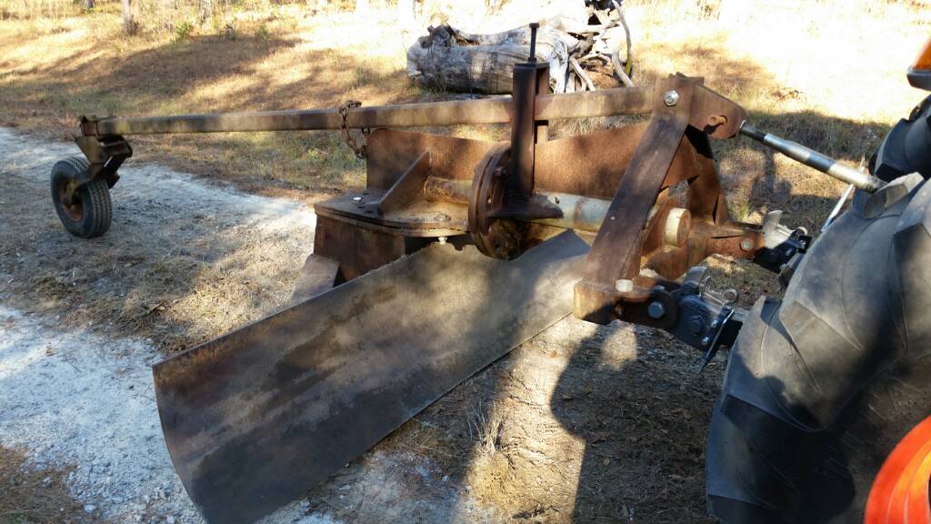

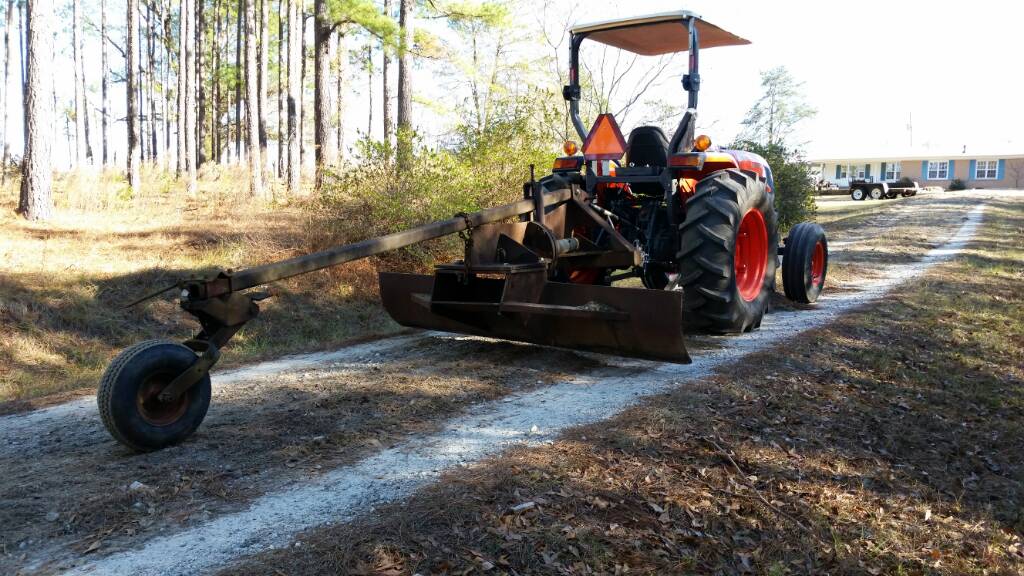

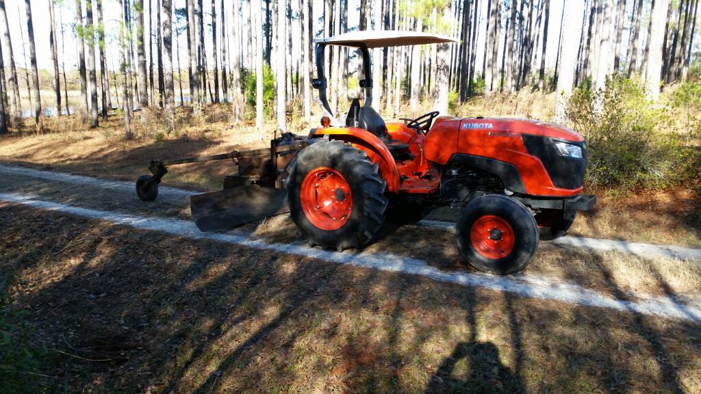

Since it's looking like they aren't going to find my lost loader in time for it to show up for the long weekend I think I'm going to go see about getting the blade from granddaddy and work on messing up a perfectly good road. Pics to follow

It is likely that many of us have had success - more at times and less at times - utilizing different methods. I have tried many different ways to maintain our 850' graveled drive way, which has had 3/4 minus gravel added a few times over 30 years, this is what has worked best:
- I maintain a nice crown - very important in my opinion to let the road drain and remain stable and firm.
- I use a rear blade which I set at an angle and run up each side to create a small ditch and to throw up any gravel, which has migrated, back to the crown.
- After I have redistributed the gravel with the angled rear blade and created a small ditch and crown, I set the blade straight and smooth out the gravel I have just put back on the road. Then a little touch up here and there - good for another year.
- I don't care if there is a bit of dirt also tossed back on the road with the gravel as it will settle in and lock the gravel.
- Over the years the gravel has packed down and we have a very thick and very solid road base with a nice crown for drainage.
I have tried other methods - believe me - many other methods, including dragging a chain link fence gate, a bed spring, home-made drags of different kinds, a box blade, back dragging the FEL bucket as a shallow angle and more. The rear grader blade has worked best for me.

This is what I'm planning for now knock the middle down and then pull the edges back up in a crown wish me luck.
