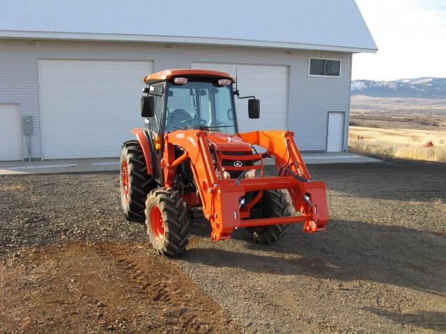

R4's are a tougher tire than R1's. They have more plies and are a bit stiffer, too.
   / Another R1 v. R4 tires question #22
Glad to help, that must be great to not have to deal with snow! I have R1's on my G154, and that only comes in around just under 1 ton, but our other tractor, a JD950 was what I was referring to. We use it primarily in the woods, and we have used it for haying, and plowing at my grandparents house. It weights just below 4000 pounds. I hope that you really enjoy your new tractor, and I'm sure that what ever you end up with, will work great for you!

NHmitch- Thanks for the great tire/wheel article and I have saved this article as a reference piece. Almost all of the other posters have responded that in my circumstances, R4 would be the best. I also have rocky soil like you, but will have no snow to contend with (one reason I moved here from Iowa many years ago) and am expecting the mud situation to be shallow.
I recently had a geo-technical engineer provide a soil analysis that I could provide to my future home builder, primarily to ensure the house will have a proper, long-term foundation in this troubled soil, as DHEC had denied a septic tank permit (as expected) and I will have to build an engineered septic system- basically a mini waste treatment plant. When the geo-tech guy was out there using a hand auger for his tests, in most of the spots of the marked foundation area, he could only get 12" below the surface (I assume due to the rocky soil) and in one spot he was able to get 36" down. And this confirms I do not think mud should be a significant issue for me.
Is your noted experience using the Bolens G154 tractor? Or a larger, heavier unit? My tractor will weigh between 5500 - 6600 pounds.

   / Another R1 v. R4 tires question #24
These are Michelin R1's with R4 casing and strength.
Traction and durability.
#25
Those are nice looking tires and the best of both worlds.
