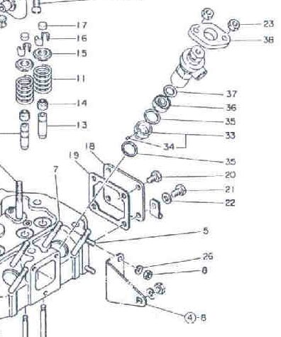

By the way, are there supposed to be any gaskets between the injector and the head. When I removed mine there was not so I put them back the same way.

No gaskets. They are machined to fit.

As for the gaskets, I'm really surprised there aren't any. I've attached a scan of a page of my parts manual for the 1110. Parts numbered 33 and 36 are the pre-combustion chamber. Parts 35 are copper gaskets/washers, and part 37 is a fiber washer/gasket. I thought this was a pretty standard Yanmar design. I think all of the parts manuals I have show the same parts. (And I have parts manuals for YM1110, YM1301, F13, F14/F15, YM1510D, YM1702D).

I was referring to gaskets in the cork or rubber sense. Some injectors have a brass washer that seals on the outside of the head above the threads.
