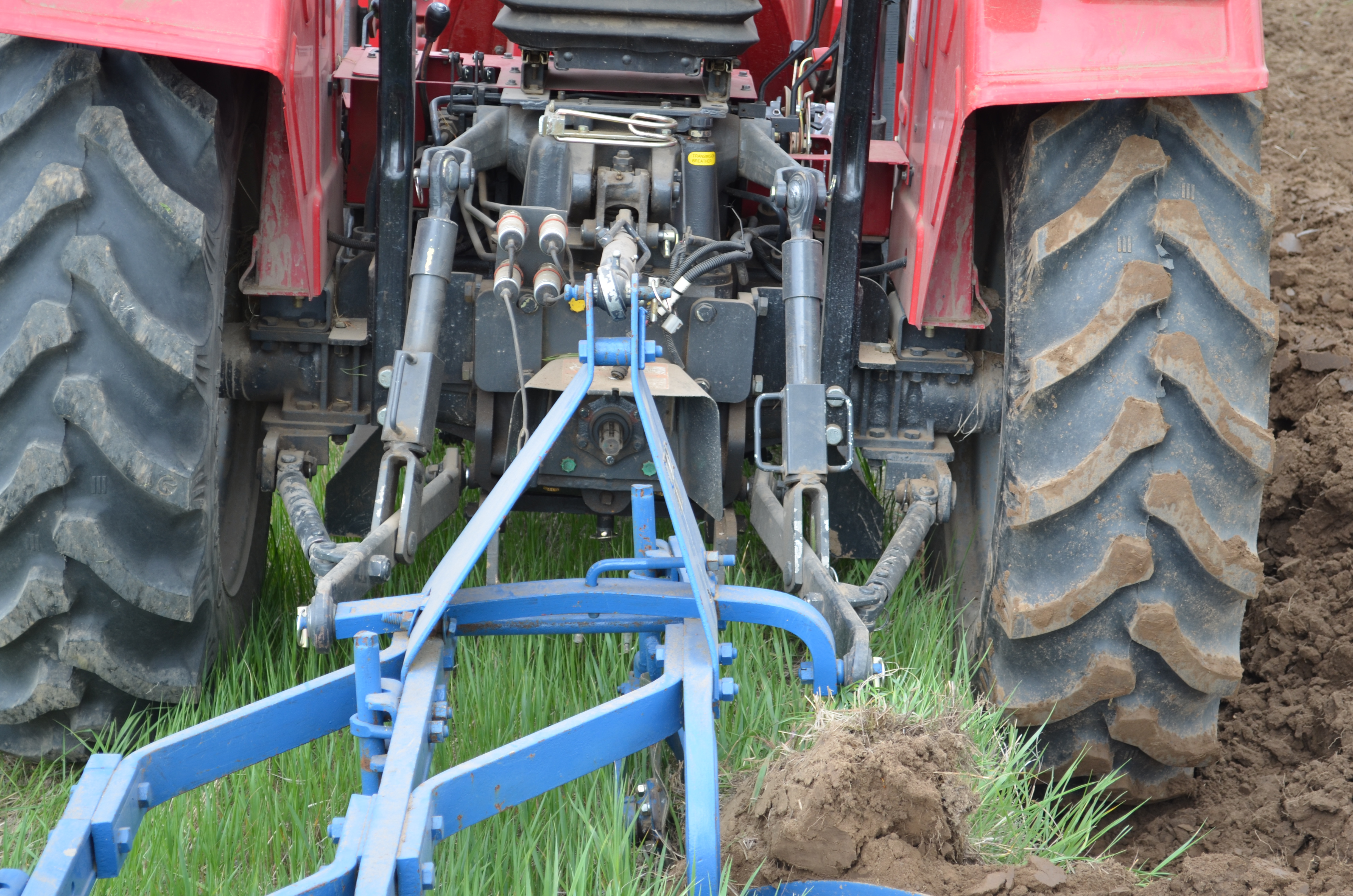

If you look a few pages back at the picture I took sitting on the tractor and looking backwards, does it look like I'm plowing too deep? That was just another idea that I had that may be making it want to pull to the left. I haven't figured out draft control yet so I've just been using position control with the lever all the way down.I figured with the plow setup properly, it should bottom out at where it was set up to, and not suck any further. I may be wrong with that though

Yep, you are wrong with that. Surprised your tractor will pull it with the Position Control lever all the way down??? It should bury itself until you can't pull it.

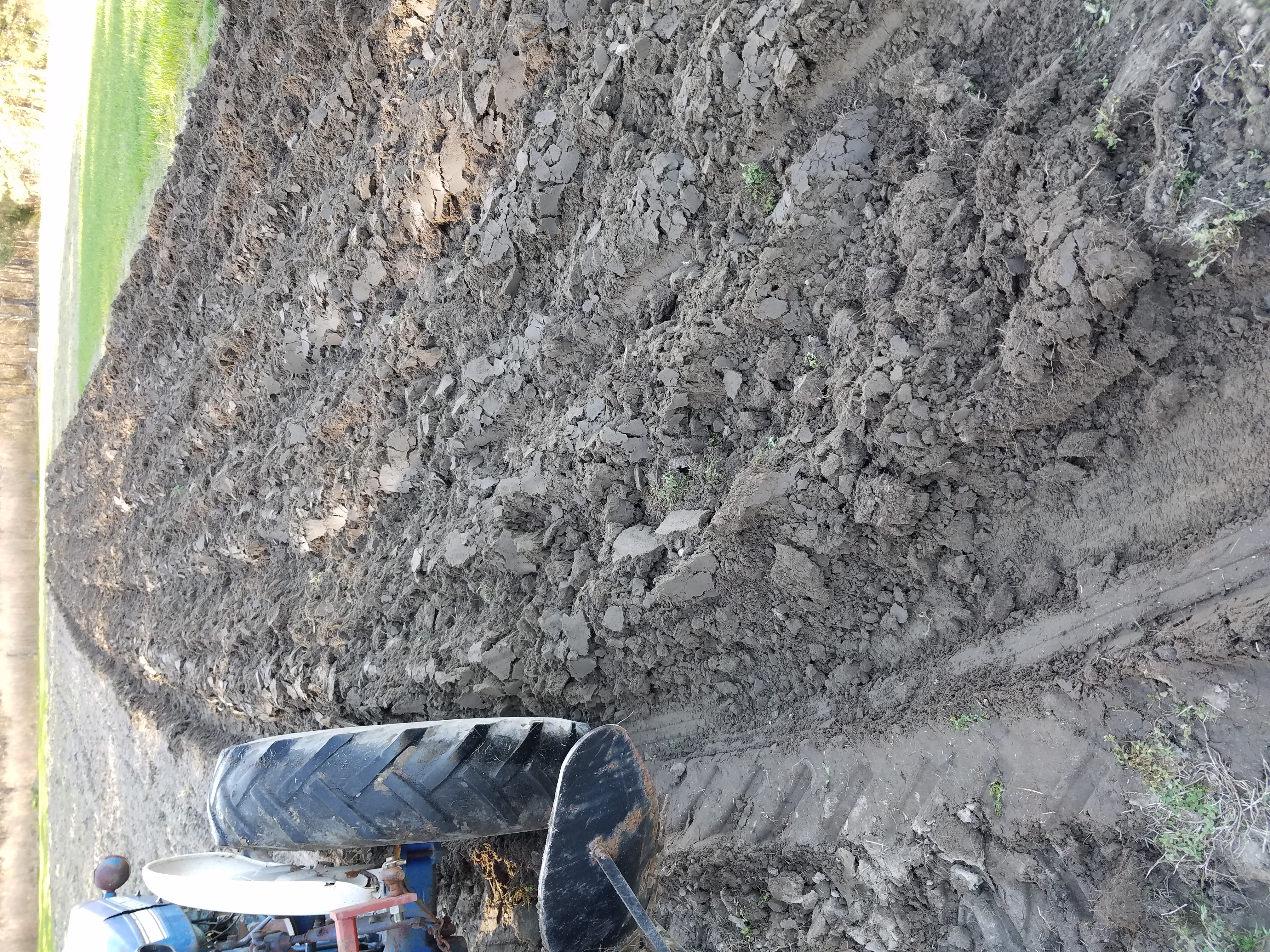

They usually say your depth should be half the moldboard width, so 7" in your case. I don't plow that deep though, unless I have to. many times I'm only turning 5" and it works great without turning under my valuable topsoil. There's no need to turn soil too deep, when all you want to do is get the top side down.
And you definitely have to keep your position control set to hold it at that desired depth.

I didn't measure it at the time, but this is a picture I took the other week of how deep the rear was cutting. Id guess it was around 6 inch or so range from what I recall.
