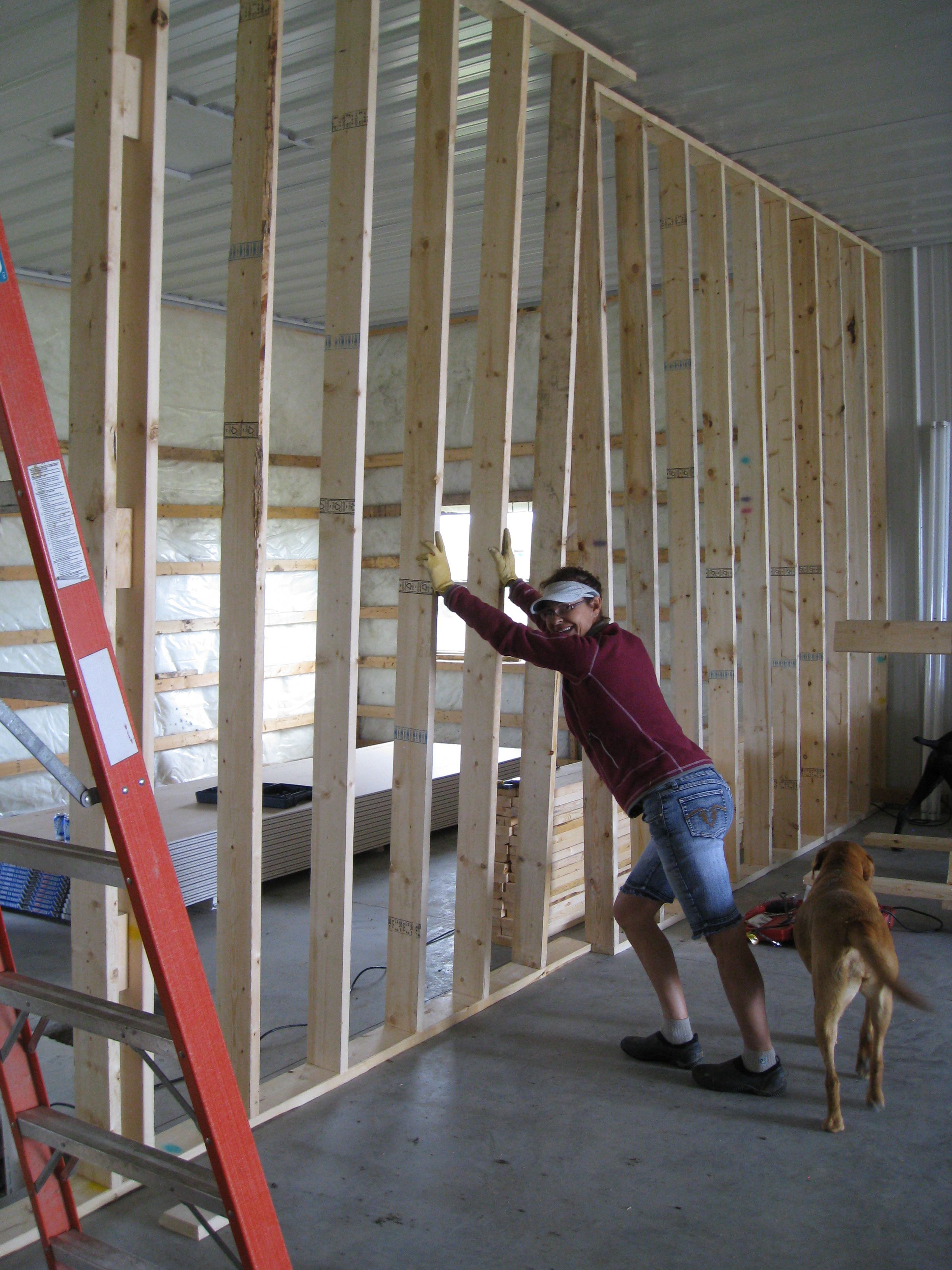

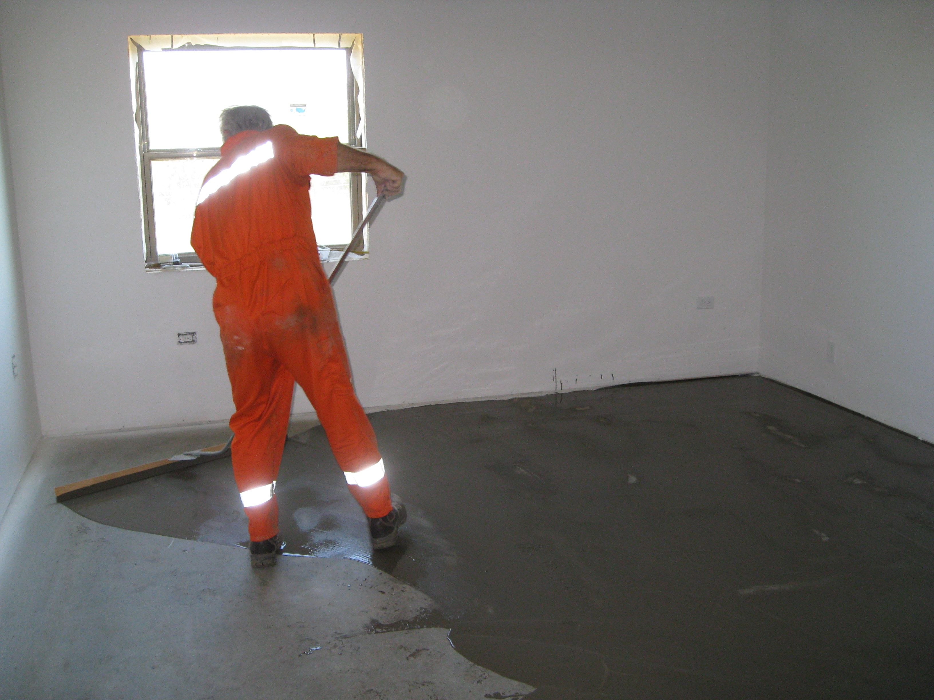

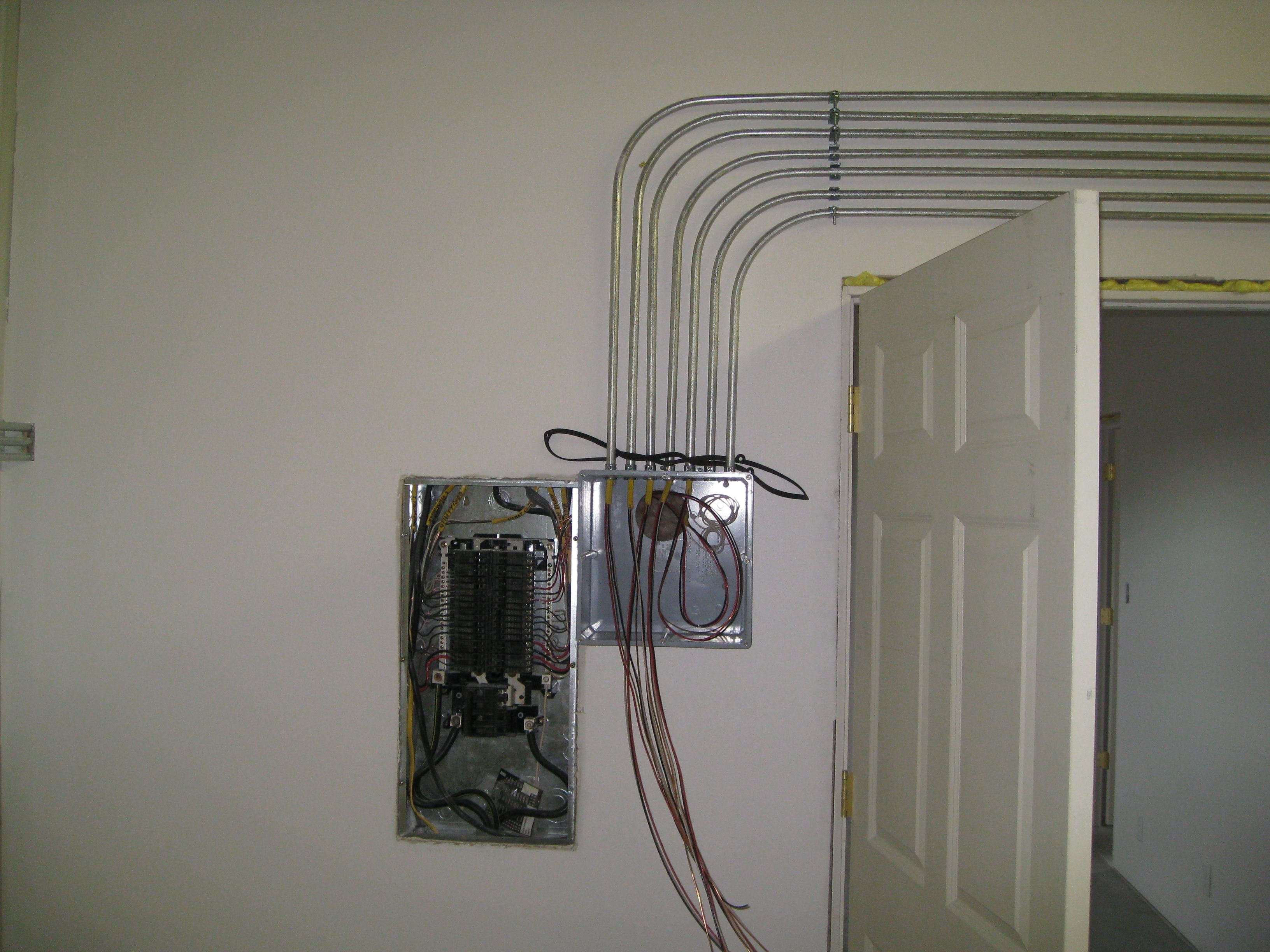

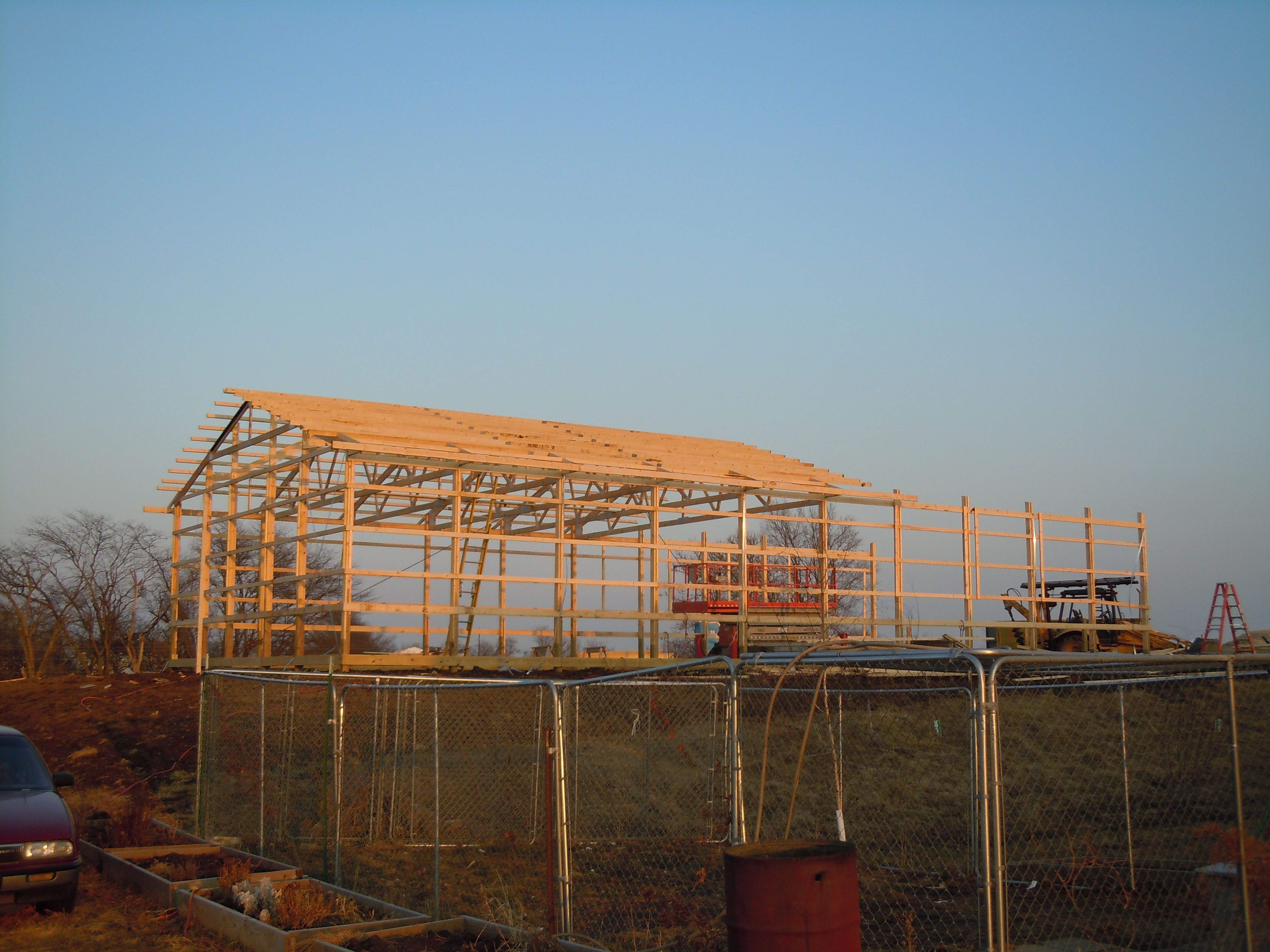

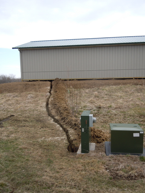

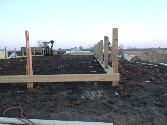

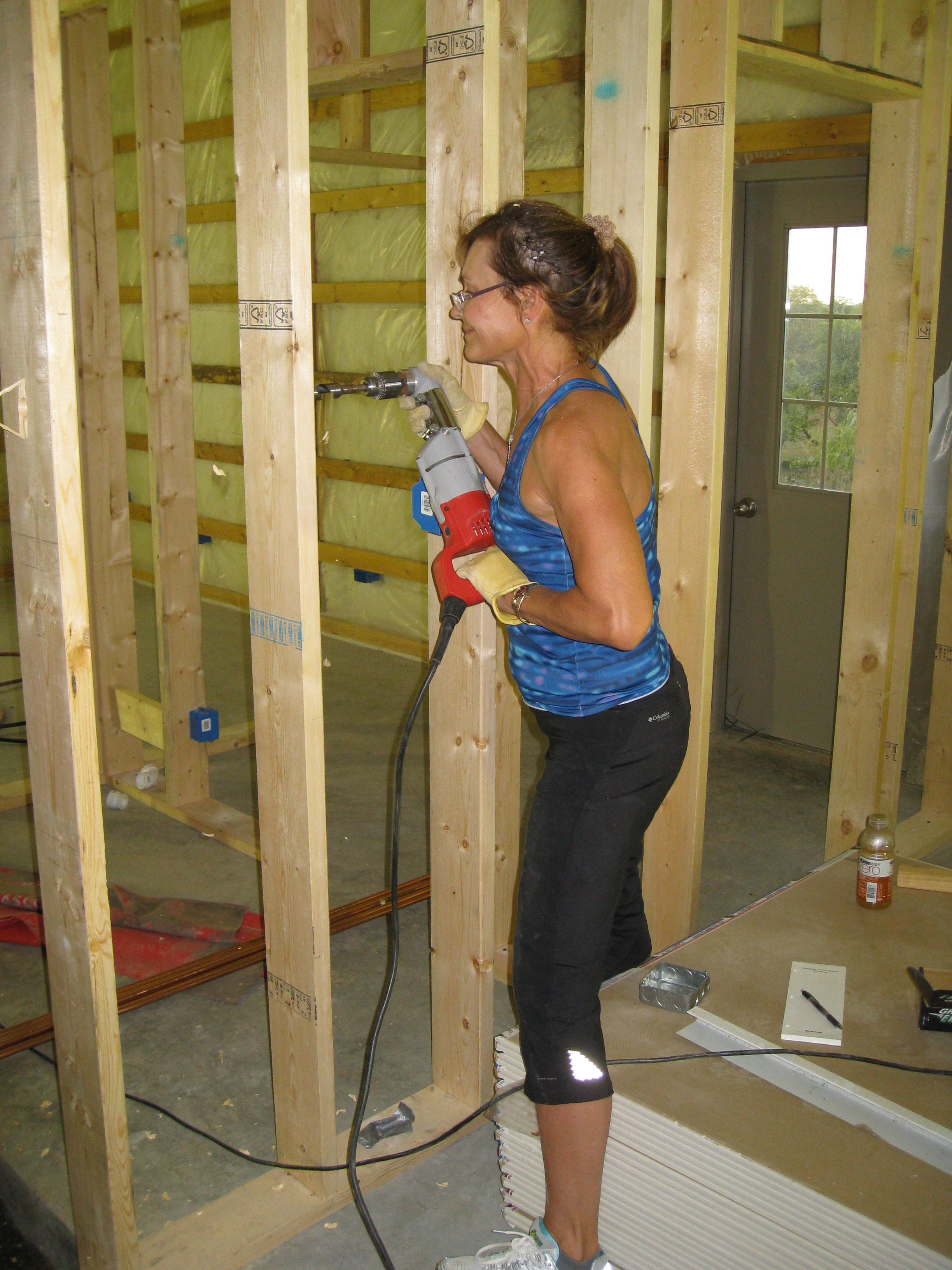

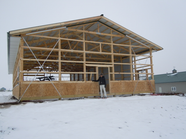

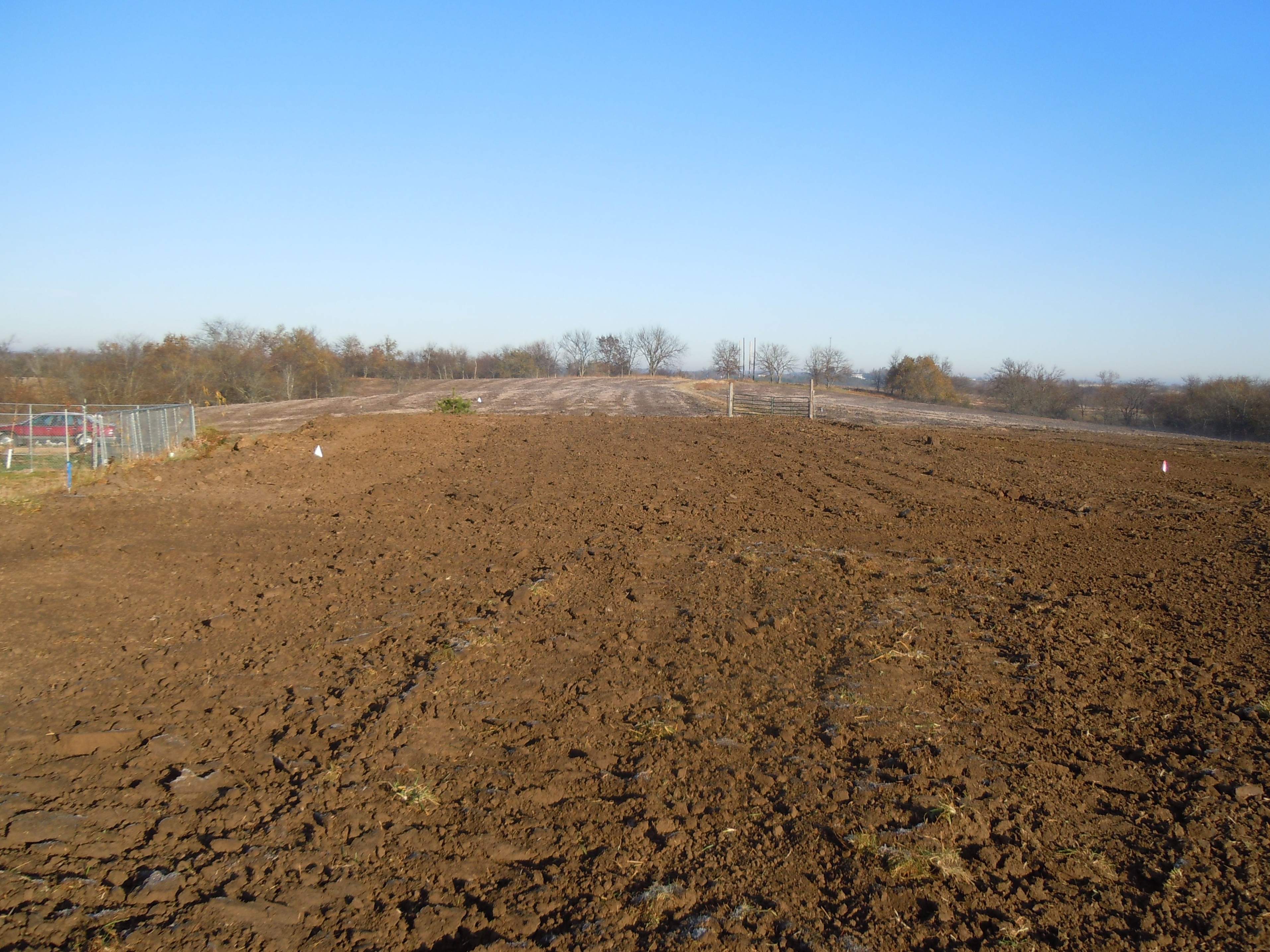

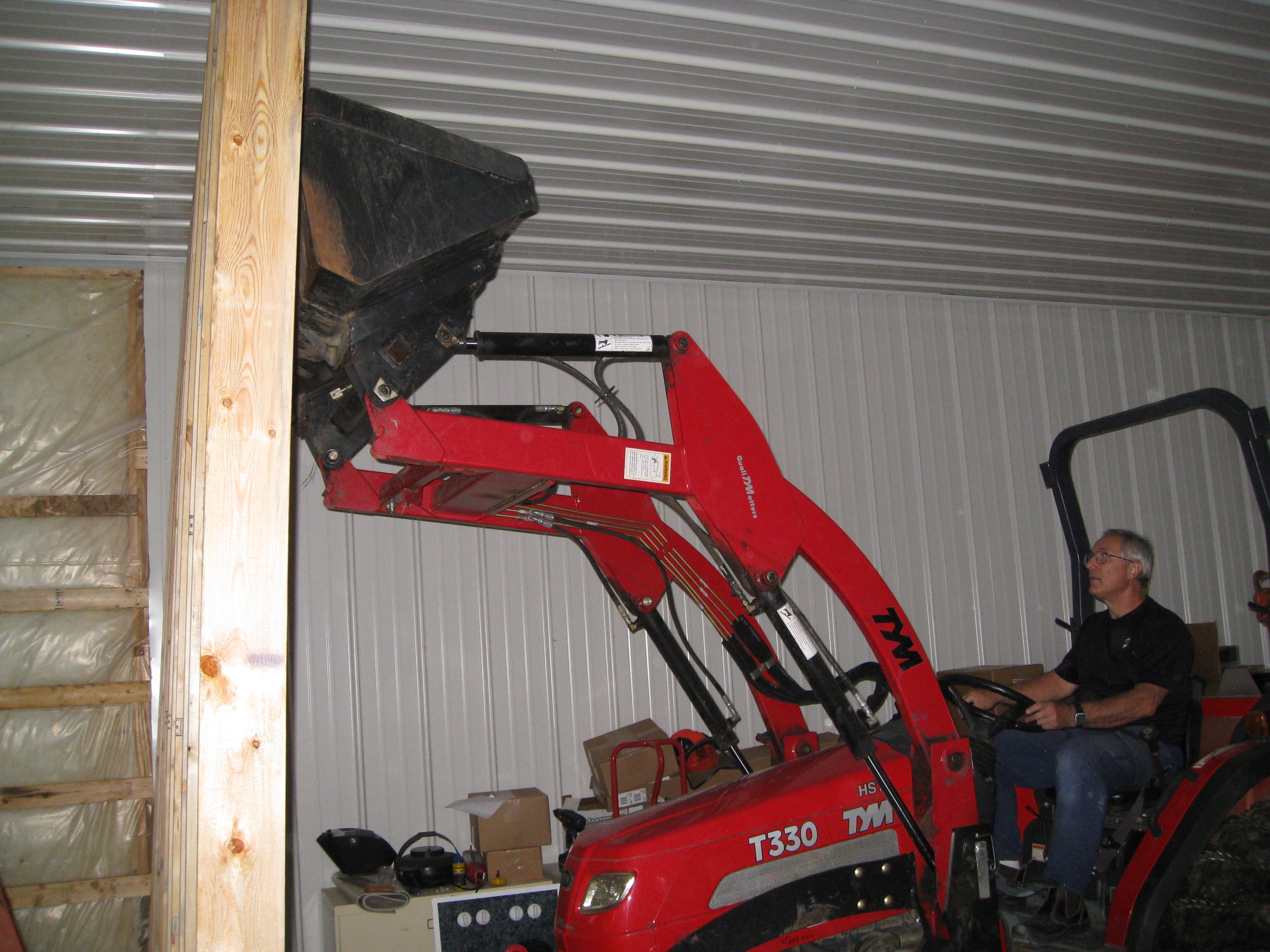

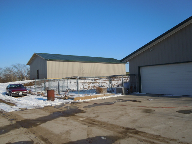

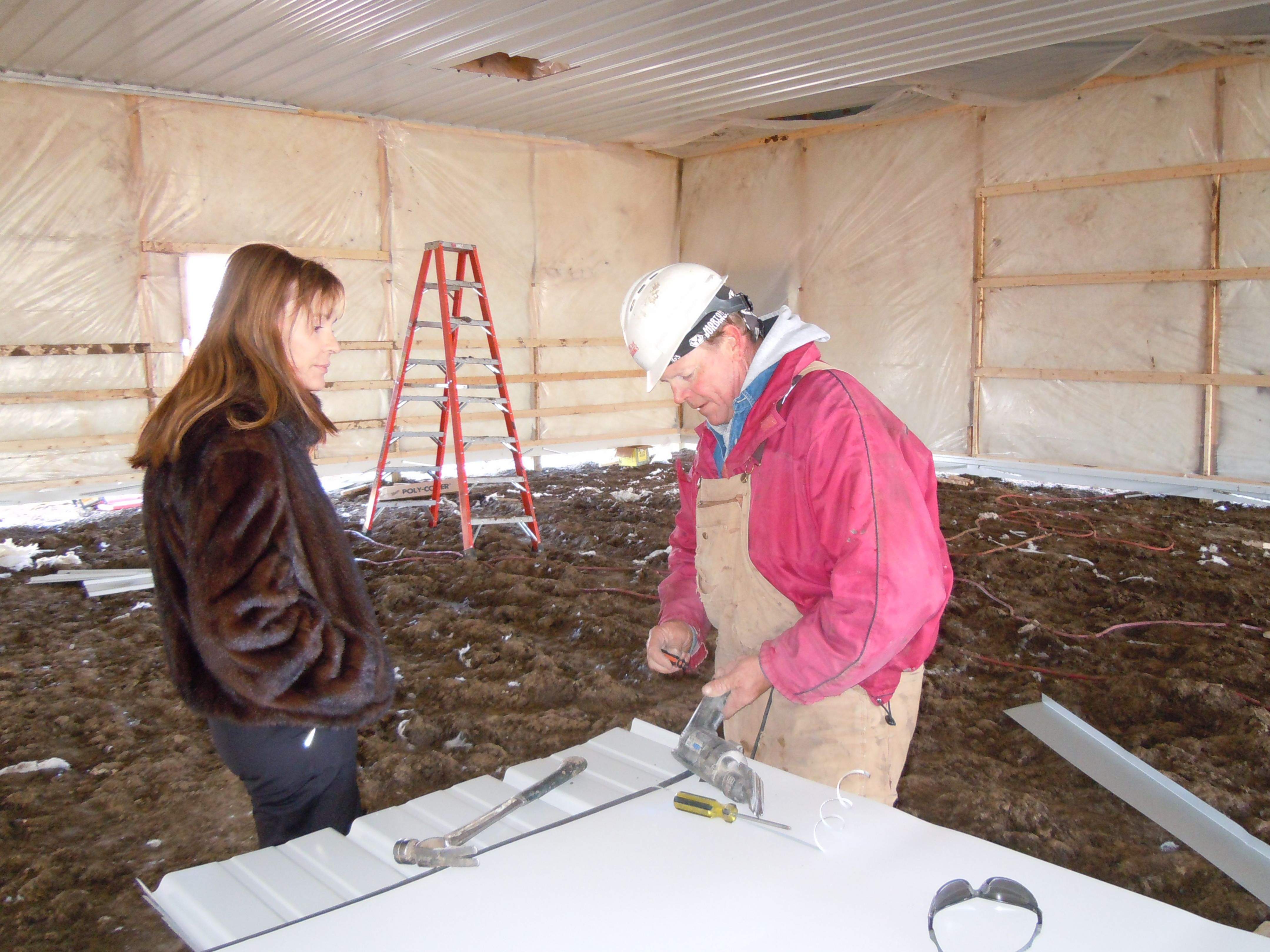

The building is 36 x 75 x 12 built by Morton Buildings. Construction started late November 2010. It is a retirement project but we decided to finish the inside even before I retire some time at the end of the next year. There is a 14 x 16 guest room, office 14 x 11.5 and half bath. Following pictured document what was done so far. The work is still in progress.
#1 shows the site ready for the building.
#2 All "lowers" are in.
#3 Basic structure is finished. Skirt is on. Got early snow.
#4 Basic structure is finished. just before skirt was put on.
#5 Building is insulated and ready for inside metal lining.
#6 Erecting wall framing.
#7 Another view of the wall.
#8 Julie drills holes for the electric wires.
#9 Leveling floor in the future guest room before Shaw engineered floor installation.

#11 200 A cable installed.
#12 Wiring for heating. The box is for electric meter CT for heating.

Looks like you got some good help there.
