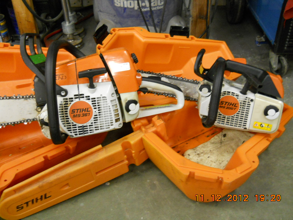

I had a Farm Boss for about 10 years and 3 years ago sold it to my brother and bought a MS361 with the suspension system.
What a difference in power plus "no vibration".
the saw is sooooo smooth while running.
I have a MS200T for bucking because it is a one-handed saw great for clearing brush.
I figured my wife would like to runthat - but- she wants to run the MS361 all the time.
she is 5 foot 100 lbs and can run the 361 all day.
a step up to the professional line for me was worth the money.

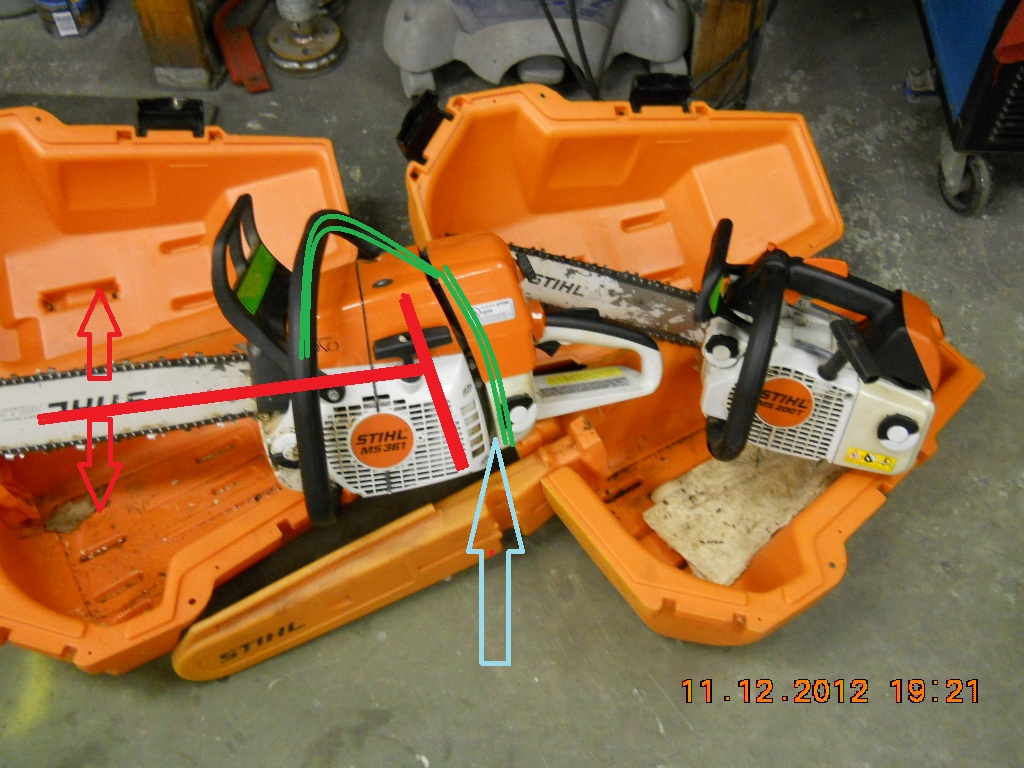

I don't think (not posative) all the professional grade saws have the suspension sysytem.
you can identify it on my saw just by looking at it.
the picture shows the 2 sections of the saw.
the red lines are the bar and motor front half that has lots of vibration.
the green line is the rear half of the saw which is vibration free while the front half is chopping away.
the blue line shows where the saw is split.
if you see no gap it is not a full suspenion saw.
some saw companies use rubber mounts... they are not the same.
when you start my saw and hold the back half on the concrete - the front half bounces all over the place with each fire of the piston.
when cutting in wood the rear half is free of vibration.
look for a gap in the model you want to purchase or look up stihl manuals on line for pictures.
