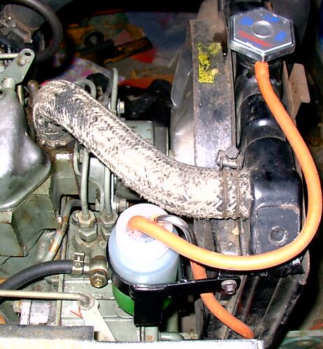

As previously posted, I have just purchased a 1300d and noticed when I shake the front loader a little anti-freeze comes out the tube to the ground. Is there an overflow bottle available for this unit or is the anti-freeze supposed to run to the ground instead. Not that this is a major deal but eventually I guess I will have to add some at some point if there is no bottle made for this unit.
As always, Any input is appreciated.
Samisam

There are overflow bottles available for everything at auto parts stores.
   / Another New Guy Question-Radiator bottle? #3
Shaking / using the loader, or any other activity, won't cause the Coolant to come out from the
"Overflow" tube. A Radiator cap that is weak,not holding enough pressure, not fully tighted, or too
short, will however cause this leakage. A "Overheated" engine will also. An Overflow jug can be added,
but it's really just for convienence. As long as you keep coolant in the jug, most people never open the
radiator to check the level. Without the Overflow jug, the Manuals say to check the coolant level, and
all the other Fluid levels, daily, before useage. This is from the 155d books, as well as other operator
manuals I have seen.

I have a YM1110D which didn't have an overflow bottle. Like your 1300D, it also doesn't have a water pump. So I made an overflow bottle using a small bottle, some tubing, and hose. I also made a bracket to mount it under the hood. And believe me, there isn't alot of space under there. If you do this, you must replace the radiator cap with one designed for an overflow system - they are different. Also make sure to get one with the same pressure rating (should be 13psi).
I attached a photo of my overflow system.
   / Another New Guy Question-Radiator bottle? #5
I got a 9$ universal kit from car quest for my 1700.. hung right above battery.. worked great.. never have problems with it..
Do check your radiator cap though.. this should be a recovery system.. sounds like your cap is not seating..
