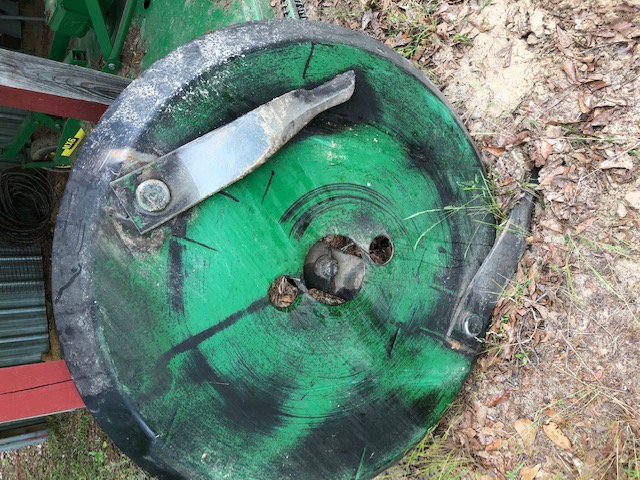

View attachment 611822View attachment 611823View attachment 611824View attachment 611821
So you guys really haven't found a box that will just mount back up on the JDMX6 cutter? I have the same issue, cutter has less than 100 hours easily. I priced JD and that's not going to happen and I found the same gearboxes at the Green Part Store for the exact gear box for 891.00 and a new version of that gear box for 891.00. My issue is I dont want to put this kind of money in something that I don't even know if the casting problem was fixed. I did find the shaft kit on ebay and that vendor told me he had sold over 1000 of these kits to fix the MX models. JD has not responded to me at all on this matter but you would think they would want to at least admit there is a problem. I will most likely buy a USED bush hog that looks like it want last because those usually last forever.
From your pictures, I see you have the made in China gear box. I thought only the made in Spain gear boxes were the problem MX mowers. Now I know there are not any "immune" from failure MX mowers.
   / Another MX6 Brush Hog Failure #165
The unit I have actually has a key in the shaft that bolts on the stump jumper. I contacted JD on 7/6/19 1-800-537-8233- I have contacted my local dealers and they have not offered any help. If others could contact JD that would be a great help.
Wow ! Looking at one of your images it looks like you have a NUT on the shaft with a cotter key !? That is a whole different ballgame. Mine was probably an earlier unit but in any case had a bolt with no keeper or cotter key or anything to hold it there other than torque/tightness. Maybe a lock washer, I can't remember. Anyway a secured nut versus a bolt would be a significant difference. Probably also blows my theory of the stump jumper flying off and causing the shaft breakage.
   / Another MX6 Brush Hog Failure #166
How can you tell?

Post #158, picture 3, the tag says "Made in China". The made in Spain gear boxes have "Spain" cast on the gear box.
