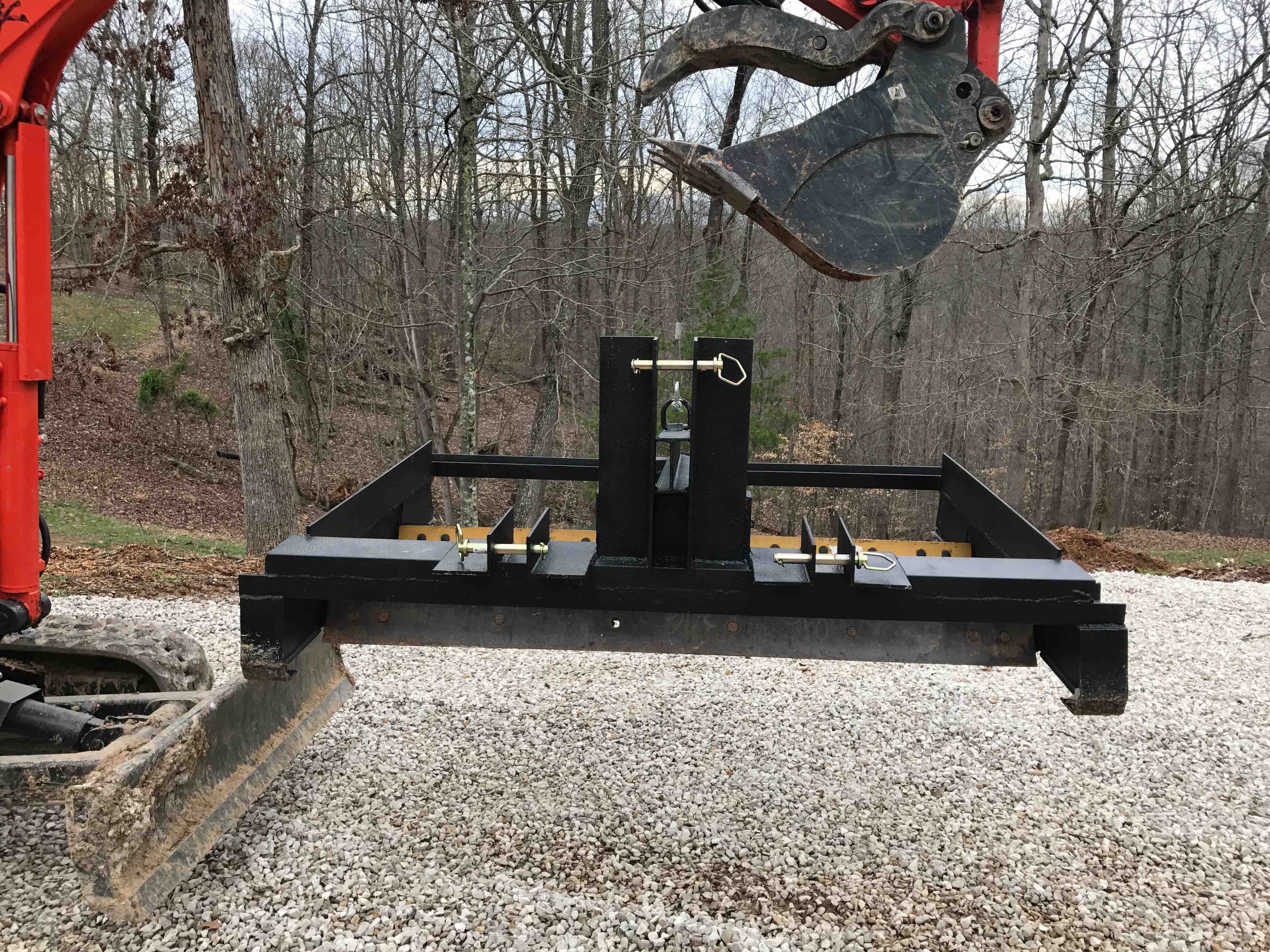

A while back I asked for some advice and information on building a land plane. I finally got it all wrapped up and together.
It is a 6' wide model
Little over 5'5" long

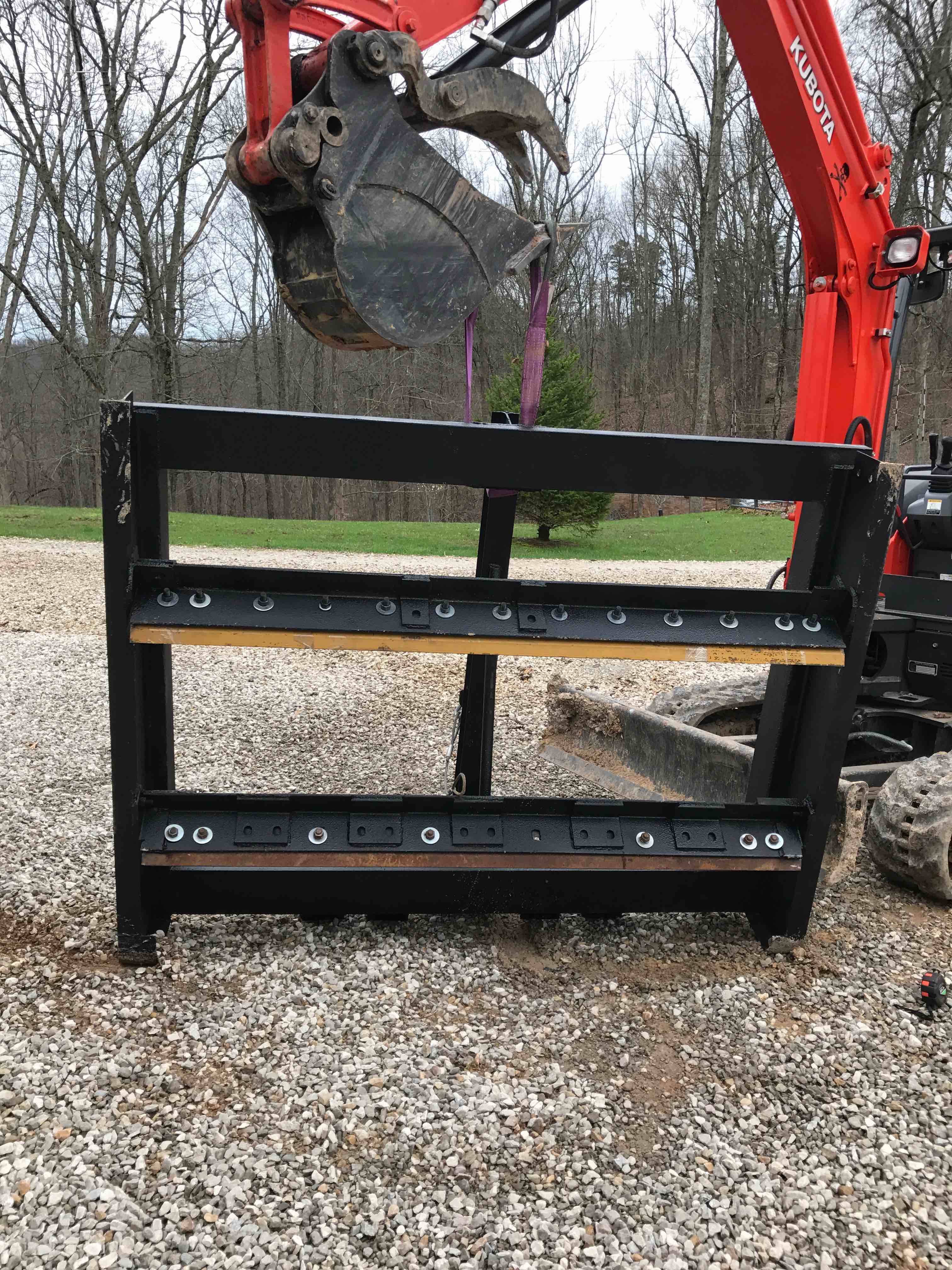

Duel straight blades - have about an 1 1/2" of up and down adjustment.

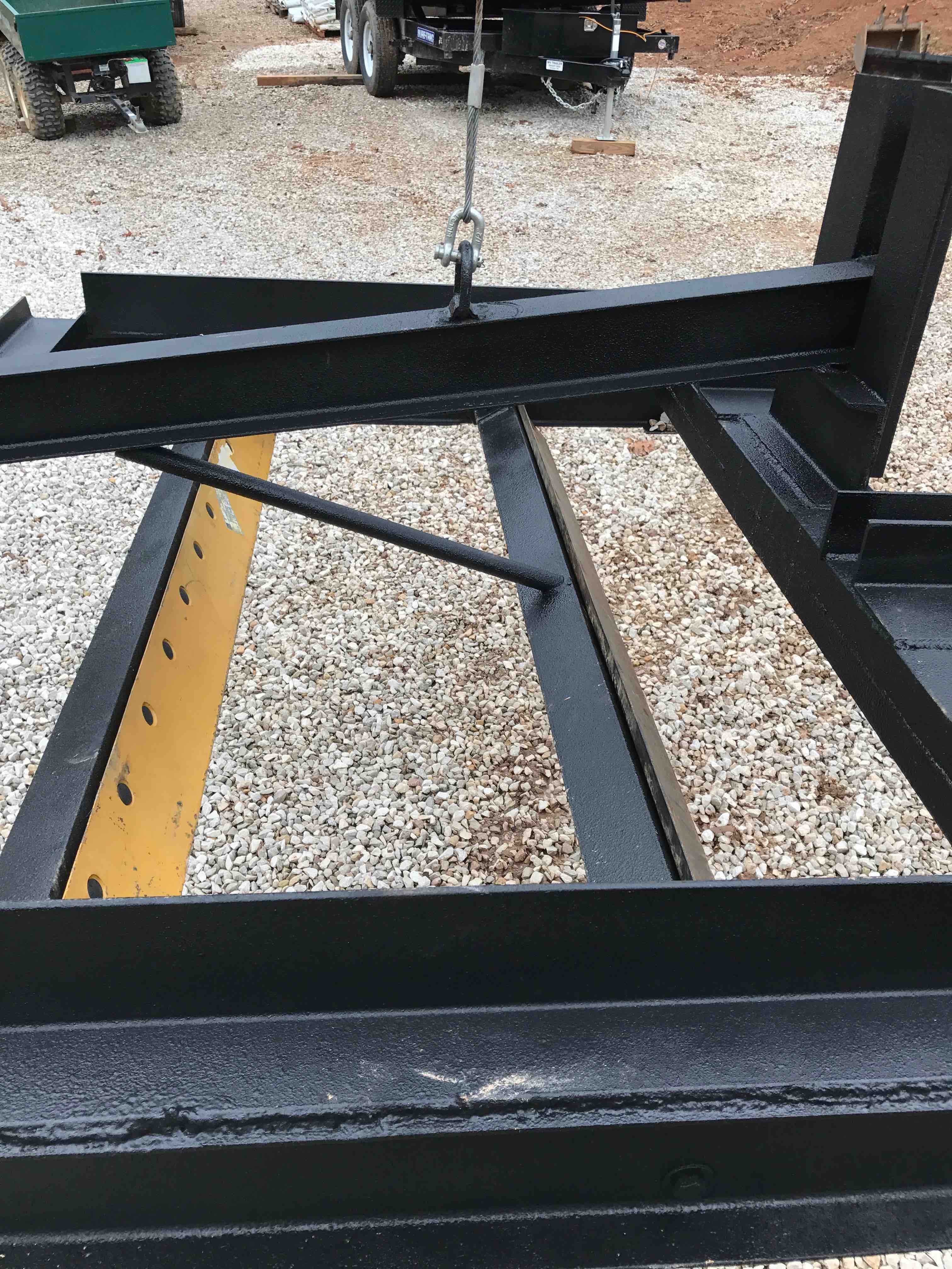

used 5/16 5"x3" angle as the backer for the 1/2' thick blades. Reinforced the angle with some 1/4 angle just in case
used a 1" solid rod to run from the front blade to the front/rear support for additional bracing (Figure it would be taking most the stress)
The side are "I" beams (bottom inside of the "I" removed to make a better skid
On top of the "I" beam there is more of the 5/16 angle to add some extra height
My front to rear brace is a smaller I beam I had laying around
The main cross members are 6" wide 1/4" thick "C" channel
Whole thing is coated with a thick coat of Raptor black bed liner
I am not sure what it weights but it is darn heavy. May take the time to calculate it one of these days when it is raining out.
The majority of it was made with stuff we had laying around but I did have to get a few things and the blade.
Cant wait until it is dry enough around here to use it!

Looks good. I was looking at land planes today and was thinking of making something after pricing a few. I need one to do two yards and that is it... hate to shell over $1,000 for minimal usage.
Yours gives me inspiration to go for it. Hope it works as good as it looks.

Looks good 54. That should work well for you. I know you will like it !!
Your height adjustment is slotted holes for the cutting edges ?? Simple enough. Good idea.

Yep - The blade adjustment is just slots in the backing plate. Figured it would allow for wear (not that I think I will really wear it down but just in case)
I would think the down pressure would make it cut a lot quicker. I figured by using the C channel I would be able to add more weight if needed but look forward too seeing how if does as is. I have a box blade that I plan on using to move material in bulk then putting the land plane on for the final "grade" and clean up work. I am working on building a new and improved shooting range so when we get some dry weather I will give this theory a test run. Our driveway/lane is pretty darn good but figure the land plane will be good to run on it now and then to dress it up a bit and repair minor issues.
