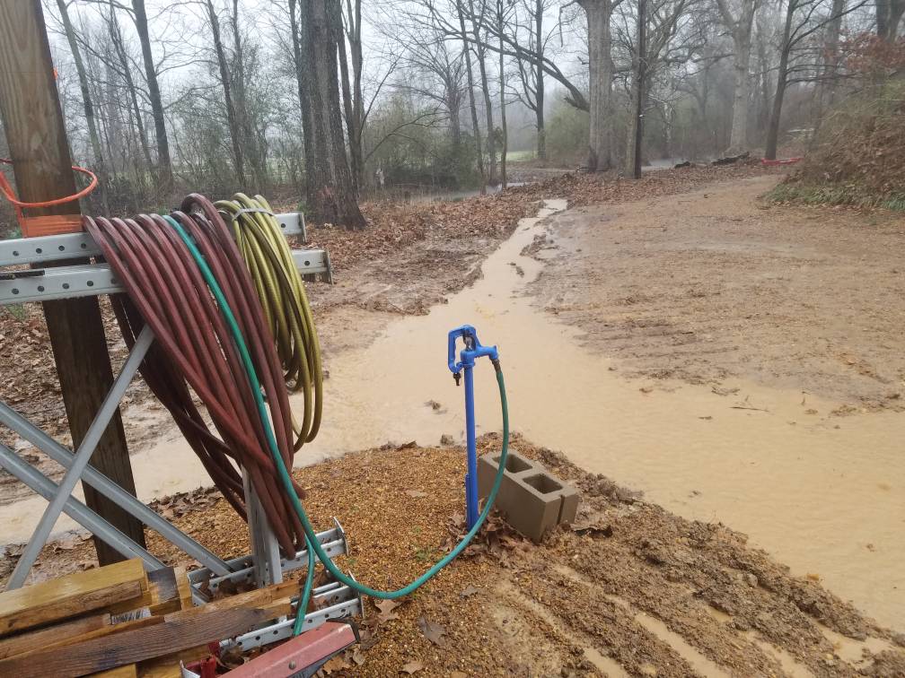

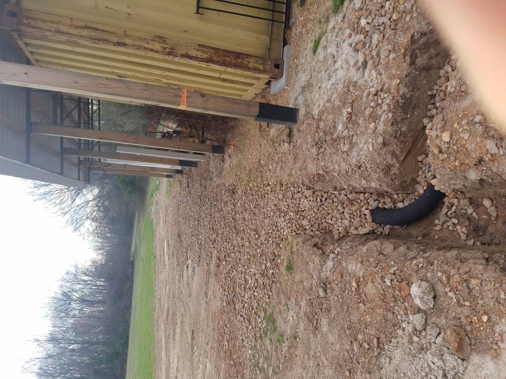

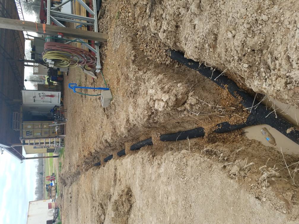

1" of hard rain would get in my shed before drain, last pic is after 6" in 12 hrs. EVERYTHING flooded except my shed!20180307_171042.jpeg20180307_170947.jpeg20180221_085637.jpeg
