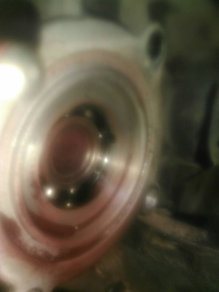

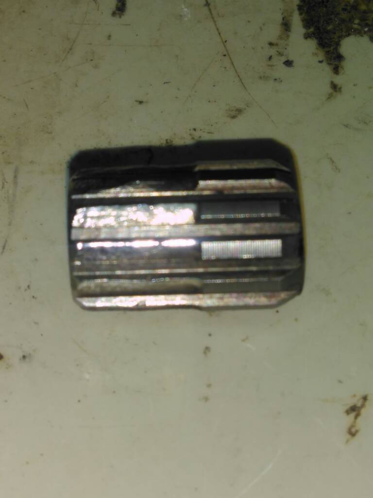

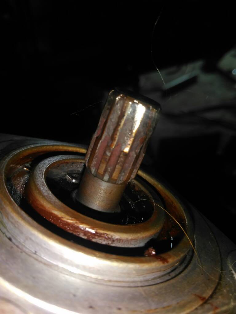

Removed pump and the shaft is worn and also the inside gears. I'm guessing the pump frozen, but I'm not sure why there appears to be rust in the inside gear. IMG_20190416_143440.jpeg1555444223795.jpeg
   / Another HST Transmission Problem #8
Water in there somehow? How did that happen?
#9
Looks like rust, it dry inside and powdery where the shaft goes into the housing and I can remove it. The bearing has some bad spots which probably caused the failure. Not sure if it's a dry fit or lubricated. My biggest question yet to be answered is whether the inside grooves are gone. Going to check with local companies for scarp shaft to check.
What I thought was a bearing looks more like oil seal on the shaft. The more I play with it there's has to be wear in the housing for the shaft. When I first tried turning it after removing it I found it was hard to turn.
