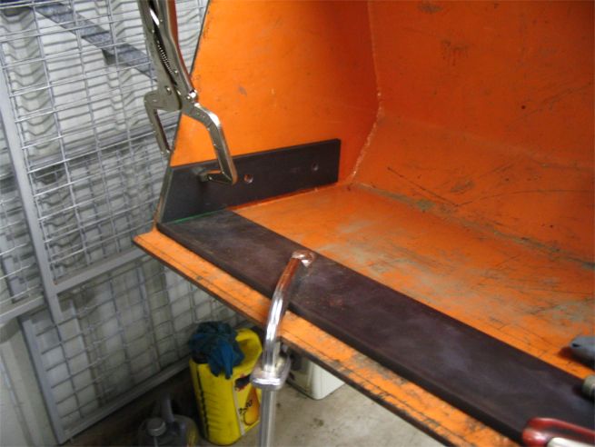

Mar 30, 2006 / Another homemade toothbar #1 J JohnF_ASI Member Joined Mar 22, 2006 Messages 38 Location QLD, Australia Tractor Kubota L1501DT Here's my version of a relatively simple toothbar for my 1200mm (4 foot) bucket. I started by getting the main support and side bars in place so I could measure the total thickness for the teeth.. Attachments 855305-flat bars in bucket_1.jpg 47.6 KB · Views: 2,907

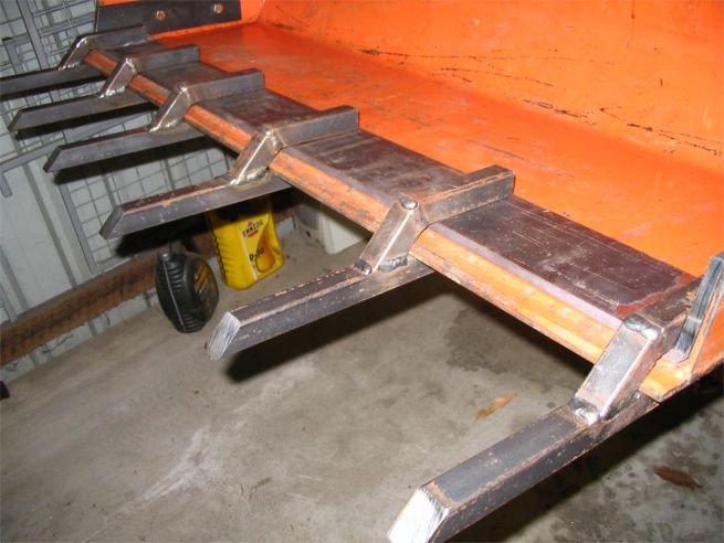

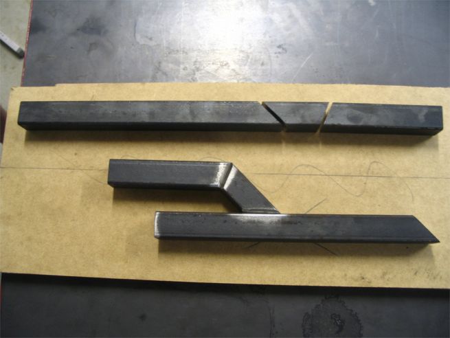

Mar 30, 2006 / Another homemade toothbar Thread Starter #2 OP J JohnF_ASI Member Joined Mar 22, 2006 Messages 38 Location QLD, Australia Tractor Kubota L1501DT That allowed me to start cutting the teeth from 25mm (1") solid bar. I did this with only 2 cuts using a drop saw - 1 at 45 degrees and 1 at 22.5 degrees (which gives the 45 degree slope when they're turned around).. Attachments 855307-first cuts_2.jpg 38 KB · Views: 2,593

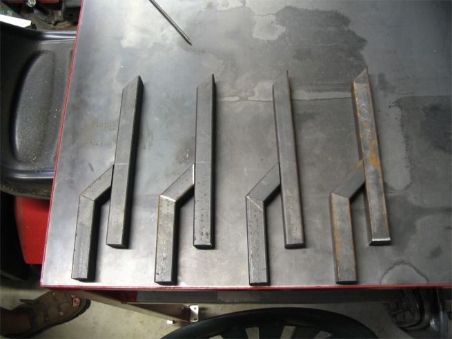

Mar 30, 2006 / Another homemade toothbar Thread Starter #3 OP J JohnF_ASI Member Joined Mar 22, 2006 Messages 38 Location QLD, Australia Tractor Kubota L1501DT Then into 'production mode'.. Attachments 855311-production_3.jpg 43.2 KB · Views: 2,175
Mar 30, 2006 / Another homemade toothbar Thread Starter #4 OP J JohnF_ASI Member Joined Mar 22, 2006 Messages 38 Location QLD, Australia Tractor Kubota L1501DT Test fit up before welding..
Mar 30, 2006 / Another homemade toothbar Thread Starter #5 OP J JohnF_ASI Member Joined Mar 22, 2006 Messages 38 Location QLD, Australia Tractor Kubota L1501DT Oops! Clicking too fast before attaching pic.. Attachments 855318-test fitting_4.jpg 52.6 KB · Views: 2,037

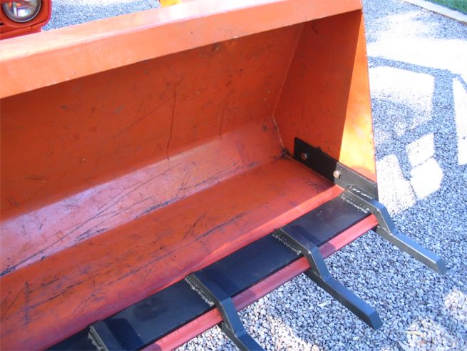

Mar 30, 2006 / Another homemade toothbar Thread Starter #6 OP J JohnF_ASI Member Joined Mar 22, 2006 Messages 38 Location QLD, Australia Tractor Kubota L1501DT Welded and painted.. Attachments 855320-finished_5.jpg 75.8 KB · Views: 2,100

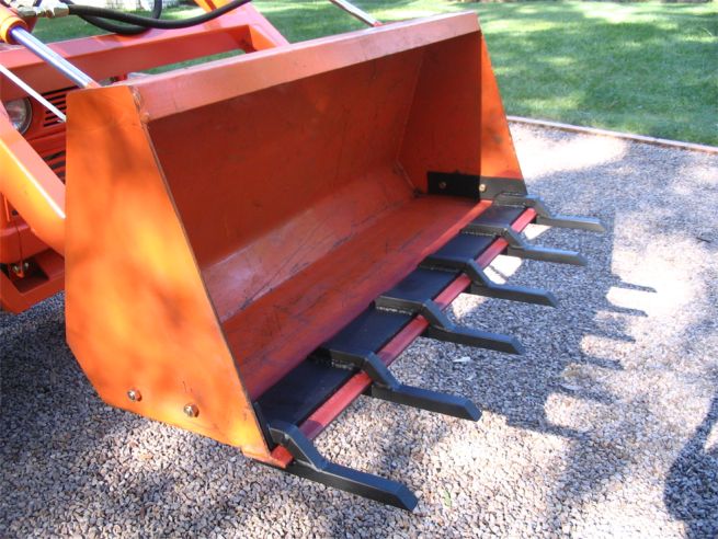

Mar 30, 2006 / Another homemade toothbar Thread Starter #7 OP J JohnF_ASI Member Joined Mar 22, 2006 Messages 38 Location QLD, Australia Tractor Kubota L1501DT Closer view.. Attachments 855321-finished_6.jpg 61.7 KB · Views: 1,656

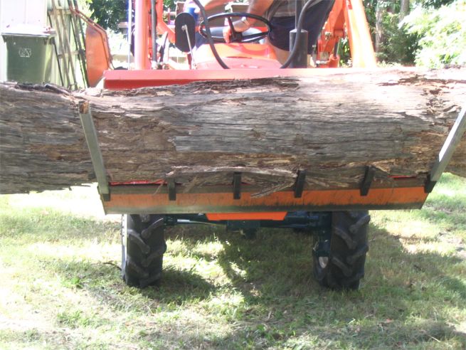

Mar 30, 2006 / Another homemade toothbar Thread Starter #8 OP J JohnF_ASI Member Joined Mar 22, 2006 Messages 38 Location QLD, Australia Tractor Kubota L1501DT Slipped a couple of lengths of 30mm x 2mm SHS onto the 2 outside teeth and gave it a test.. Attachments 855324-pick up log_7.jpg 94.8 KB · Views: 1,771

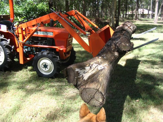

Mar 30, 2006 / Another homemade toothbar Thread Starter #9 OP J JohnF_ASI Member Joined Mar 22, 2006 Messages 38 Location QLD, Australia Tractor Kubota L1501DT Front view.. Couldn't have done this before. Now I plan to make a set of 4 square tubes to slip onto the inside teeth so it can also be used as brush forks.. Attachments 855327-front view with log_8.jpg 75.4 KB · Views: 1,864
