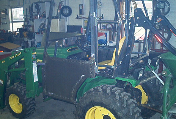

/ Another Home Made Cab Post
#27
windshield in...
#28
doors on...
inside shot of door handle and linkage asmbly.

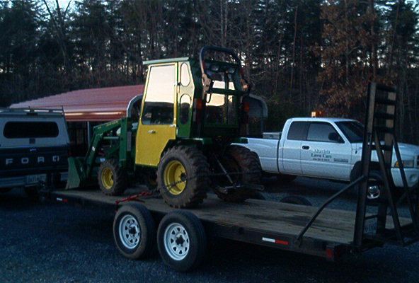

#31
Loaded up..ready to go to work.
#32
Only thing left is mounting heater, and fans, wiring up wiper, and installing light bar.
/ Another Home Made Cab Post #33
How much did it cost all together to build a good looking cab like that???
/ Another Home Made Cab Post #34
Hi, that is a great looking cab it is the same type I want to build for my kubota b7510 .Where did you get the rubber to mount your windows? And are the windows made from 1/4" lexan? THANKS,BULL
#35
I'm estimating materials were around $700.00 . I wasted some money by getting the wrong size sheet metal (was able to use it for other projects). And Do Not order weather stripping until you're finished, so you'll know what type u really need.
All the windows are lexan, except the windshield is a rear school bus glass..also where the heater came from.
The wiper (el cheapo, but works) and all weather stripping came from JC Whitney co. I used a lot of seam sealer..it actually glues in all the plexiglass, and I used automotive Urethane (made for car windshields) to "glue" in the windshield.
I just used it for snow removale...wasn't even like work. Even without the heater installed, the interior stays nice and warm, and glass fogging is minimal.
