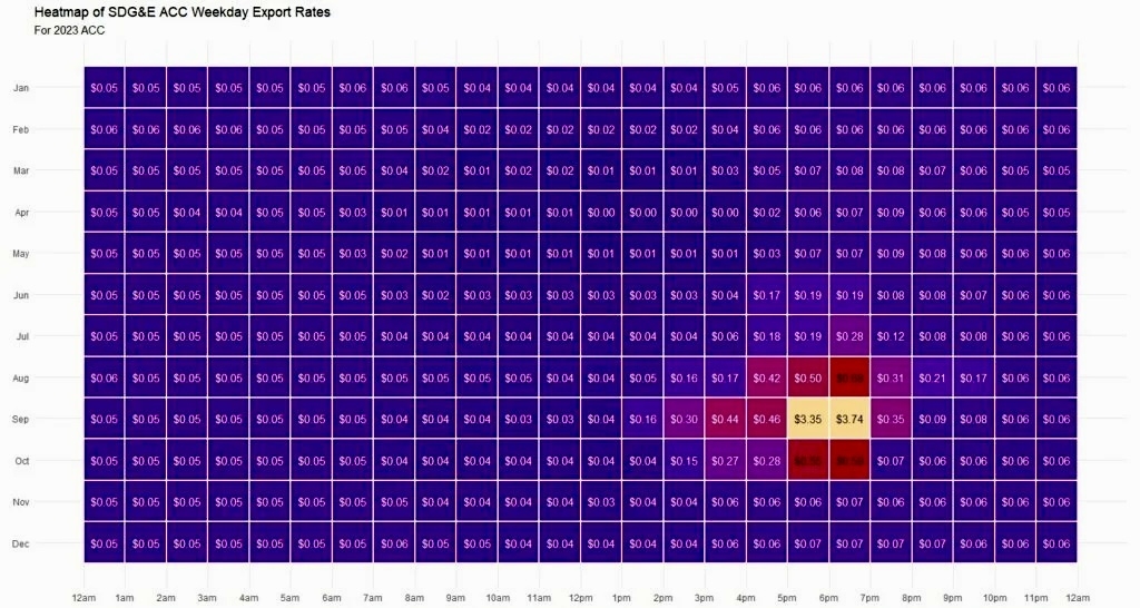

Here is an example of hour by hour power costs arranged by month for San Diego.
In a similar way, even if a consumer only draws on the grid in mid-winter or late August, the transmission wires, transformers, generation plants, and related grid infrastructure have to be kept in working shape, year round.
So, I don't know what the "right" monthly charge is, but if the per kWh charges are converted to a per kWh generation cost, and a per month grid connection cost, that connection cost might well be $70-200/mo, in part because large consumers (businesses, and wealthy homeowners with large per month consumption) effectively subsidize small consumers.
I assume rates are related to load. What happened in the early evenings August through October (then getting better in November/December)?
The mid day rates plummeting may well be related to the success of a residential solar program. Are they also encouraging solar hot water? Anyway, blow up the residential solar, and that mid day benefit may go away.
There may be benefits of a distributed power generation. So get one's power from a few blocks away rather than dozens of miles away. Yet, I also understand your point that one has to consider peak load on cold cloudy windless days.
We just went through a week long power outage. It is time for me to start thinking about a power backup system. However, it also makes one wonder about homes with natural gas or propane heat (and adequate power to power the fans and thermostats).
I see your point of high energy users "subsidizing" low energy users. However, nearly half of my power bills are from the service connect fees. So, effectively I'm paying double the energy rates of some most of my neighbors. It seems to me to be a rather regressive system.

In the chart above, the peak is post solar (smaller power supply, higher demand, with less cheap solar power available) and occurs when the local climate is at its hottest and the times when folks are returning home to overheated homes, cranking up the AC. Solutions? Well white roofs would be a start, followed by more home insulation, and better solar overhangs to keep direct sunlight out during the heat, followed by smarter thermostat control to precool the homes when power is cheap, or more batteries (local and otherwise) to store the cheap, plentiful solar and feed it back at peak demand. (Or add thermal energy storage devices like the "Ice Bear" from Ice Energy.) Oh, and of course, better energy efficiency. Things like EVs can help by putting charging loads overnight or during peak solar.
The flatter, and more predictable the demand curve, the easier it is to guarantee the power.
