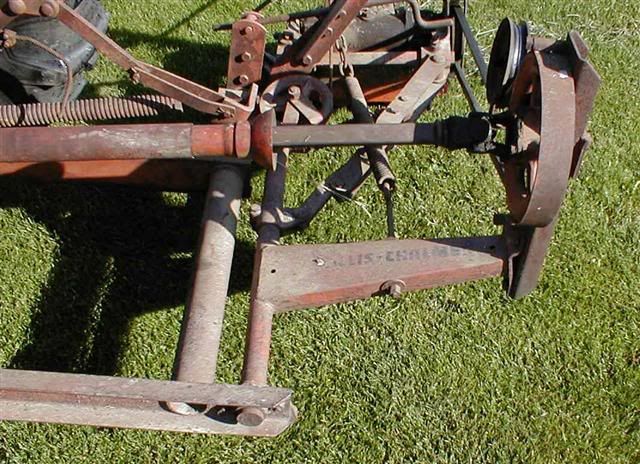

Hey Flusher! If you could, post a picture of the other side and a rear view of the mower. I found a little bit of information on a Massey Harris mower and they look strikingly like yours.
/ Another hay question #25

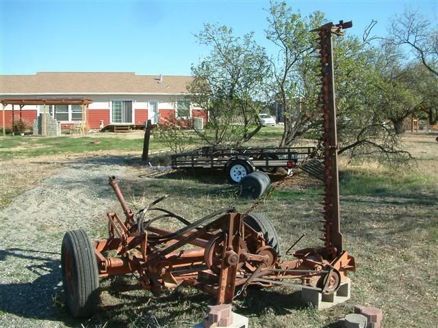

FWJ: OK, here they are.
/ Another hay question #26
Well, It ISN'T the model of Massey Harris I thought it might be. The longer I look at it, the more familiar it keeps looking. I'll look through a few parts catalogs to see if the gaurds look like a certain brand.

FWJ: The drive housing has the words "Twin Wheel Drive" on the casting.

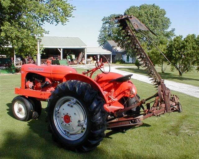

I googled and found this website, a little gem with a wealth of info on old iron:
Allis Chalmers snap coupler sickle mower for sale
My sicklebar mower is, I think, an Allis Chalmers 80T, the trailer version of the 3pt hitch model 80R3 shown on Chat's Tractors website.

FWJ:
If you compare the photos of the AC 80R3 mower on Chat's Tractors website with the photos I posted earlier in this thread, you can see that some modifications were made to my mower by a previous owner. Looks like two braces and a gusset were welded onto the rear support bracket carrying the big pulley. Probably a good idea to include this added support on that bracket.
Also a piece of pipe was welded onto the frame to provide storage for the restraint chain when it's not in use.

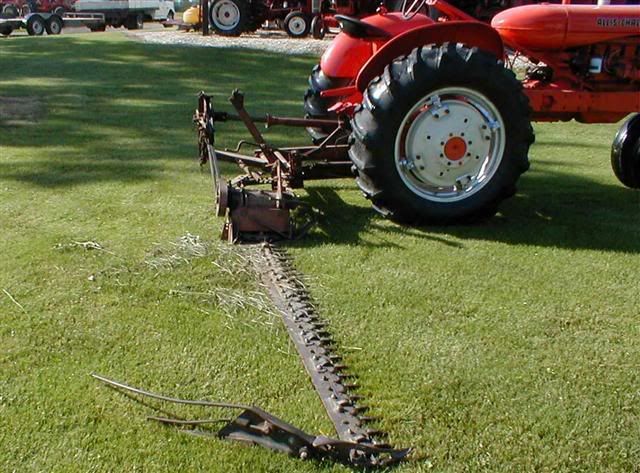

There is a version of the AC 80 called the 80S that's a mid-mounted mower (AC calls it "side mounted" hence the "S"). Perhaps this is the one you're remembering.
That mower on the Chat's Tractor website is probably the AC 80R2 that works with AC's 2-arm quick hitch. It's certainly not the version that goes on a 3pt hitch.
