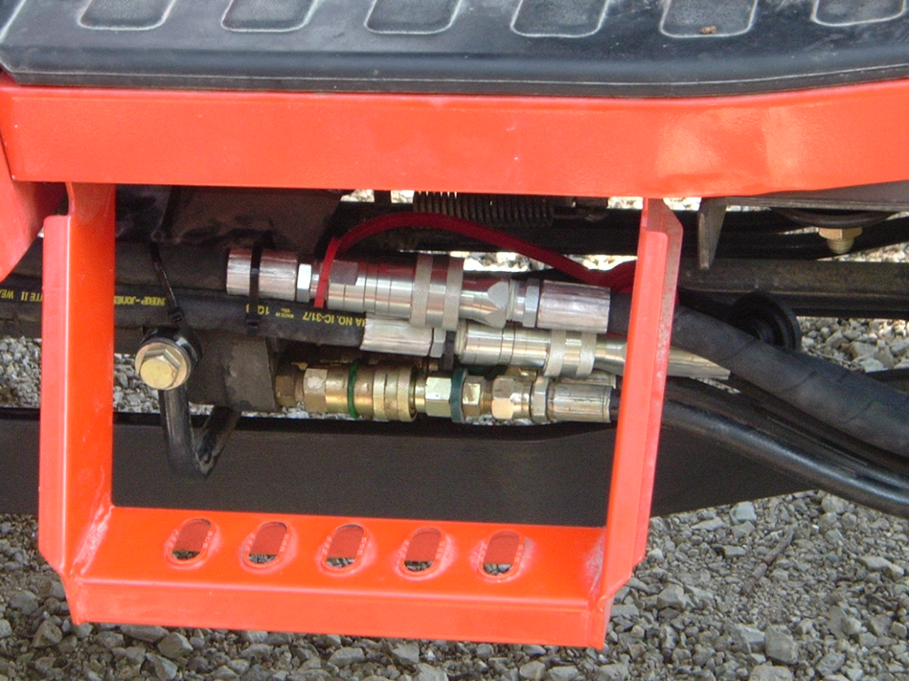

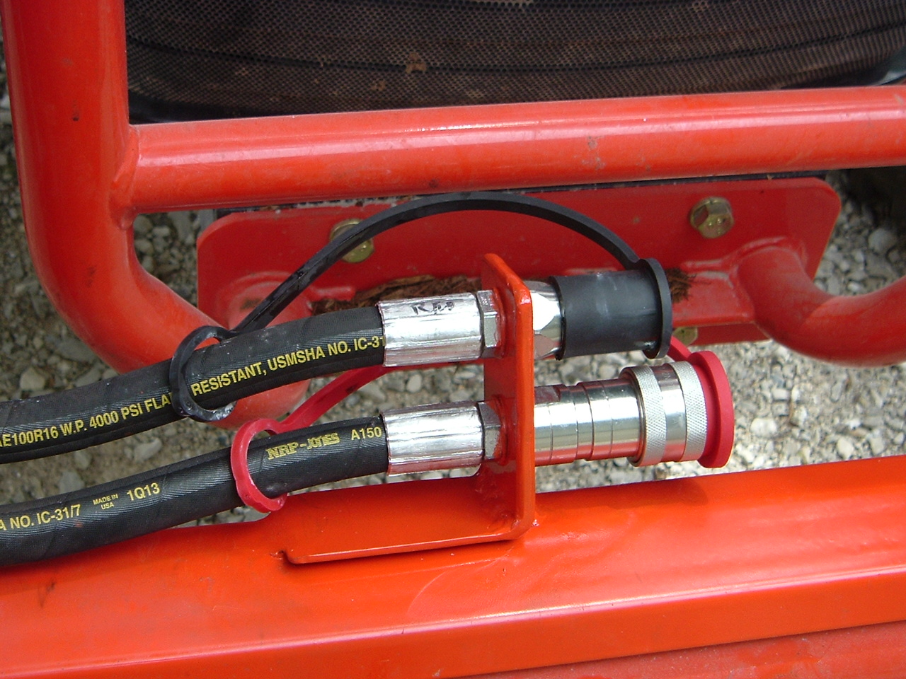

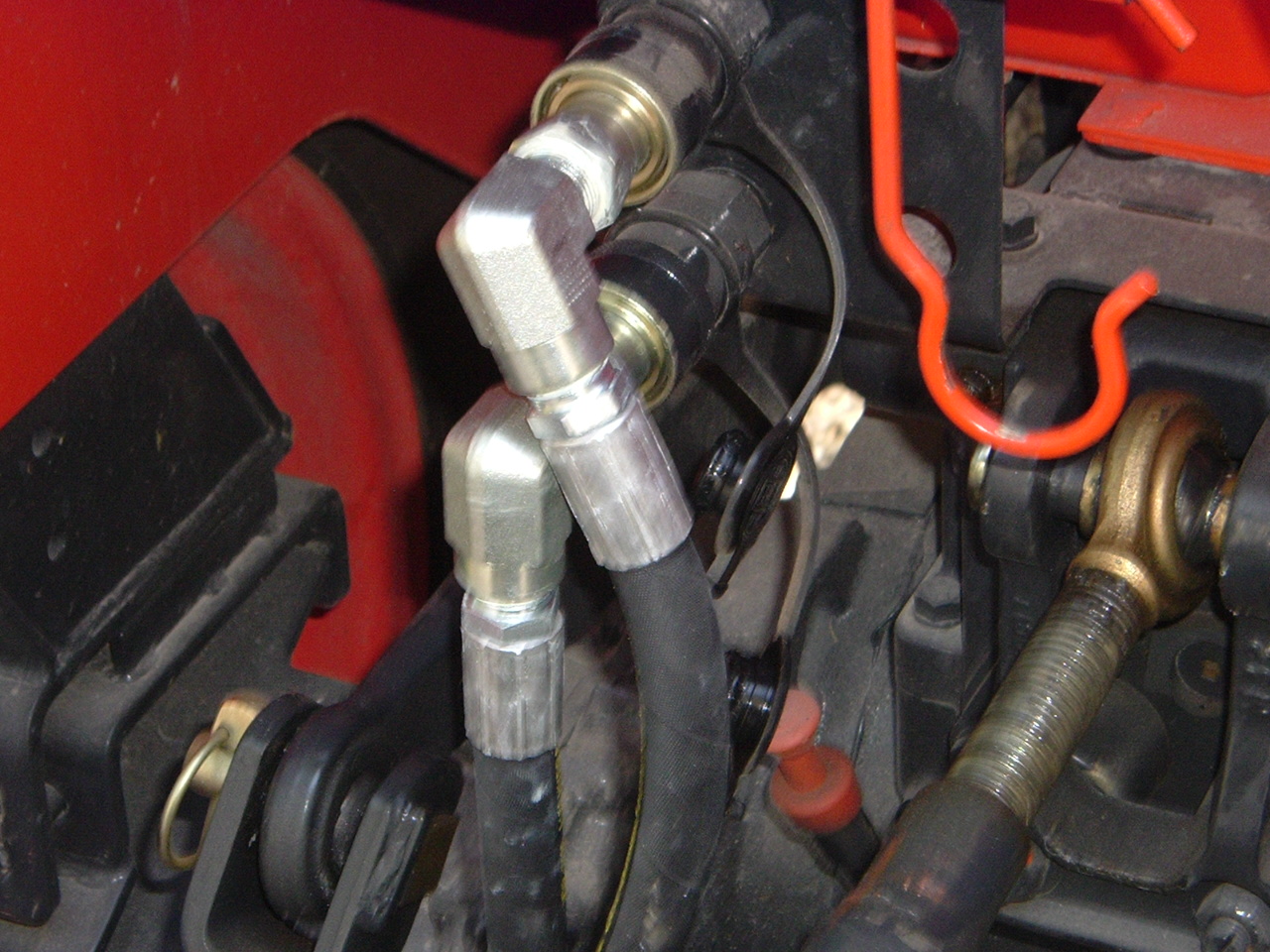

George don't be afraid of running hoses from rear to front, they mostly run along the FEL arms anyway, of course you have about 6 foot to thread thru, but they will be over the rear axle and under the floor pan, and will be run more or less permanently and tied up. You will need more quick connectors on the area of the FEL uprights so you can disconnect them when you remove the loader just like the 4 you do now. The price is not too bad, I had about $150 total in my install including all the connectors and hoses and everything.

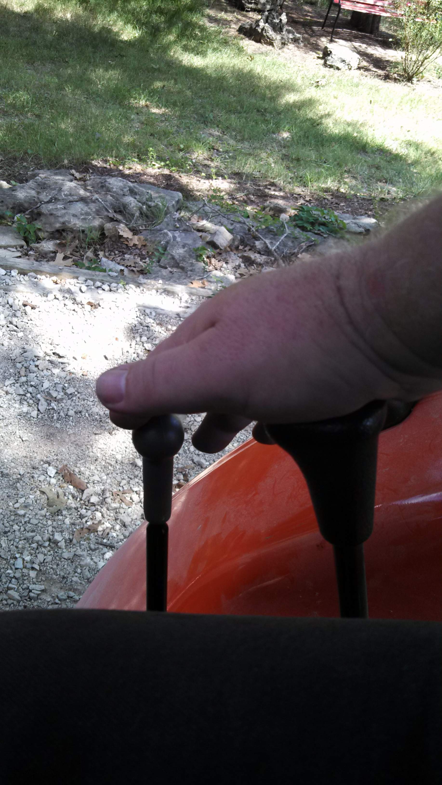

But of course if the rear remote lever is unhandy, you will want do do the diverter install by installing a diverter valve and using the existing FEL curl/dump joystick control to control your grapple while depressing a button on your FEL control knob. It is a pretty easy install.
My rear remote lever was in a handy spot and I extended it about 4 inches higher to make it even easier to reach without my hand leaving the FEL joystick. Here you see the joystick and the rear remote lever, and the extra quick connects under the floor pan and the quick connects on the front torque tube where the grapple lines hook up.

George you can probably develop a "rhythm" whereby you let go of the steering wheel just as you approach the object to be grappled, and drop your left hand to the Rear remote, while your right hand operates the fine final control of the lift/curl to get the grapple placed and then the left hand snaps the lid of the grapple shut and then goes back to the steering wheel.. You may find it works very well once you get used to it.:thumbsup:

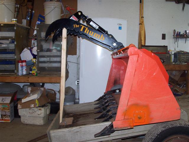

Or to save some money by not going to a SSQA you can go with a bolt on thumb and tooth bar.I have a similar sized tractor ,L4240 and this has been my best addition.Tooth-bar and thumb are easily remove.
I would put the money saved by adding a third function to your FEL.
I thinki this is a excellant idea, I am in the process of gathering up the materials for this, ordered my valve for the 3rd function from Surplus center, I am looking at tooth bars and add on buckit grapples now. A good friend of mine has had both and he thinks the add on grapple is more versitle. I will see i guess. It will make may 4200 with woods backhowe and thumb a lot handier in the woods! what kind is yours? LUTT
   / Another Grapple Thread #18
My thumb was purchased from" Greensmachine Thumb",tooth bar from Markum Welding(I don't think they are still in business.)Tooth-bars are easy to find.I had to weld an angle to the top of bucket to get it to fully close the thumb.
   / Another Grapple Thread #19
I'm pretty sure I've seen pictures of your thumb. Don't you have the one shown in post #11? It's directly from Greens-Machine. I hope they're not out of business - I just bought mine back in June or July. I still haven't had a chance to install it.
   / Another Grapple Thread #20
thanks pretty sure this is gonna be my route, I'm thinking the tooth bar would be better for grubbing out roots, rocks and small stumps. I'm sure not having trouble finding toothbars at all, probly gonna get one local. I've been looking online at Idaho equipment and Wr long. Good friend of mine at the local new holland dealership can get me on about the same price. LUTT
