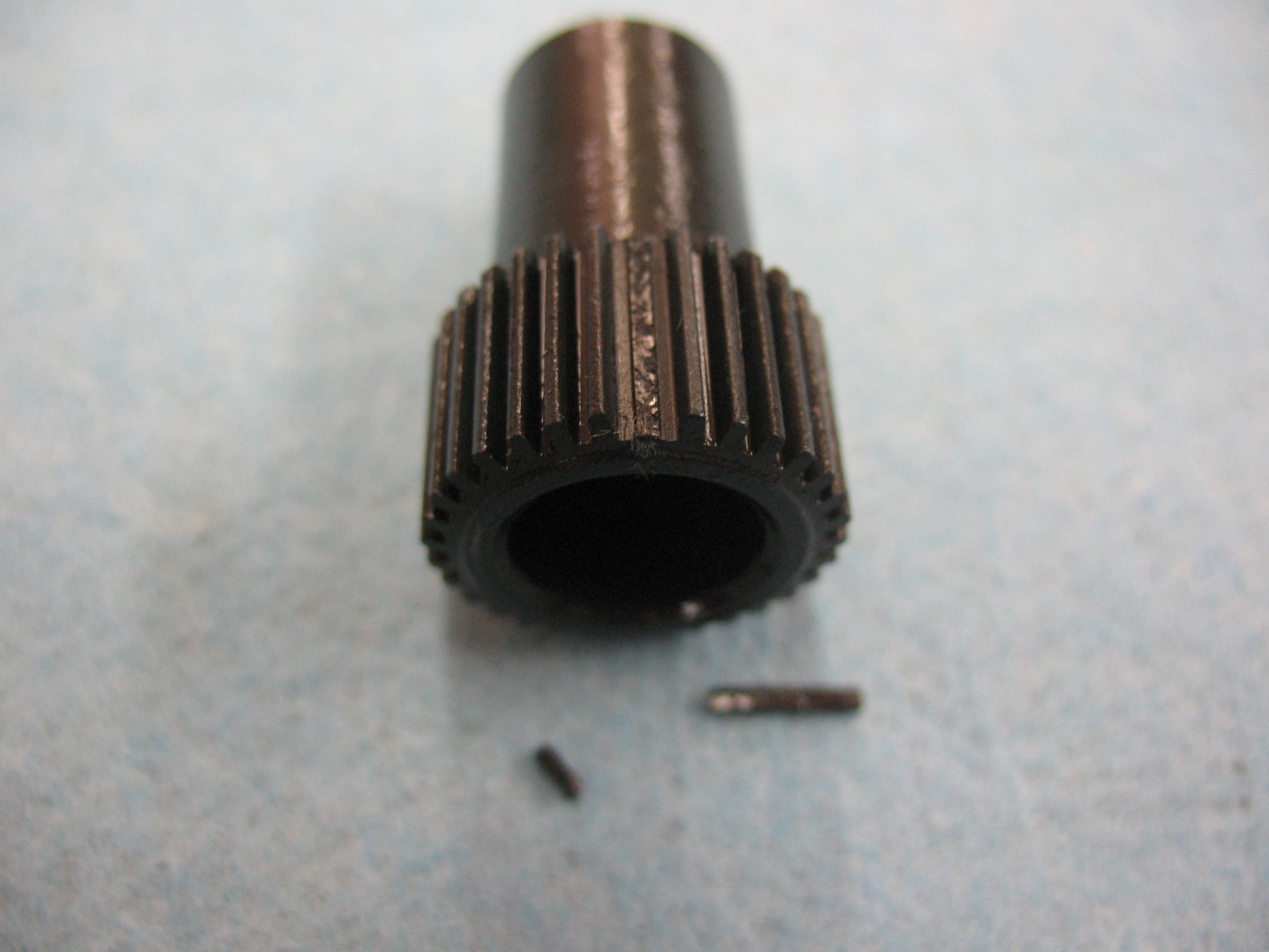

Hey Keith don't get to down in the mouth I just went through the same thing and it wasn't that difficult of a fix, just took some time and patience. Thanks to all the guys sharing on here I was able to dianose the issue and do the repairs. The link that ritcheyvs posted was a great help with the repair since it shows all the internal components and gave me a good picture of what I was looking for and what I would see as I disassembled the IP. lexgs posted a good narative on the particulars of re-assembly in post #14 in the following link.
http://www.tractorbynet.com/forums/kioti-owning-operating/141887-ck-25-gear-injector-pump.html
The only trouble I had was getting the fuel rack forward in order to clear the housing it sits in, it had failed in the stop position and was all the way to the rear. I ended up removing the idle adjusting bolt and used a punch and hammer to "lightly" tap on the fuel rack, I just had to move it enough to clear the sides. What I found was a broken tooth on one gear that had jammed up the works, after I cleared that everything worked fine.
The nearest dealer to me said that Kioti is paying for the parts but the owner has to pay for labor and transportation costs to have this fixed for what it's worth. Good luck.
