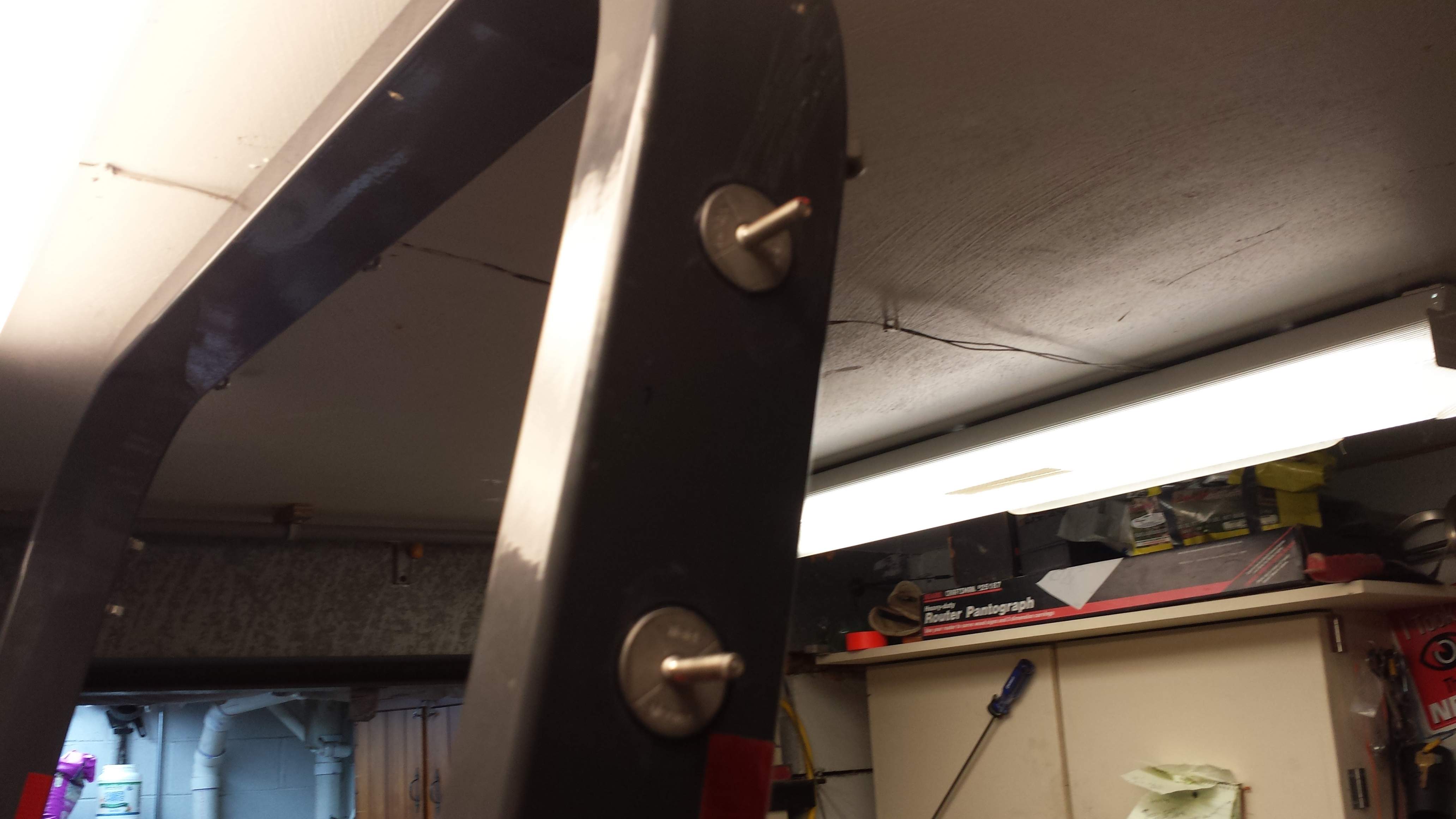

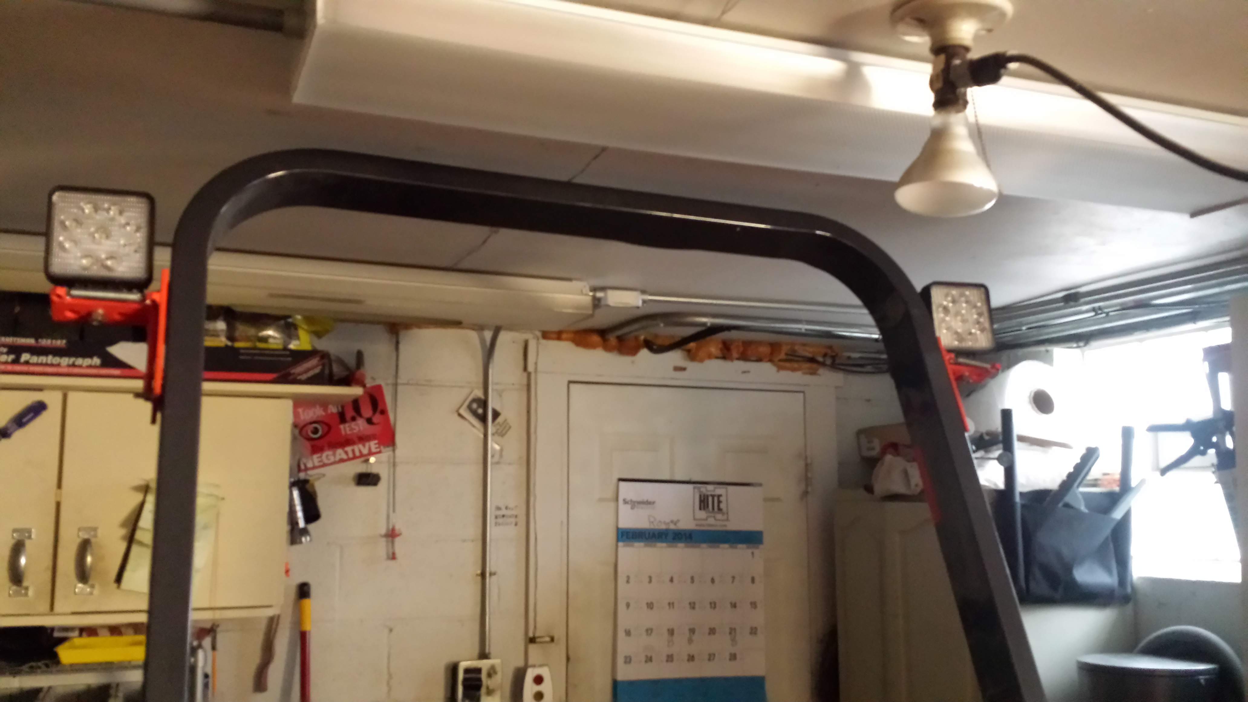

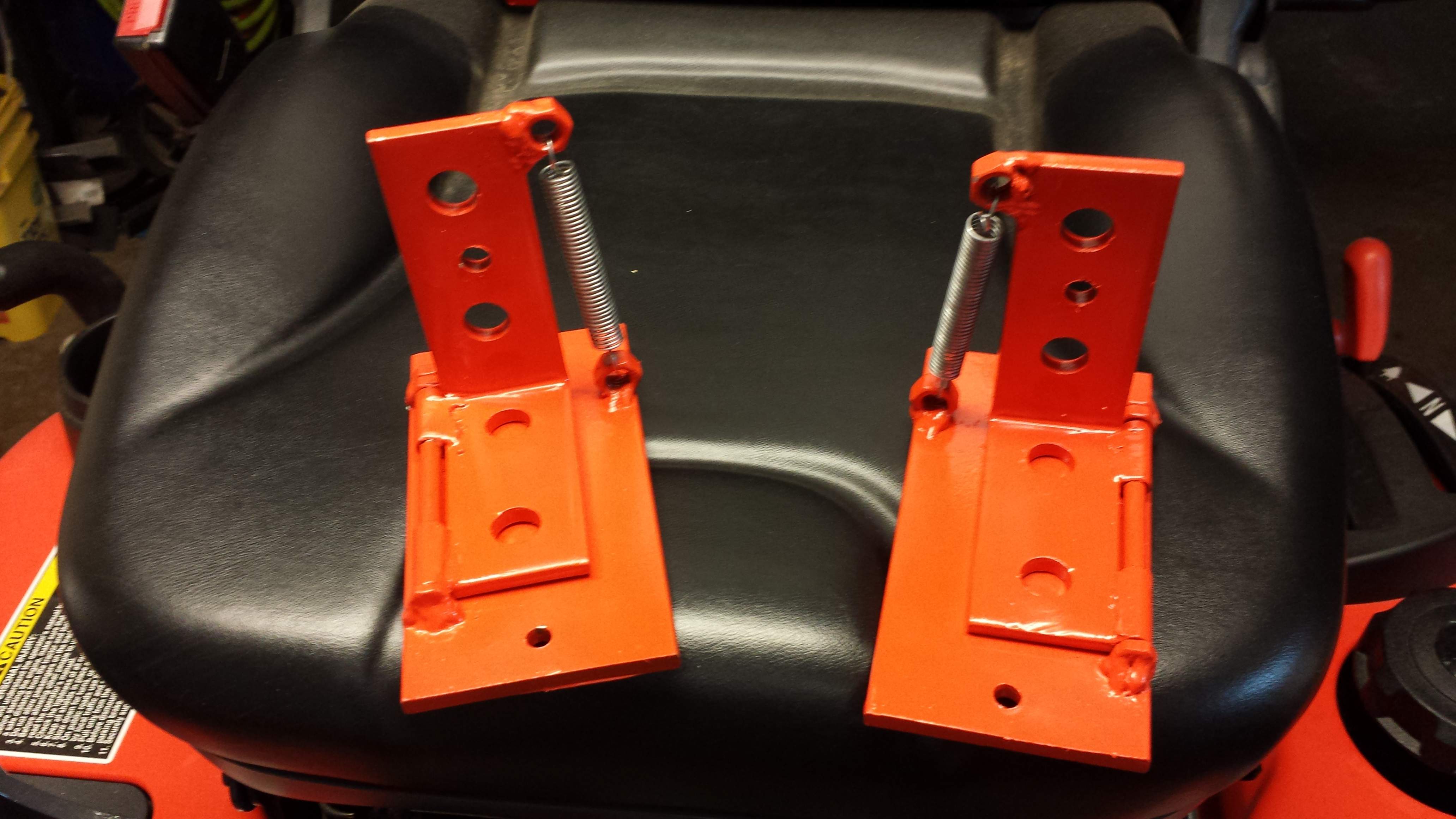

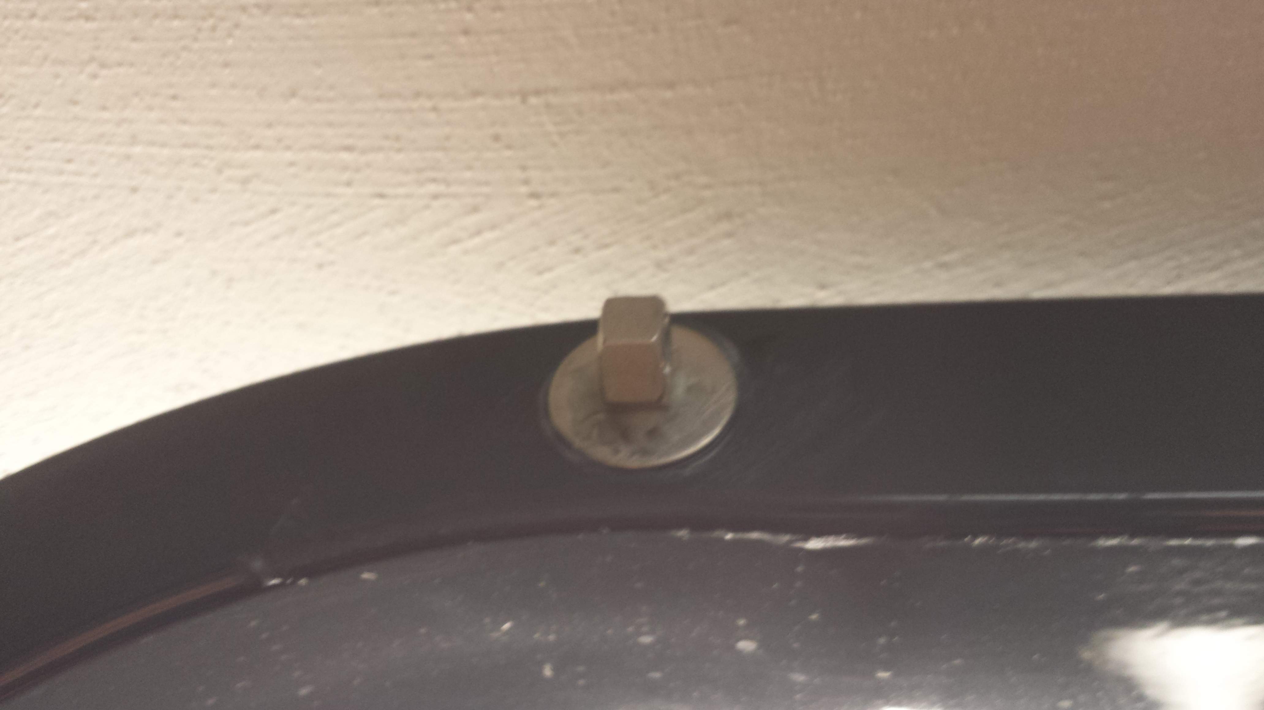

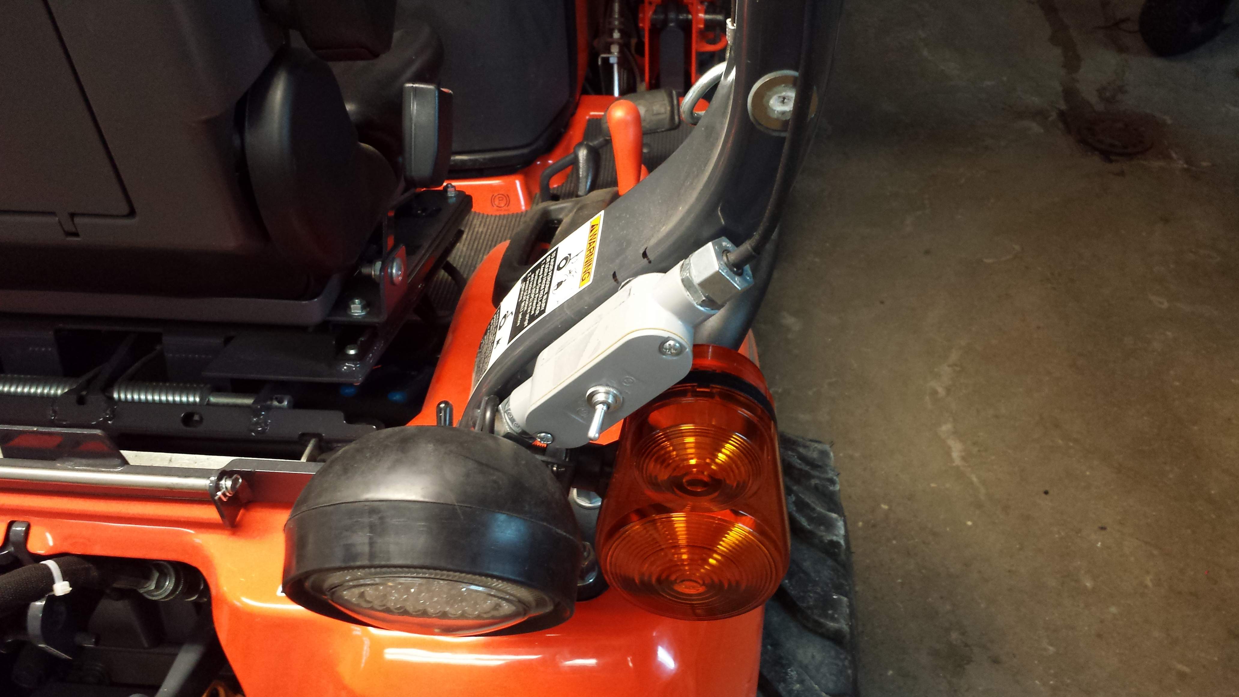

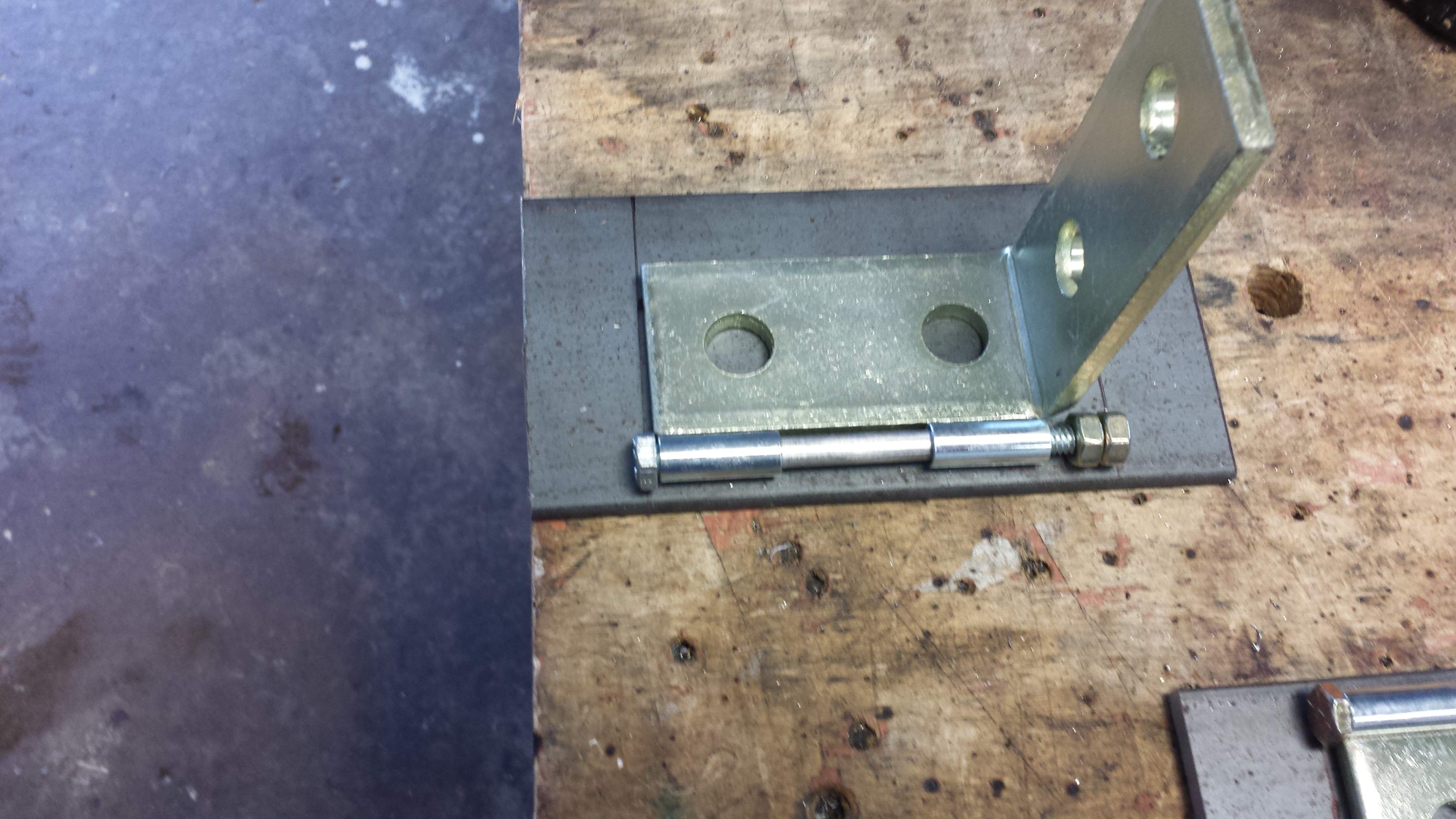

Used up a some scrap stuff and built Breakaway light Brackets for the BX 25 ROPS, No holes drilled in the ROPS..Used Weld Mount product..Great stuff.
The Weld mount studs are amazing, I Used left over 2 part glue to make wire ways for the light cable.
Stainless 3/8 Washer with a nut glued on, then glued to the rear of the ROPS. I also tried 3/8 tubing and washers but prefer the nuts,
The brackets will fold back then return on the spring....This is how you protect a 99 cent spring with a $20 dollar LED Light!!! (Hope not!!)
Also housed the switch in a 1/2 " Conduit pull Union, Cheap and small.
The lights are very bright and make night operations so much easier.

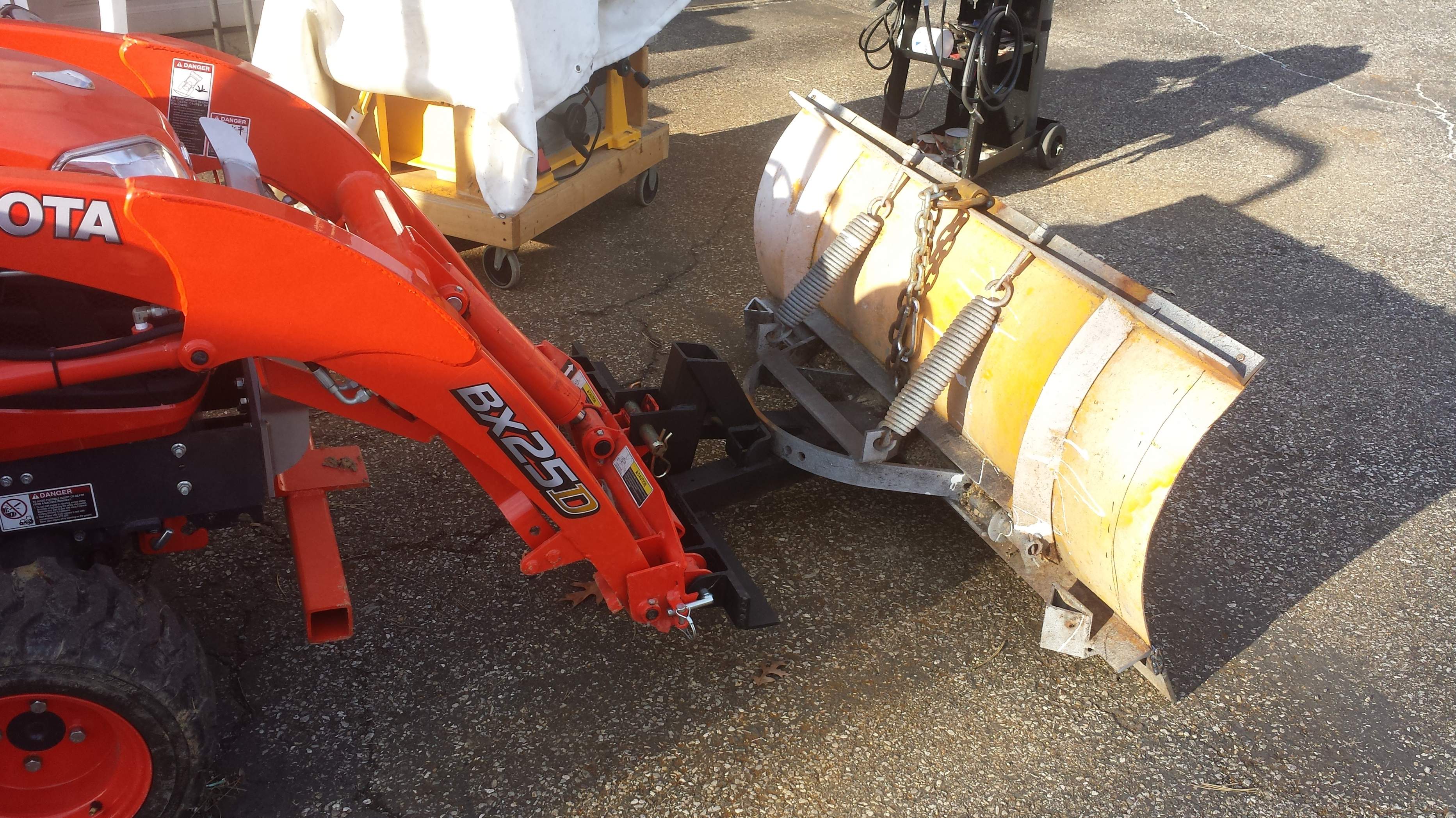

Also converted a 1960 Willys Plow for the front quick connect, Got it for scrap prices and the cut it to 5 feet,
Again used up the scrap pile.

Nice work! Love the breakaway feature. :thumbsup:
/ Another BX25 ROPS LED light Bracket #4
Very clever! Thanks for sharing!
/ Another BX25 ROPS LED light Bracket #5
Good thinking.:thumbsup:
