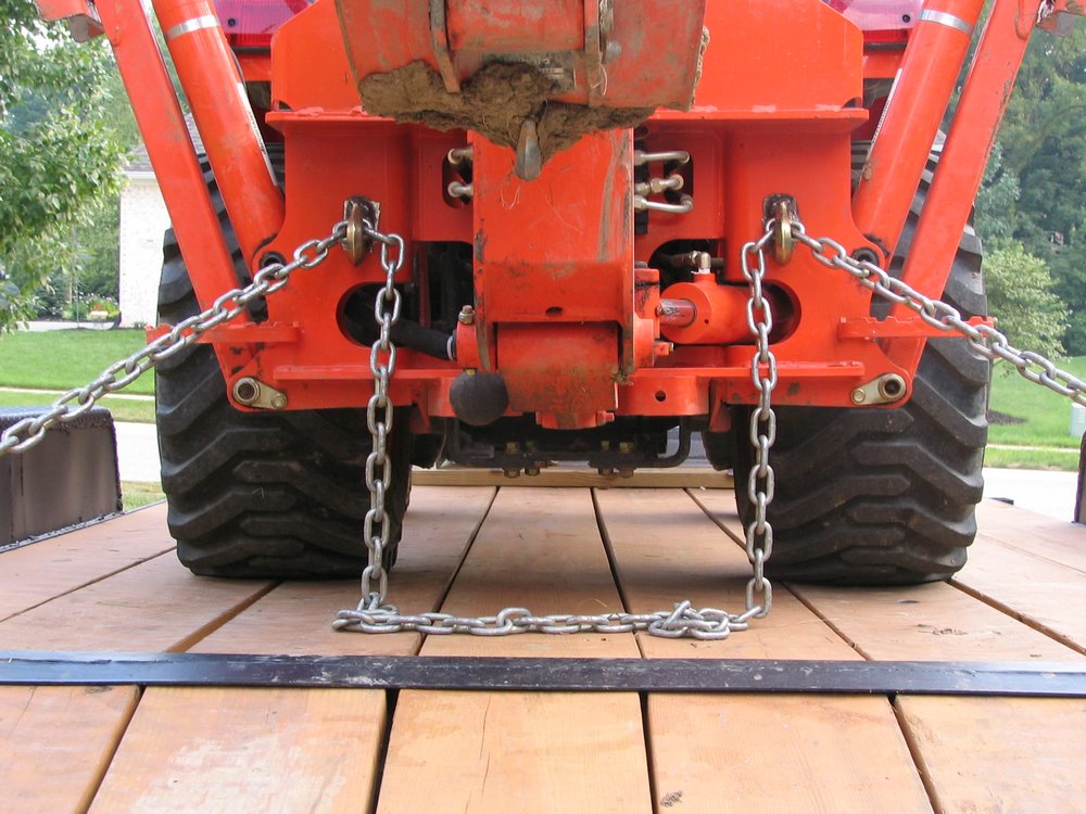

Well if he would put the tractor in neutral pull it foward with 10,000 pound ratcheting chain binds, the rear would be tight.
How ever i would make 4 chains for hauling the tractor and use four 10,000pound binds.

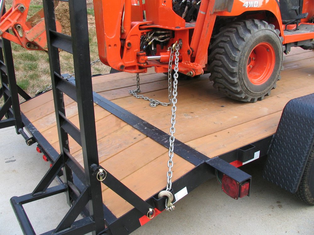

Use a 5/8 or 3/4 chain drop the catch hook though your stake pocket bring it back up and drop it on to the pocket. Hook can never come loose.
If you dont have the ratchet binds use the normal style and a pipe to get them tight. Then use some 17gague wire to keep the bind locked.
I have never seen a big chain bind break. They wouldnt be rated for what they are rated for if they are going to break.
I have seen alot of people use one chain for the front one chain for the back. How ever if that chain slips at all now your load is loose. Use four chains and your load will never come off.

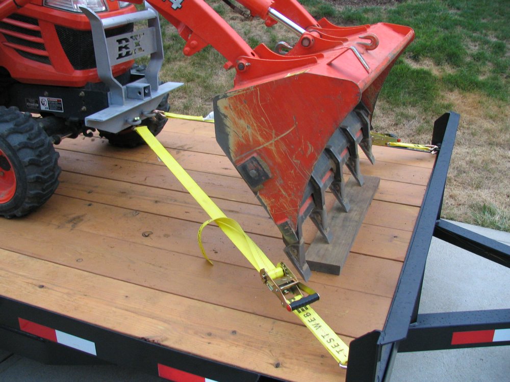

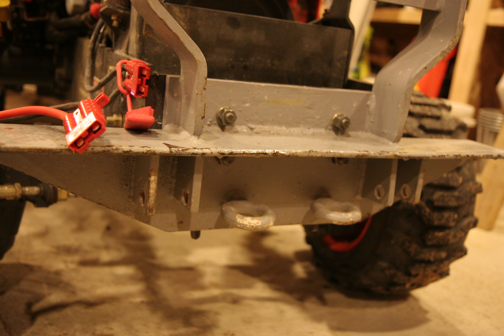

OlderToday ... nice job on the hooks. I felt the same way - I did not like my options to tie down my BX. I added some spots in both the front and the back. I use the stronger chain in the back since I figured I would have exponentially more force on the tie downs when I hit the brakes than when I took off from an intersection
