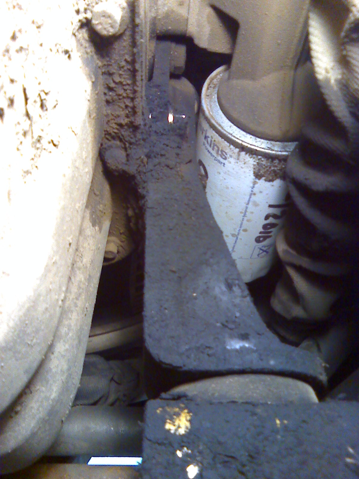

I have experienced the exact same failure as QuickDraw.
I was mulching a small job with my ASV RC100 with a Gyro Trac HF500 cutterhead and noticed a loss of power. I was not working the machine very hard the material we were clearing was light brush. No warning lights came on to indicate a mechanical problem, but I shut the machine down to investigate. What I found was not fun...
When I examined the engine compartment I noticed what appeared to be a spray of oil on the right side of the engine compartment (if looking at machine from the rear). I knew I had a fairly serious problem so I backed a trailer right up to the machine and cranked it and quickly loaded it and shut it down.
When I got the machine back to the shop we examined it further and noticed that one of the motor mount bolts had come out. I was skeptical that this could be my problem at first. I replaced the bolt filled her up with fresh oil and cranked her up. The machine fired right up however the engine was knocking so I shut it down and took it into the dealer. I explained the problem and asked if it is possible if the motor mount bolts go through to the crank case. They told me that there is no way that the motor mount bolt coming out could have caused me to lose oil. Anyway, when they fired it up to jump it of the trailer and put it in the shop that knocking self revealed itself when it through a rod out the side of the block busting a whole the size of a watermelon.
My machine was no longer under warranty, and with only 800 hours on the machine you can imagine I was highly disappointed that I was having to replace the engine.
We order a new engine and I wanted the dealer to call me when it came in so I could look at it. When I went to look at the new engine I took a 12 inch screw driver and stuck it in one of the motor mount bolt holes and stuck it in all the way to the handle. The mechanic was dumbfounded! He had never seen or heard of anything like this.

QuickDraw, Thanks for starting this tread. Otherwise, I would have overlooked a potential serious problem. Too bad I was never notified by ASV.
I finally got around to checking the engine mount bolts and 6 of the 8 bolts were loose. Picture below shows the oil caked dirt on the left engine mount. Both sides were loaded from leaking engine oil. 18mm wrench saved a potential engine replacement.
