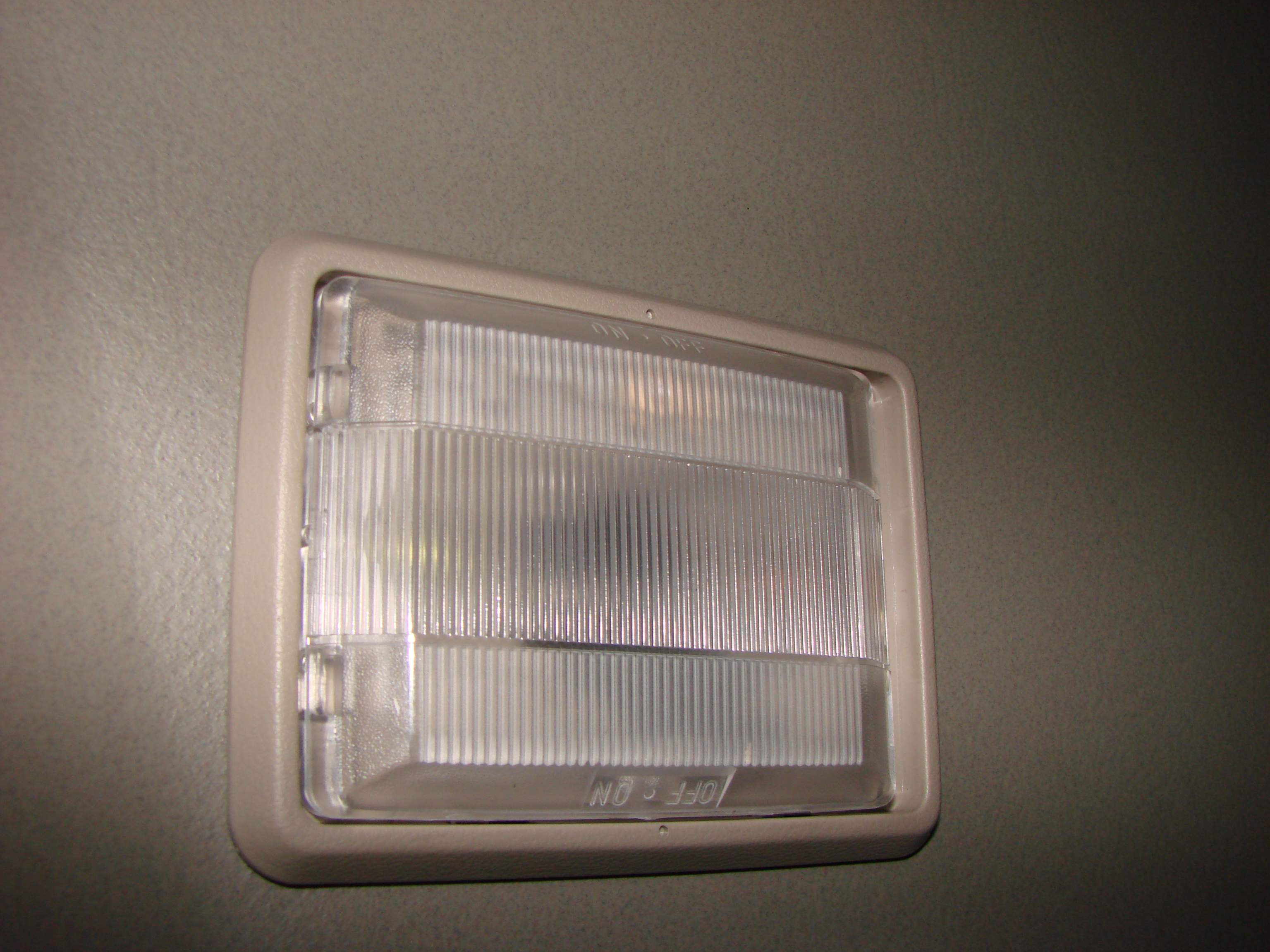

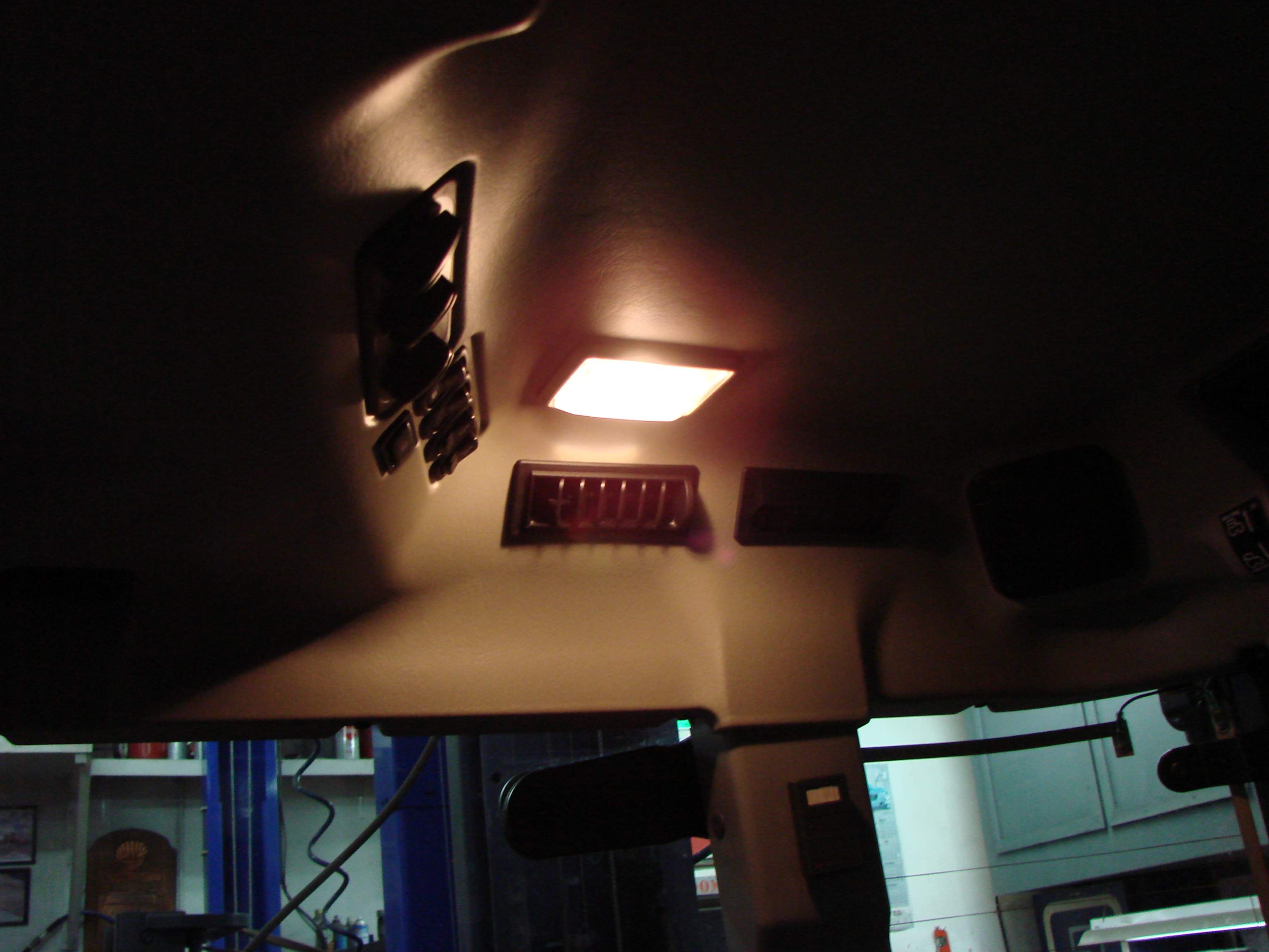

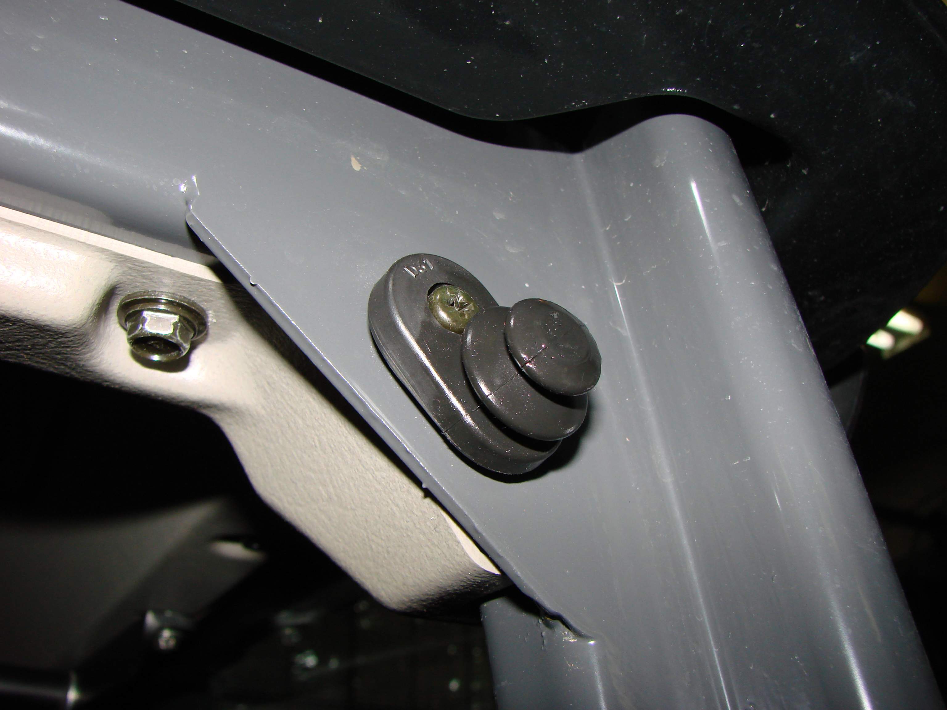

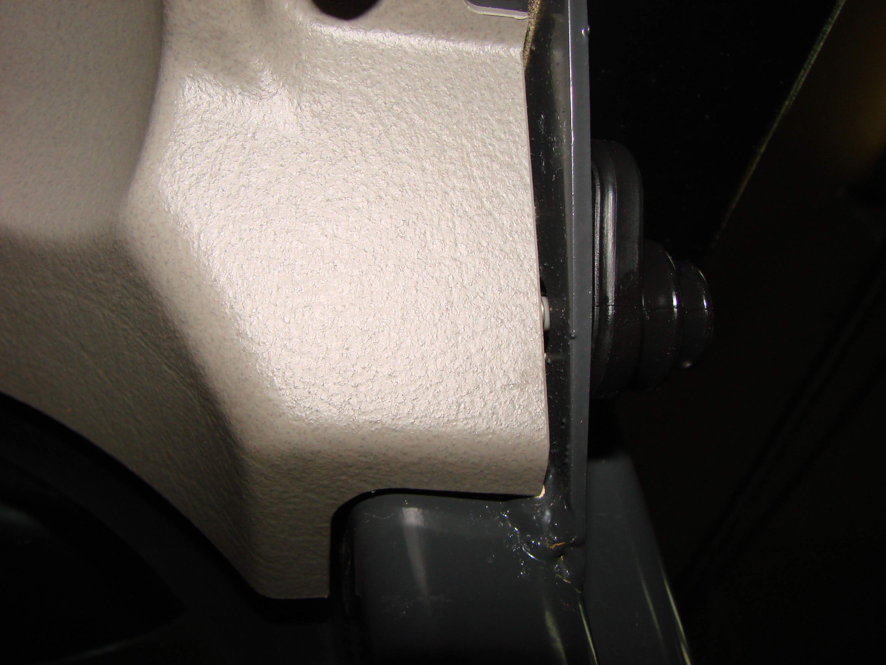

WaxMan the interior light is hot at all times via the fuse panel. The light it's self has a switch on it where you can have it turned off at all time or turn it on only when the doors are open or never have it on. I attached a few pictures for you to view. You'll notice that Kubota had the head liner come down on the inside of the door post switchs to hide the wring on the inside. I'd say picking up the light and switches at Kubota. It would be an easy install. Hope this helps. Paul

Thanks for the quick reply and pictures, I see clearly now how Kubota door switches work , If not for you I would have to drive 50 miles to see this. Seems like just a normal low profile switch with the rubber on it, I like that. Something I can rig up pretty easily now that I see what switch they used.
If I can ever return the favor, just let me know.
Too late to get the light from Kubota, went to the junk yard yesterday searched just about every make and model till I found a flush mounting light, gray in color. I had the headliner of the tractor out and wanted to get a light in before I reinstalled it , been wanting to put one in for a while now. I did that part last night, now the wiring.
I just wish I had a HOT wire (without key on) already up in the head liner.
I have no room on the sides or the top to recess the light like Kubota's light.
The light I got has two built in spots (Map light) on both sides and a dome in the middle.
When I first held it up there I didn't think I would like it because the spots not only shined down on the dash but outside each door, because the truck I took the light out of is much wider then my tractor.
But I think i like the fact that it shines out the door, lights up the ground in front of the door and the step so maybe it will be nice. Well time to go feed that hot wire.
Thanks again.

Your more than welcome. It's not as if you asked for a kidney :D Glad to help out in any little way I can. As for the power feed. I'd just take it off the ignition with a fused line and run it up to the head liner.

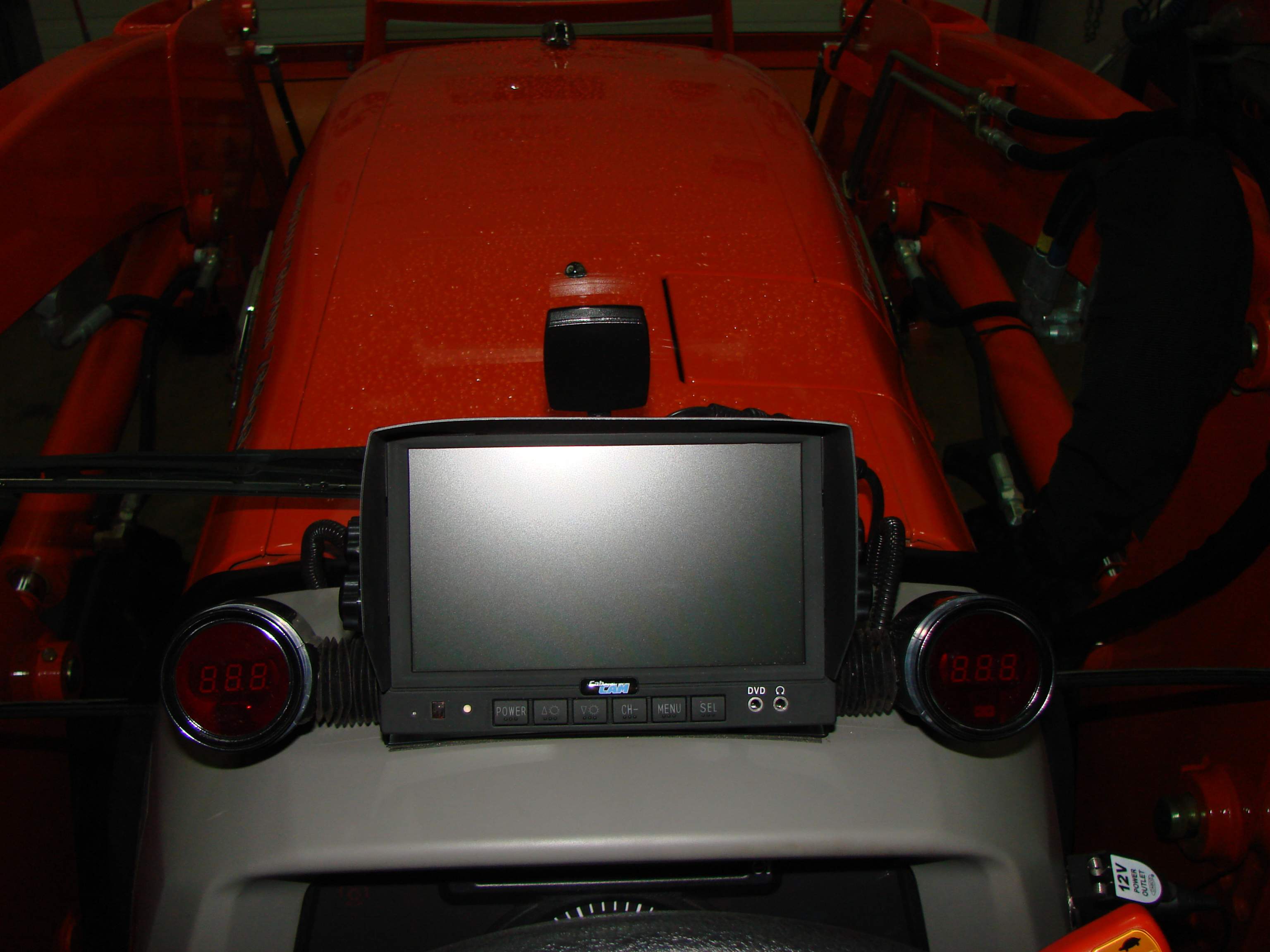

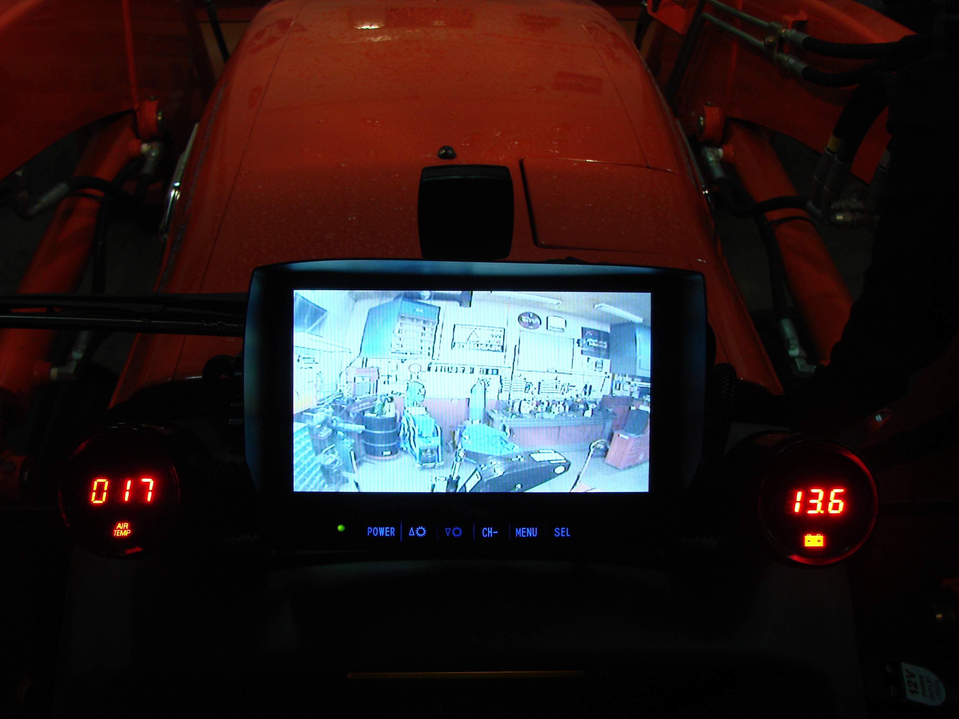

Thanks WaxMan. I got my volt gauge installed tonight. Now it matches the gauge on the other side of the bracket. Got to keep it all balanced ;)

Looking good, I like the little rubber accordion gasket spacers, nice touch.

I would get two more gauges now and set them in just a little to make like a triangle , you have to fill that space on the top side of the monitor. Have the next two just about touching the monitor, about a 1/2 to 3/4 inch away from the monitor and a 1/2 to 3/4 inch away from the other gauges what ever looks best.
Oil Pressure and transmission temp, Definitely two more gauges it will look more complete. Do you know what I mean?
