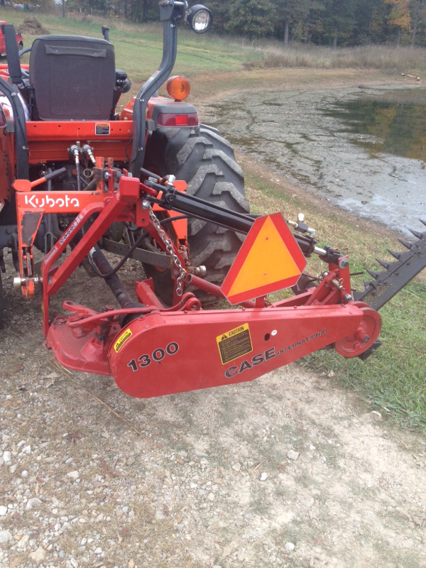

I've been on the hunt for several months for a sickle to mow around the ponds and possibly use to cut about 12 acres of hay. I ran across a newer Case IH 1300 9 ft in excellent shape very low use and kept inside, had to give 675 for it but thought it was well worth it. I'm thinking along the lines of a hydraulic setup like a enorossi does anyone know what size cylinders they are using ? I'm going to try and get some measurements off mine to try and come up with a idea of what length cylinder I would need, like to go from about 90 up to 45 or more down. I did look into the rowes kit but a bit pricey and doesn't offer the degree of down travel for me.

Forgot I never posted a finished product pic of the mower. It works really nice I've very pleased with it.

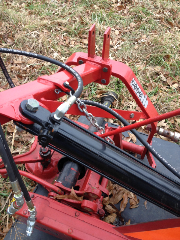

Can you share more photos of cylinder mounting attachments. Thanks,
Neil
/ Another adding hydraulic lift to sickle mower.
#11
I will be glad to, but it will be a few days before I can get anymore pics, I'm out of town for the week. I did find one more photo on my phone from the other angle.

A few pics

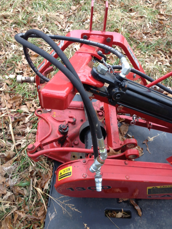

A few more.
