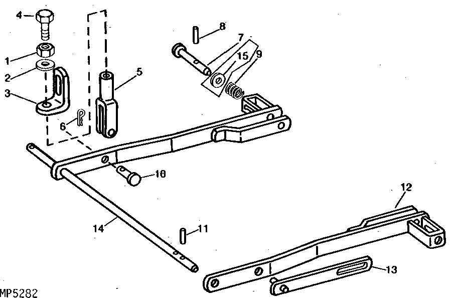

The one thing I noticed,is the deck linkage looks to be broken for sure on the right side. But that is something that can be repaired/replaced,as with just about every part on JD equipment,no matter how old.

What exactly is broken? LOL. I am not familiar enough to know what is wrong and what to tell the dealer that I want replaced. I want it to show up ready to blow snow and mow in the spring, save for some general maintenance and cleaning.

Look at the pic of the deck where the mule drive is laying on it. There is a round bar that runs the length of the deck. It should have what is in the drawing I posted. The left side might be OK,can't tell from the pic.The linkage for the right side looks to be laying on the deck on the left side. You can barely see the spring latch. It should be attached to that little piece you see on the right side of the bar. I'm thinking it was broken off.

From the picture of the mower deck, it looks like the previous owner hit everything he could with the deck. It's pretty hard to snap off that deck hanger and the right front of the discharge chute is definitely pushed backwards. A good whack with a sledge should fix that. Also, the front pulley assembly is caved in behind the mower drive belt tension adjust knob. Ask the dealer to mount the deck and start the blades up for you. This will test the electric PTO clutch which isn't cheap to buy and replace and the safety interlocks. Then he and you will know what needs to be fixed!!! :thumbsup:
PS: It looks like the hanger leveling adjuster, diagram number 5, is bent too...

Wow, yes, I saw the pics on a phone. I looked closer and that deck is concerning. The mule drive is all bent, jeez. How the heck do you bend a mule drive? The paint looks wasted. Is that grey primer over rust?

The mule drive is not bent, the sheet metal cover that bolts to it is. Google it, new replacement with decal, about 40 bucks
