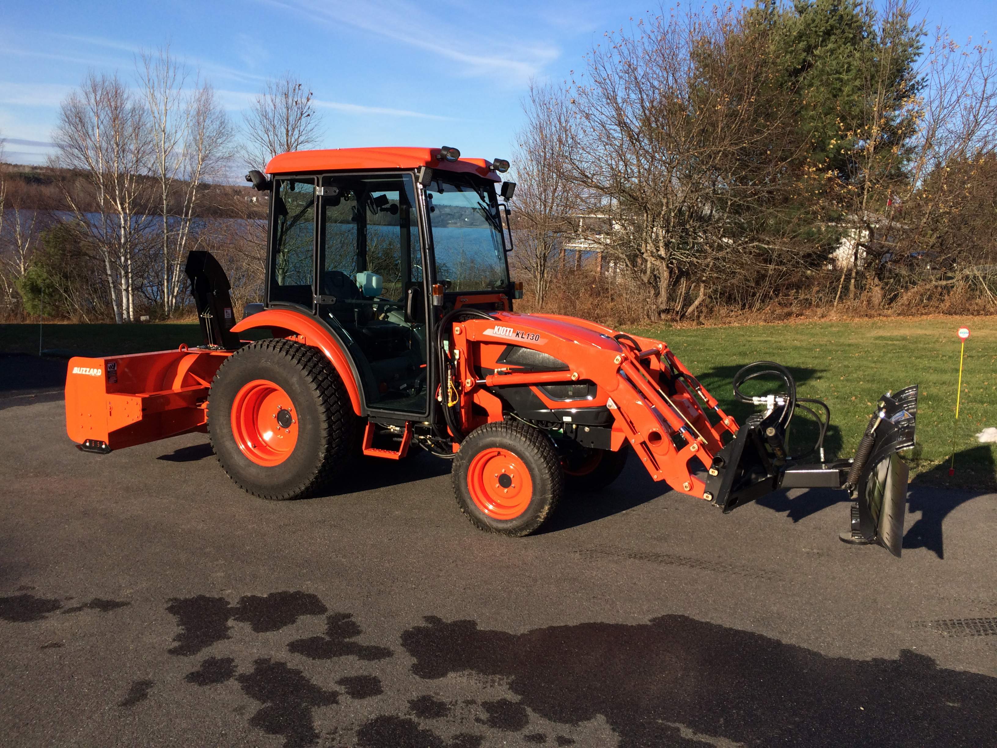

This is my first year plowing with the CK35, but I'm very pleased so far. The first snow was about 10 - 12 inch of heavy wet snow. 2nd plow was about 4 inch of wet slush, again no problems. The CK never spun a wheel, never missed a beat, didn't move sideways at ALL. With that said, every tractor, every plow truck at some point will veer sideways if pushing enough snow. With a tractor your size, it's not going to happen very often.
For comparisons, my CK35 weighs 5000lb with Plow and Blower, I run turf tires, non loaded year round.View attachment 401739
Like tractor tom almost to the word. First year plowing with the ck35. 12" of heavy, heavy snow. The ck never spun a wheel. I do have a frame mount though. 7'6" fisher. Haven't even needed the rear chains yet.
