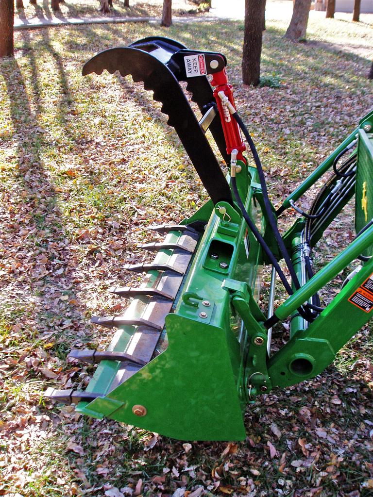

You really should buy and install (easy, two bolts) a 7-tooth tooth bar. Life with the bucket will become 1000 percent easier and more versatile after that, and you won't ding up the cutting edge on the bucket. Mine is from Iowa Farm Equipment and I really like it, but lots of folks sell good ones including Gator Attachments and Everything Attachments. Just get a heavy duty version with pinned (i.e. easily replaceable) teeth. Stay away from the cheaper ones.
While waiting for the tooth bar to arrive, try a very slow approach and slowly curl up the bucket at the same time once the blade contacts the pile. You can also pull up close, raise the bucket and curl it down to vertical, and lower the cutting edge into the pile while backing up slowly. Sometimes that will break the crust enough to get things started.
A tooth bar will make this problem go away.

When it's old clumpy dirt, it helps to have a toothbar (the teeth to apply more pressure points rather then spread across the width of a bucket edge).

Best $200 you can spend. Get revved. Holes do not matter once the paint is scratched and dirty. A toothbar will give you an entire different plan of attack.

I use my box blade on the 3 pt. for counter weight. Also, I've got a toothbar and while it does break up a settled mound some, it also seems to reduce the capacity that will break out when the bucket curls to complete the fill. I've always assumed this is due to the weight of the bar. I tend to need to start backing out as I curl to reduce the load on the bucket. i did pretty good before I had the toothbar after getting past the learning curve so there are times I wonder if it was needed. Now that I have it I tend to leave it on most of the time though.
The edge of the bucket is pretty tough and I used it pretty hard without any deformation prior to getting the tooth bar. That being said, not many rocks where I live.
