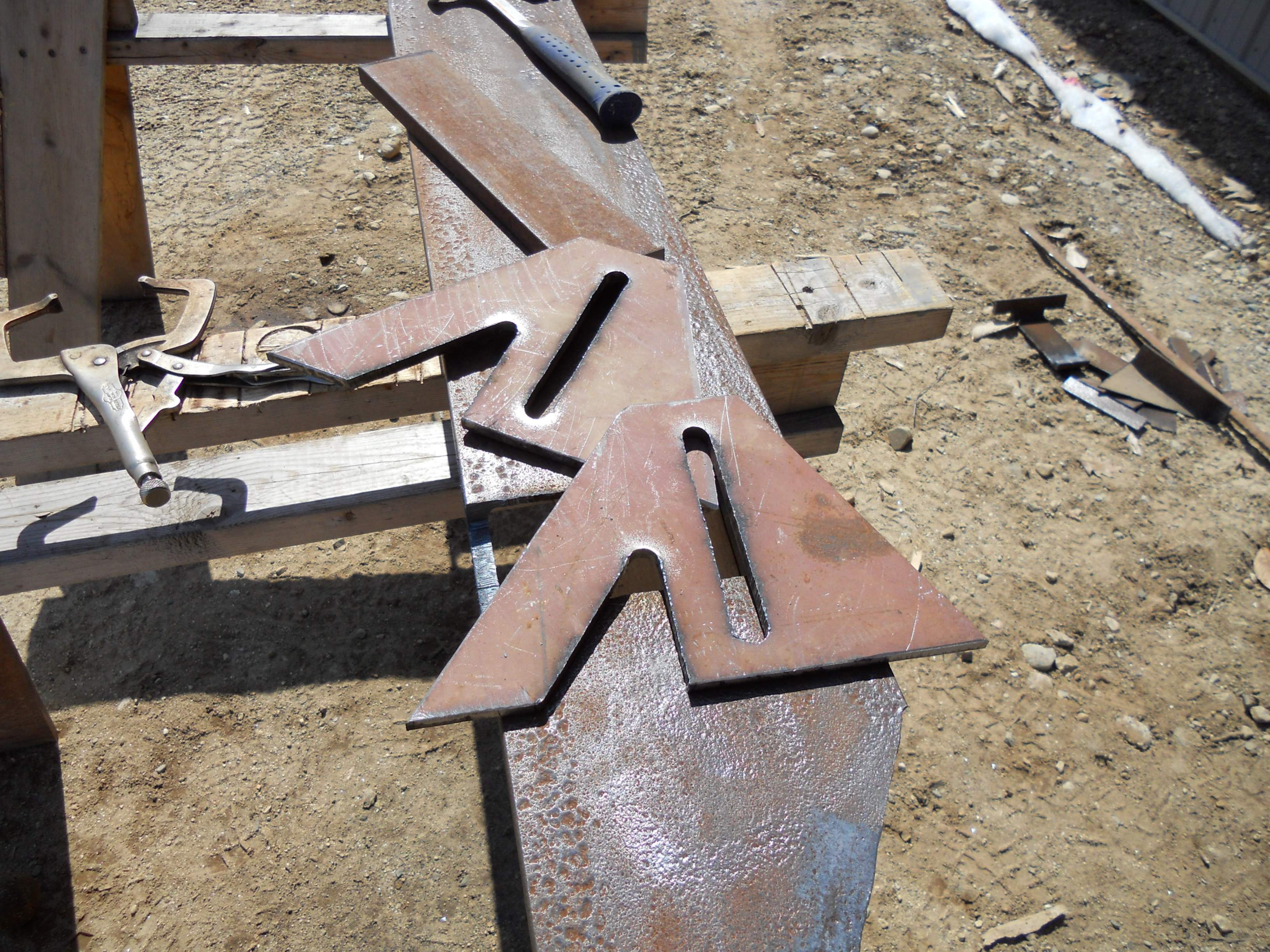

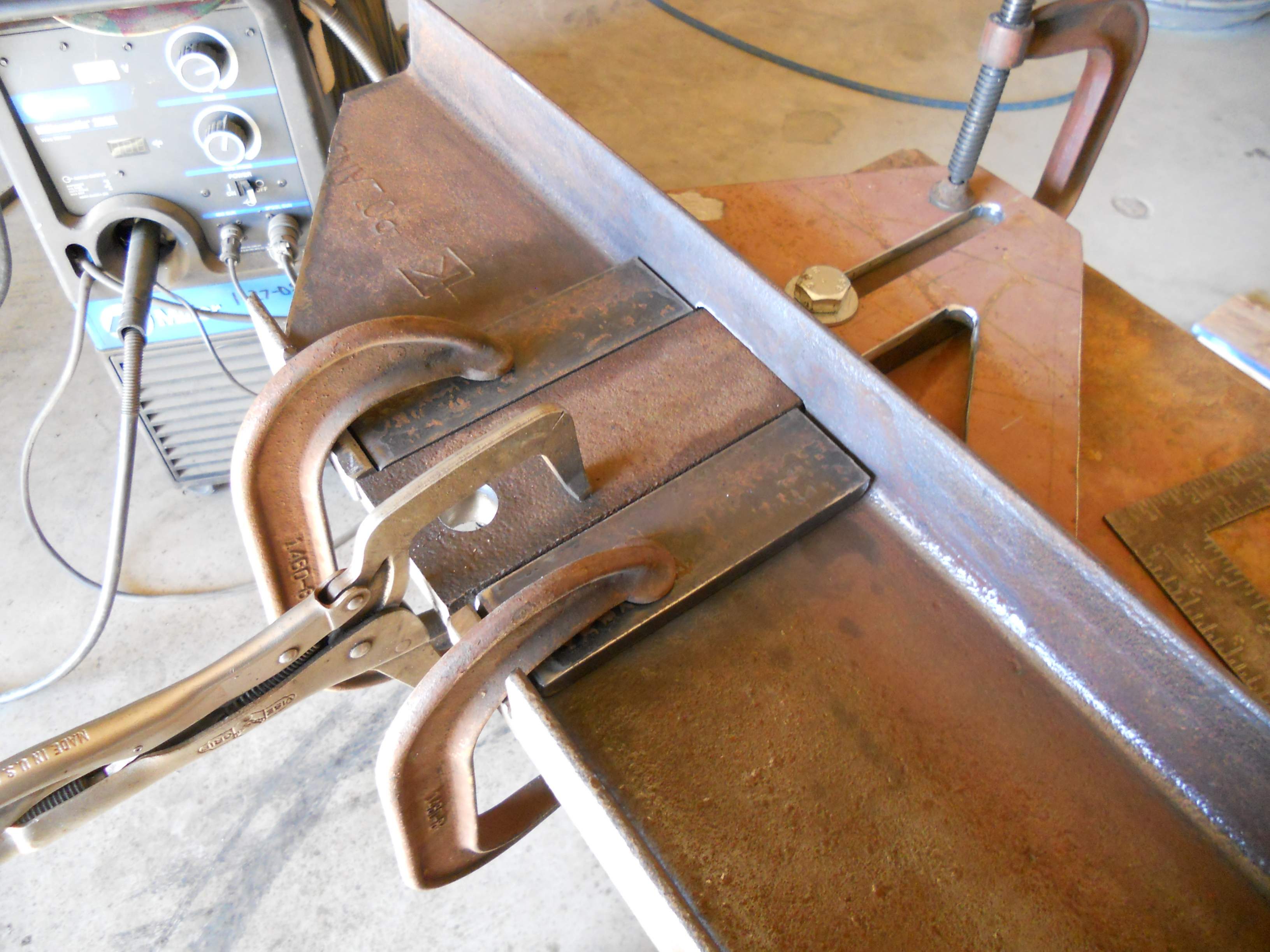

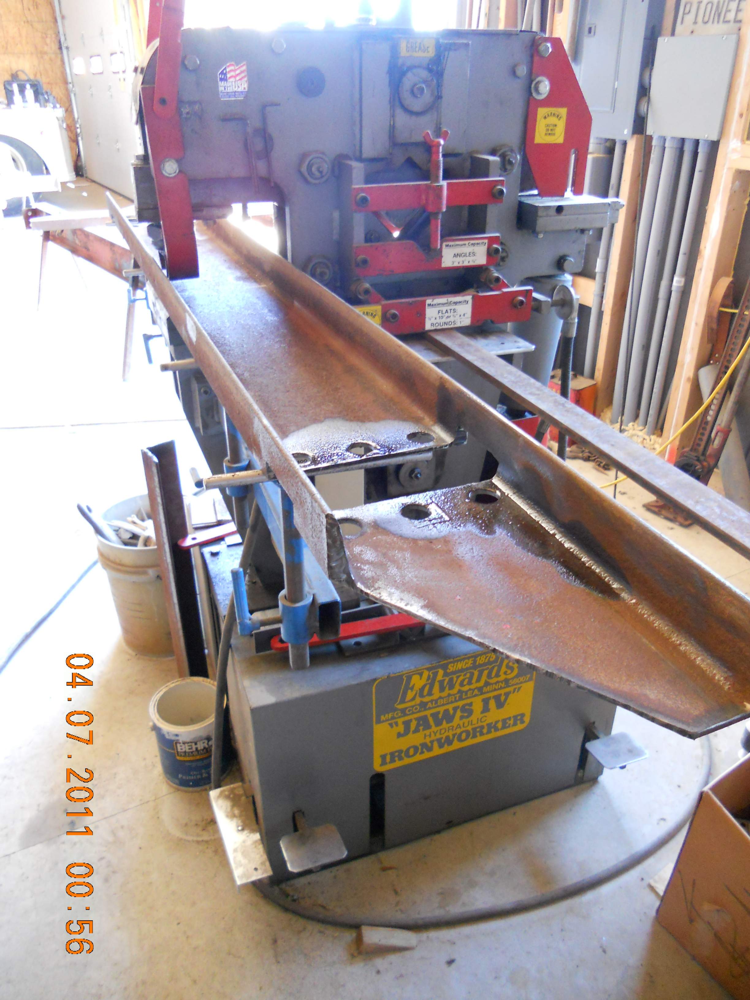

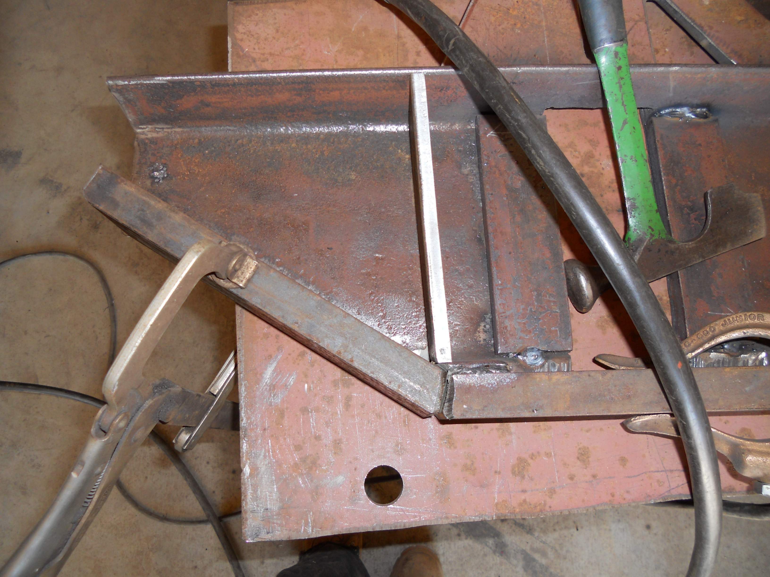

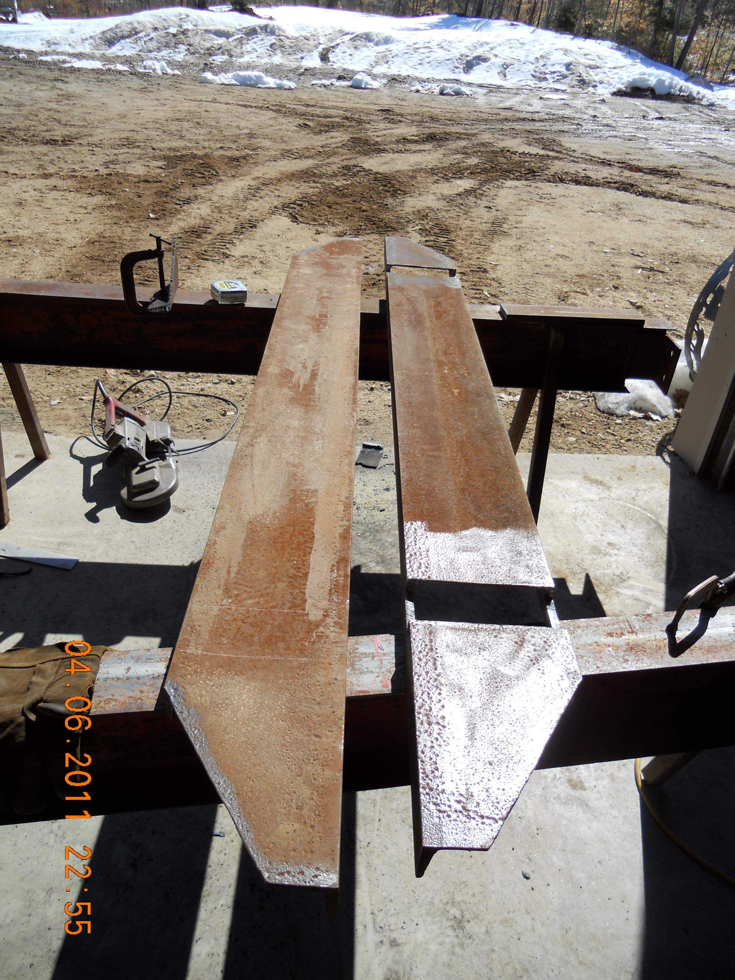

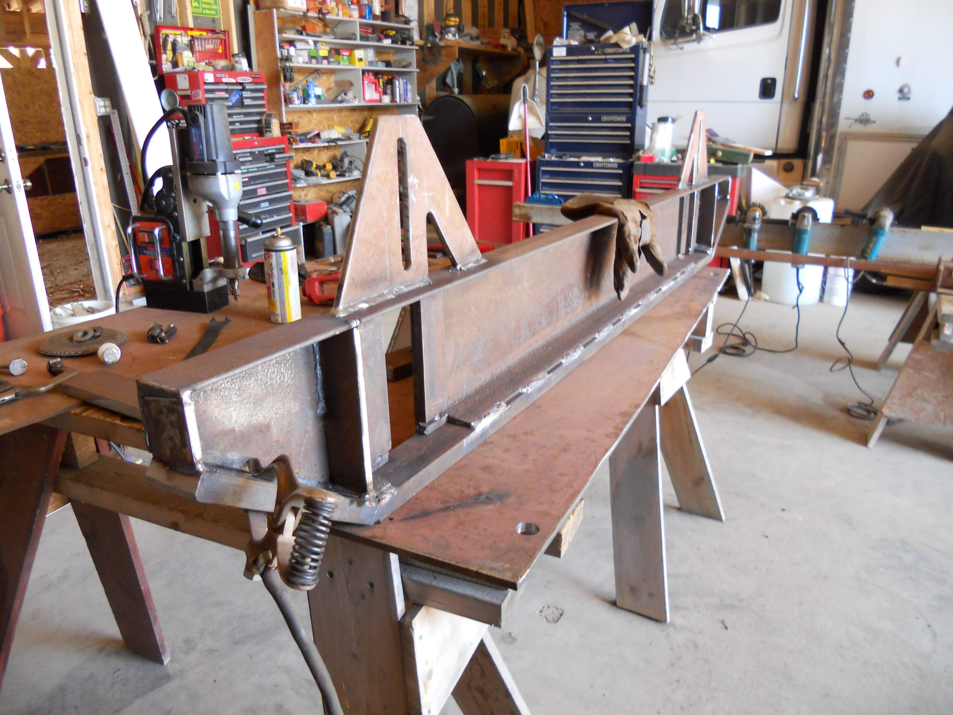

Here's what I've got done.
Pic. 1 shows cutting out the adjustable runners with the one on the right having the cut out for the slide adj.
Pic. 2 Punching holes to weld spacers (for the slide adj) on from the back
Pic. 3 Cutting out parts of the slide assy.
Pic. 4 Clamped up and ready to finally weld something!
5. Welding on the 1" wear strip on the runner.
6. The runner, basically finished, it's sitting on the side plate that will sit vertically right against the runner. The supports for dual cutting edges will get welded to it.
