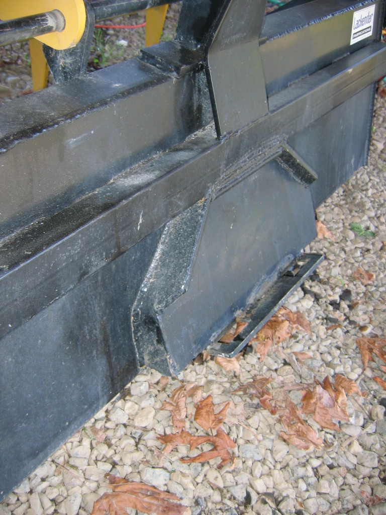

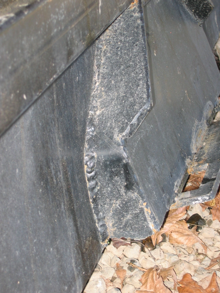

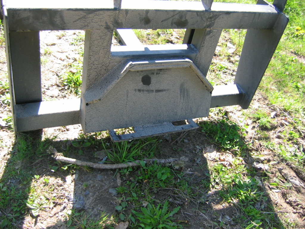

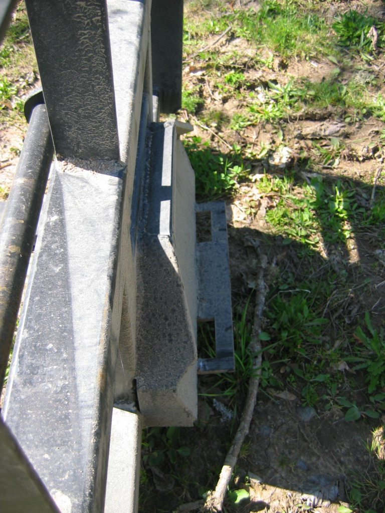

You need to ask ksimolo. He turned me onto a company that provided both of us pallet forks, loader bucket and backhoe arm. Problem was the guy did not attach the plates correctly to Kens gear and Ken had to rebuild his qa plates to get the proper angle. I think it is like Peter said, around 5 degrees (I was thinking 7.5 but what do I know as I am not there).
With pallet forks more is not a bad thing. You want pallets pitching up not down so the more of an angle it won't be an issue...
Here are pix of what the Lackendar did with my bucket and pallet fork

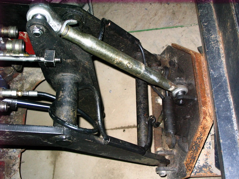

I replaced the fixed "tilt bar" with an adjustable top link. I messed up when welding the new plate on the bucket - got the angle wrong so it did not dump enough. It would be nice if these had a larger range of motion.
Ken

Here's the picture that you asked for, Carl. It is a simple swap. It does give you some adjustability.
Ken

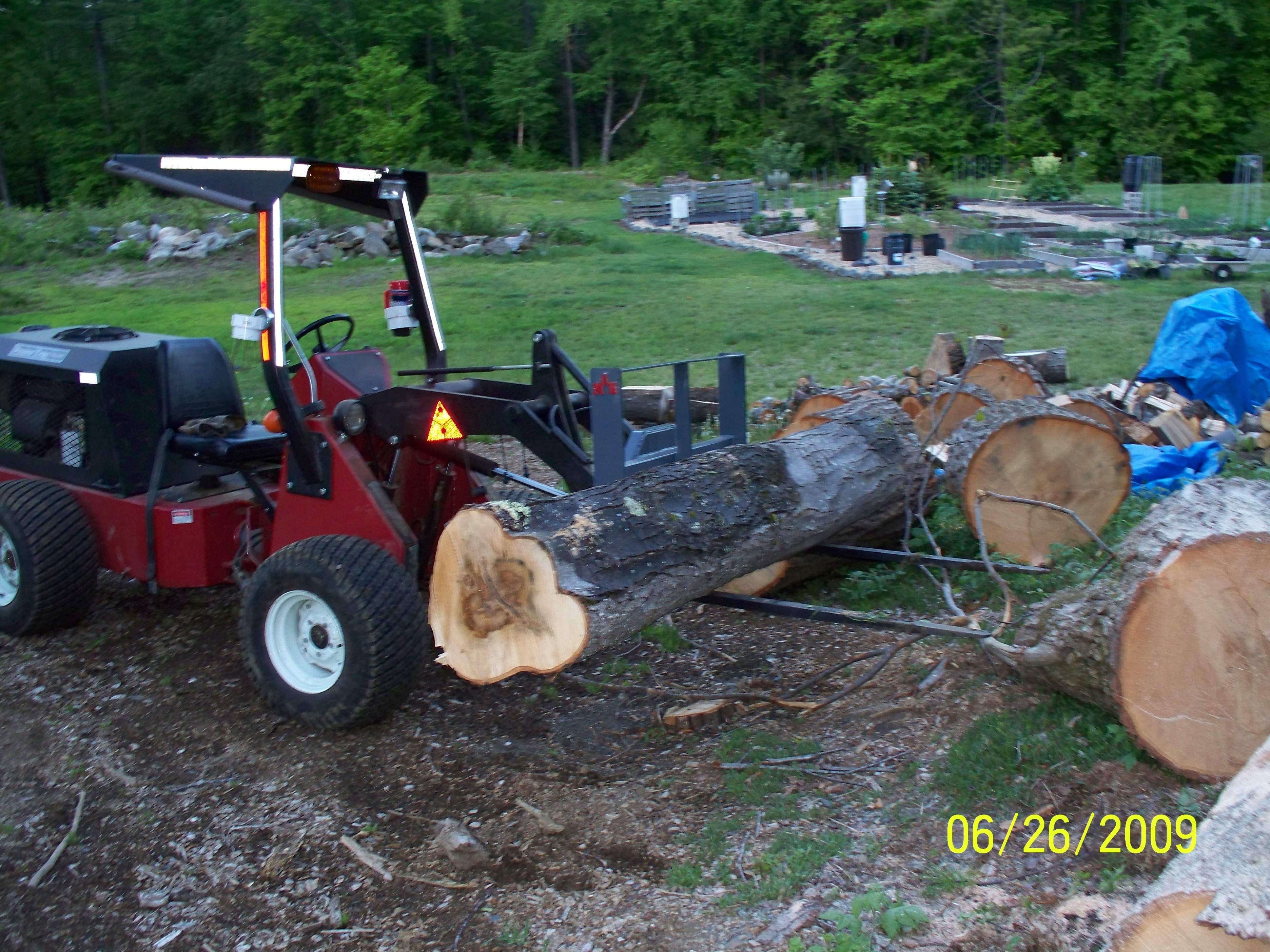

well i finally got the fork lift attachment from the company i posted about. They are rated for lifting 900lbs which i think will be enough for me or my wife to lift stuff with. It cost $400 for the forks and back $165 for them to weld the QA plate on it and $125 for the QA plate so for a total of $690 i got a decent set of forks. I have used them today to move some logs that i will use for firewood.

they are 42" long. long enough to handle a regular pallet
