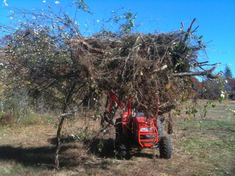

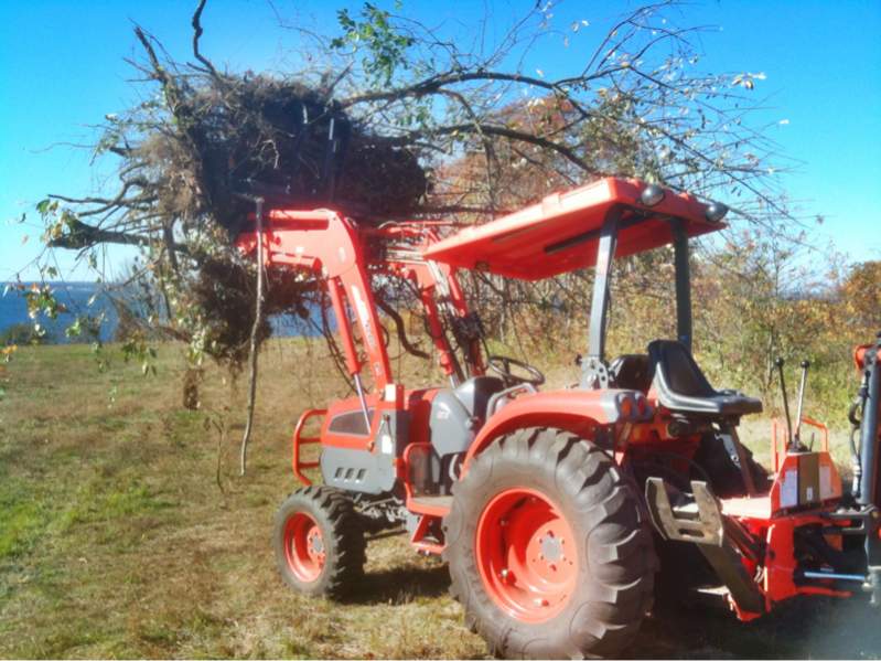

I have a 48 inch light duty grapple on my Kioti DK40se which is about the same size as your Mahindra. Light duty cheap grapples work beautifully on CUTs. Spending more IMO gets you pretty much nothing except lower net lift capacity. I have a no longer available Millonzi but the Markham/Gator is pretty similar. Lots of happy TBN customers too.
The ANBO is certainly a good grapple but I think it is overkill and unnecessarily high tech. You want mild steel so you can heat and fix it without weakening the steel. There is no benefit to extra weight or fancy steel for a grapple on a CUT.
Here are examples of what I did today with my five year old $600 280lb grapple. What can the ANBO do better?
