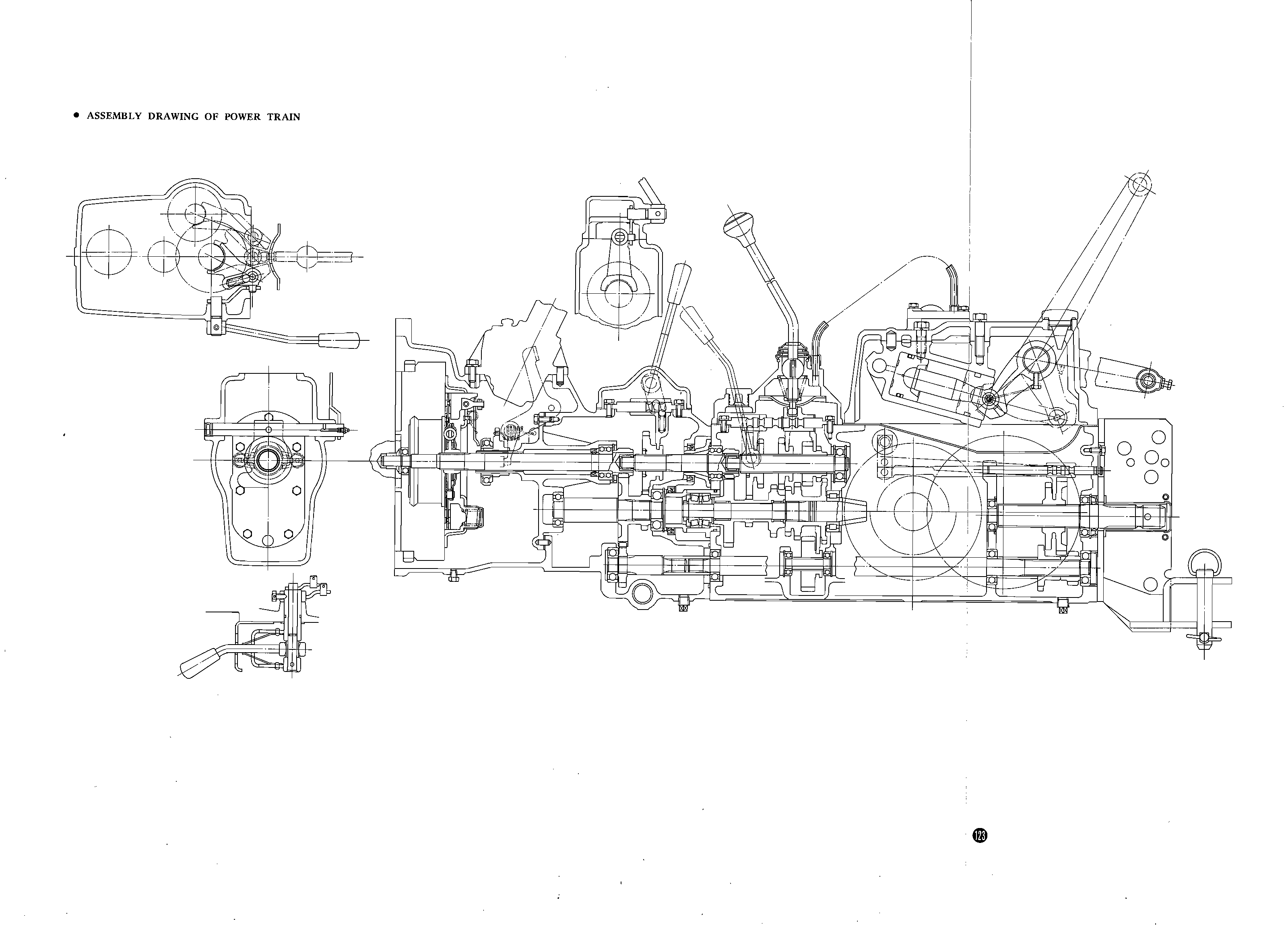

Hello everyone !
I've recently bought a TS1910. It seems to work well, it's really nice. But I would to know what is the pipe on the picture for. Does someone know ?
I didn't find anything in the manual about this. I worry because it was partially removed when I bought it.

Can you take a photo from the other side? I don't think mine has that pipe, however its late now. I'll look in the morning.
I notice that in the owners manual, the diagram for the TS1910 seems to show it, whereas for the larger TS series, it isn't shown.funnypipe.png

It may be a breather hose-- mine has one also connected the transmission and apparently hydraulic fluid reservoir, though it is routed differently. Why it is designed that way, I don't know.
The powertrain schematic in the repair manual is general for both, and also shows that sort of hosed connection.
/ An unknown pipe on a TS1910 #10
When you push hydraulic fluid into the hydraulic cylinders, there must be a corresponding amount of air go into the "tank". The tank consists of your entire gearbox. Several gallons of fluid is stored there not only to lube the gearbox but provides a reservoir of fluid for hydraulic operation and cooling. If you didn't have an air vent the system could not work. The reason for the "odd" vent configuration is so that water cannot get into system as the air vent is pointed down with the odd configuration of this hose. Some other manufactures just put a little rubber "shepards crook" under the seat. Kubota would be an example of that. This manufacture did it a little differently, but the result is the same. Kioti does it with a shepherd's crook on the fill port. So cylinders extended, air goes in this hose, cylinders retracted air comes out of this hose. This is also why water builds up in your hydraulic fluid over time as the air contains moisture and will precipitate out when the "tank" cools. But if you run the tractor enough to get the fluid hot, that water will boil off and go back into the air to be expelled out of this vent hose.
Where could I find the pdf of this manual ? I have got the owner manual but not this one. It could be helpful !
