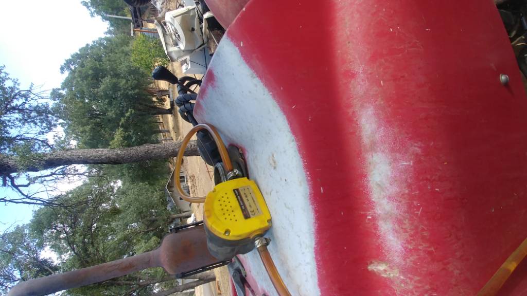

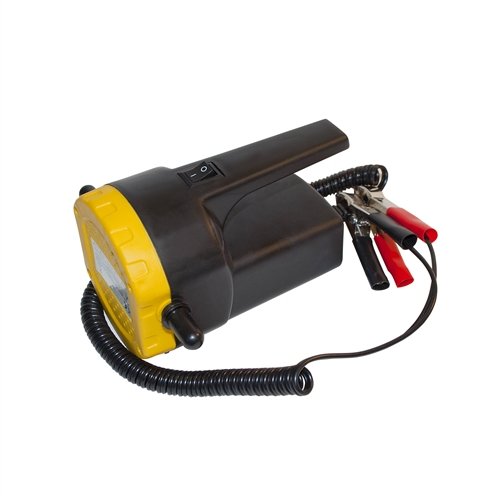

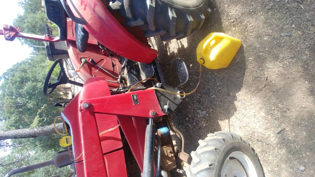

This is what I use pumps 5 gal in about 3min. As you can see in pics will pump from ground level up to my tank between 5 and 6 ft from ground no problem, I just connect it to tractor so I can use it anywhere. Listed on Amazon at $16.39. I have been using it 3 or 4 years only problem tubing is starting to get a little old and stiff.
Anauto
Acouto DC 12V 60W Transfer Pump 250L/Hour Fluid Oil Extractor Suction Diesel Transfer Pump for Car Motorbike Quad

Looking at your pictures it may work better with the pump lower closer to the jug,
most pumps will push much better then they suck.
   / An easier way to refuel your tractor #278
Tried it both ways doesn't seem to make a difference, it's a positive displacement pump

I bought that sucker for hydro fluid. Said it would pump engine oil at a rate of .8 gallons per minute. I figured that was optimistic but it's easier than pumping myself. 30min later it had pumped less than a gallon. So while it might be ok for diesel, definitely not for oil.
