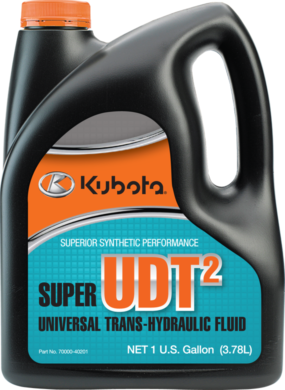

I changed the hydraulic fluid in my New Holland TC45DA from what I expect was factory original to TSC Traveller Premium UDT. I'm not entirely happy with it - until the tractor warms up the loader groans and moves weak/slow on the cold fluid. It didn't act this poorly in past winters.
While I consider the TSC fluid a "mistake" it did give me an appreciation for how this tractor doesn't like cold, viscous hydraulic fluid. So I'm going synthetic, at least synth blend.
I believe Super UDT2 is a synthetic blend at $21/gallon. Amsoil Tractor UDT is a full synthetic at $30/gallon. Is the Amsoil worth more?
I'd compare specs but Kubota uses secrecy to scare customers into buying only their fluids.

I don't know what was in my New Holland when I bought it. It was new fluid, but cheap stuff, I'm sure. I bought SUDT last week to replace it. The three point moves much faster in cold weather and my hydraulic pump is quieter. Also, the HST is happier and warms up faster.
As I understand it, SUDT is synthetic. I would have bought the Amsoil, because it lists the NH spec, but i found similar pricing to you. In my case it would have cost an extra $100 to use Amsoil. Everything I've read about the SUDT made me feel comfortable using it, and my NH/Kubota parts guy agreed that it was fine

I'm pretty sure UDT & Super UDT2 are Dino oil, not synthetic. 2 might be a blend but I'm pretty sure it's not pure synthetic. Pretty established it's quieter in Kubota HSTs & likely a bit better on cold startups. I ran 2 in my old L3200hst & will run it in my new L4060hstc when it's due for its first service. Think it comes with 2 from the factory, possibly just UDT though.

"Superior Synthetic Performance" is what it says on the bottle. Also, here it is listed as a synthetic fluid: Kubota Super UDT2 Synthetic Universal Trans-Hydraulic Fluid (1 Gallon) 70000-40201
Honestly, I don't know if it's a synthetic or a synthetic blend, or a dino oil with "synthetic performance". I'm inclined to believe that it's synthetic, but if someone has a cut and dried explanation of its composition, I'd love to see it.
