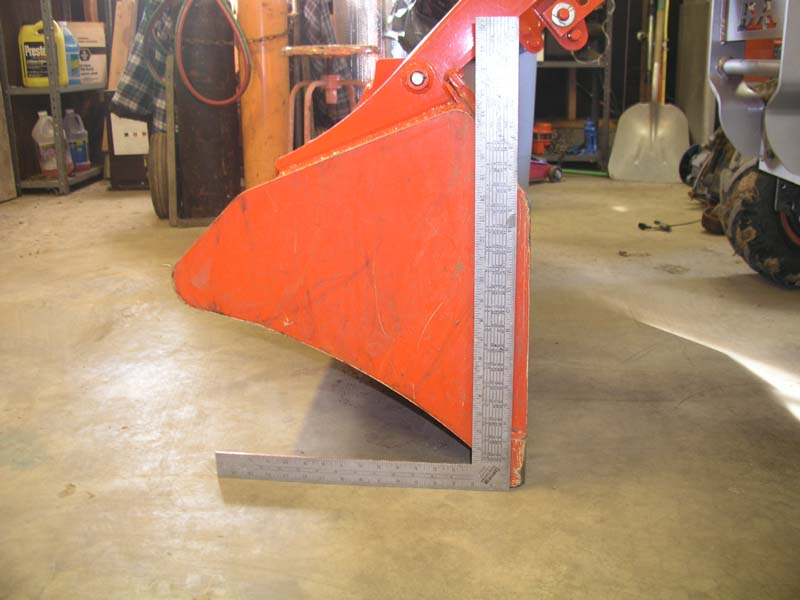

Anyway the first thing to do is lay out where the side plates go on the bucket. They should be square with the bottom of the bucket side plates so its best to put the bucket to the dump position and use a framing square. One hole will actually be outside the bucket and under the top lip.

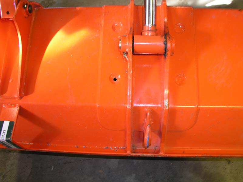

While you have it in the dump position you can drill the quick disconnect bracket hole in the top right(as if you were sitting in the seat) plug weld where the bucket cylinder is mounted.

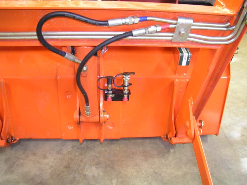

I then removed the loader to get better access to the hydraulic lines behind the loader cross and bolted the quick disconnect bracket in place.

Then I proceeded to hook up the lines. The valves are numbered and kubota color codes the lines so Jeff is going to have step by step instructions on how to hook them up exactly. I was guessing and I still have some playing to do to get them to lay exacltly right.
