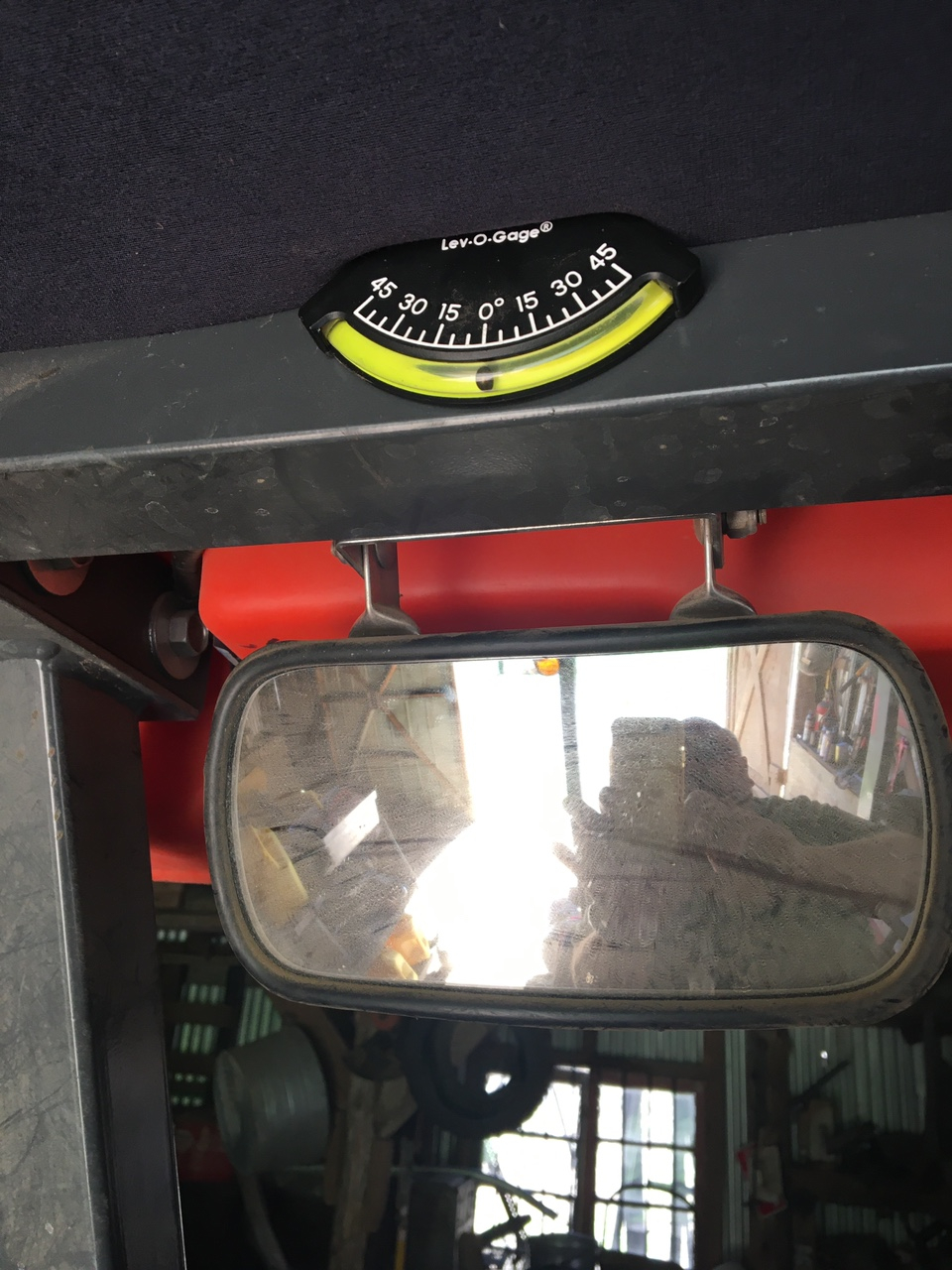

So many factors influence stability. Over 15 causes concern and watch my loading and implements. 20 slow and small moves. No batteries and always on and onboard. Second one does inclination. Wireless sphincter connection.

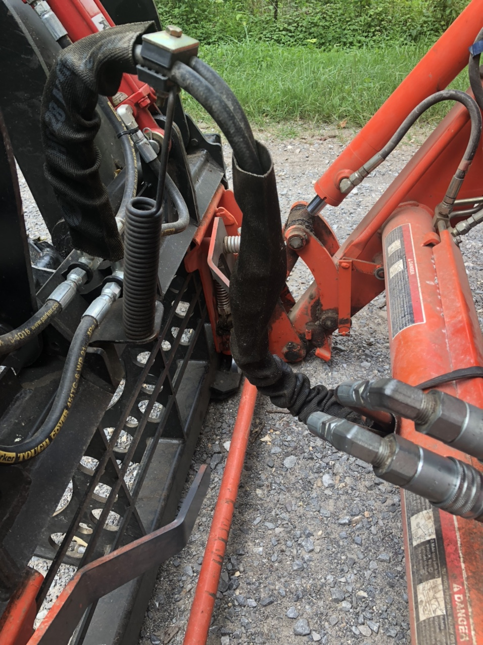

Commercial and better loaders use a link or four link curl arms to improve articulation and power.
