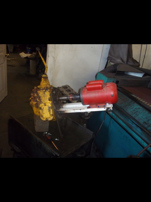

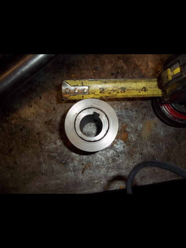

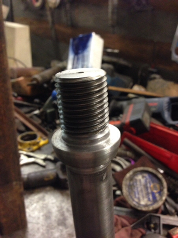

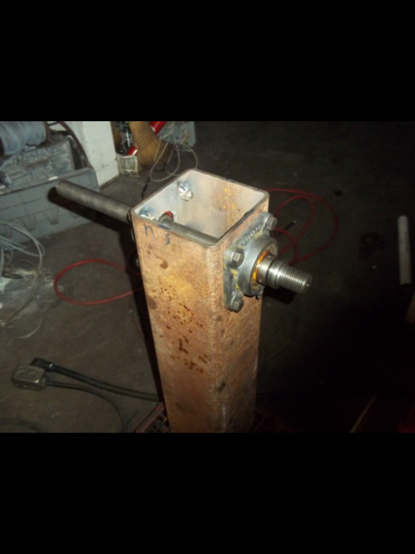

I had a similar idea, and I posted it on a wood turning forum and a was told it was a stupid idea and I should learn to properly balance a blank ( maybe in nicer terms, but same meaning. Here are the pictures. If anyone has any questions just ask. First picture is the bed without the legs attached. Second picture is the power plant. I thought the transmission was I great idea. Third picture is the salvaged and modified tailstock. Fourth picture is the spindle threaded 1-1/4-8. Fifth picture the locking bushing for the tool rest. Sixth picture is the headstock before I capped it. Seventh picture is the tool rest without the locking handle attached. The correct term for what I have incorrectly called a tool rest is a banjo, but I didn't know how many non wood turners would be familiar with the term. The whole lathe is built from salvaged junk and I have less than $200 in the whole thing. I apparently don't have a picture of the whole thing and I will take one as soon as possible.,
