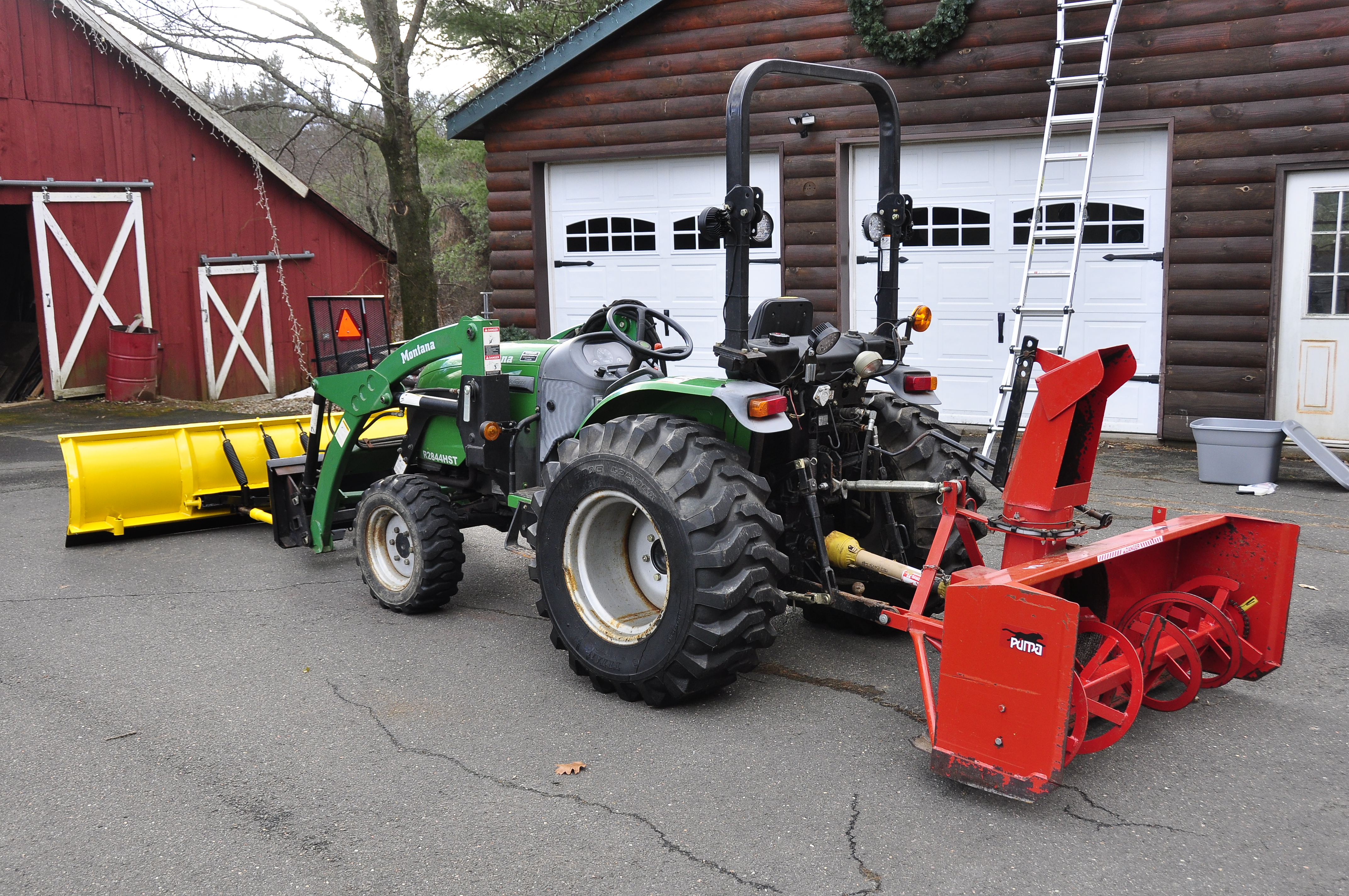

Buy an old truck plow and have a welder attach is to a SSQA plate (assuming your JD uses SSQA). I’m one of the “very special” with a plow and blower on an open station tractor. Built my plow for a few hundred bucks. Just bundle up when I use the blower!
