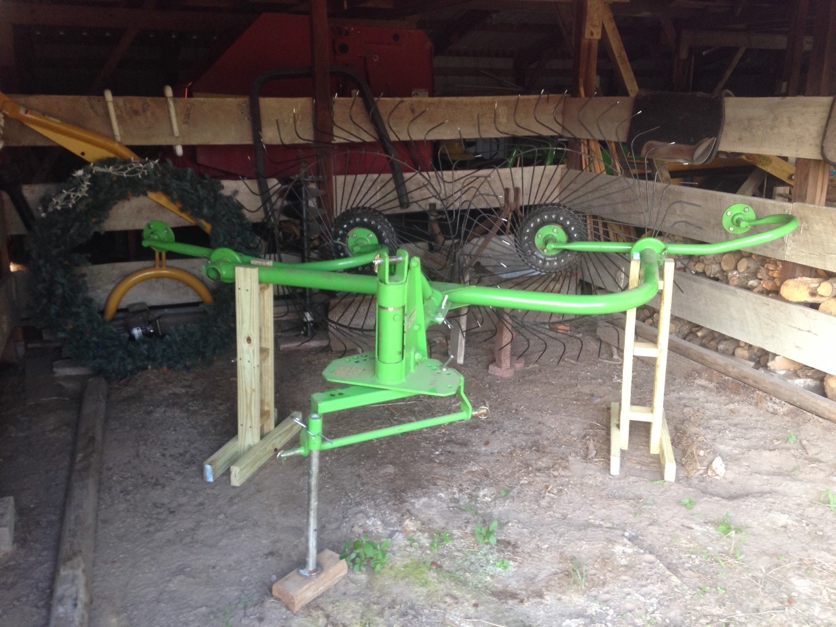

I built some stands. With all four wheels attached, the front wants to rare up when you detach it. I took two wheels off and it has just the right tongue weight to keep the front down and it makes it easier to get in this stall.

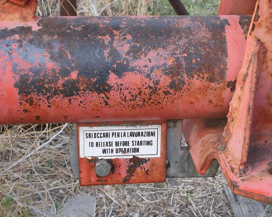

on the rake balance do you have the pivot pin locked ?
Yes sir.
I wished the two J arms that attach to the main J arm were able to undulate more than they do, but they are pretty much latched into position. Remove the latch and the arms will fall off.
