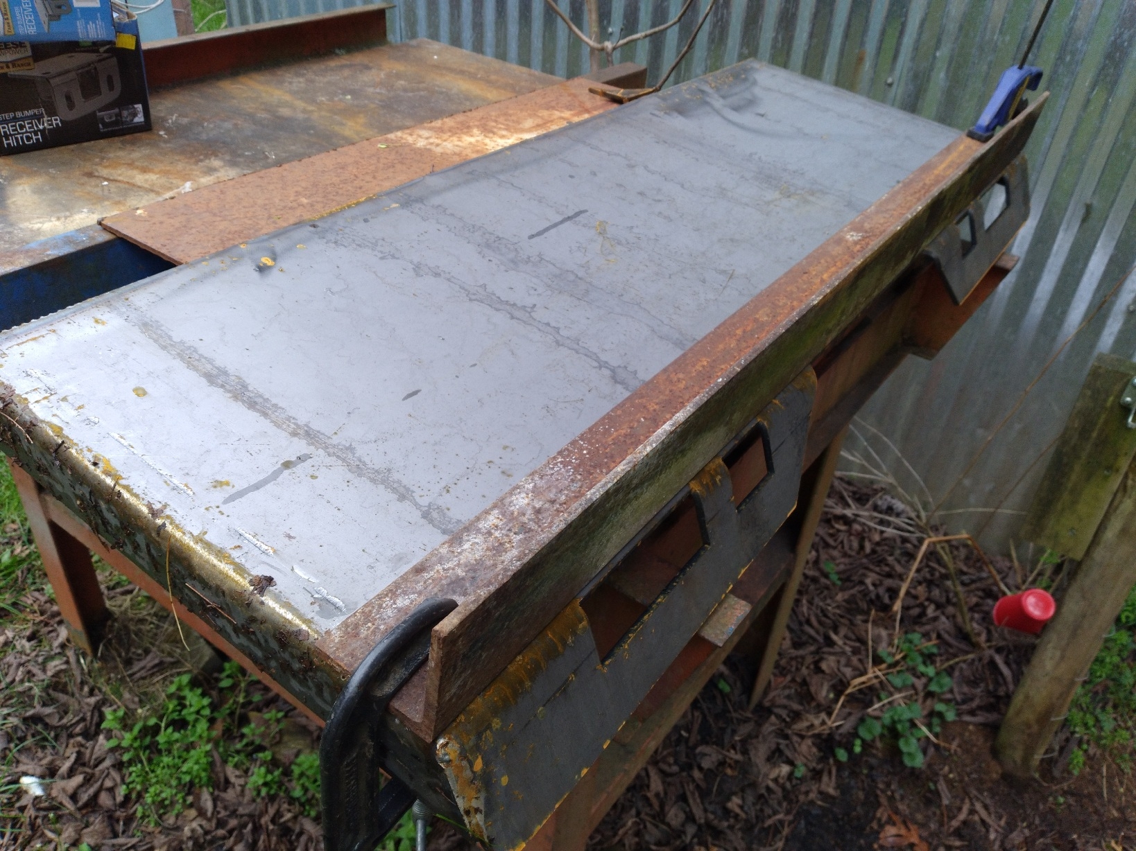

So I grabbed a couple of these 1/4" plates for cheap (I can't buy the steel, cut it out ,bend it and weld it for the price I have paid between $95 and $119 shipped! Free to me.

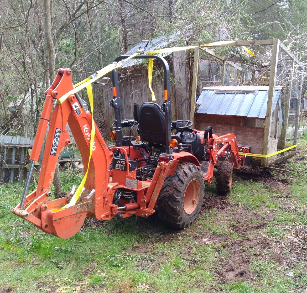

So I needed to move the older chicken coop about 500 ft
I tack welded a piece of 1/4" angle iron on the front of it.
Then used a Piece of 3/16 tubing to spread the load out. A couple Ratchet straps and walla...

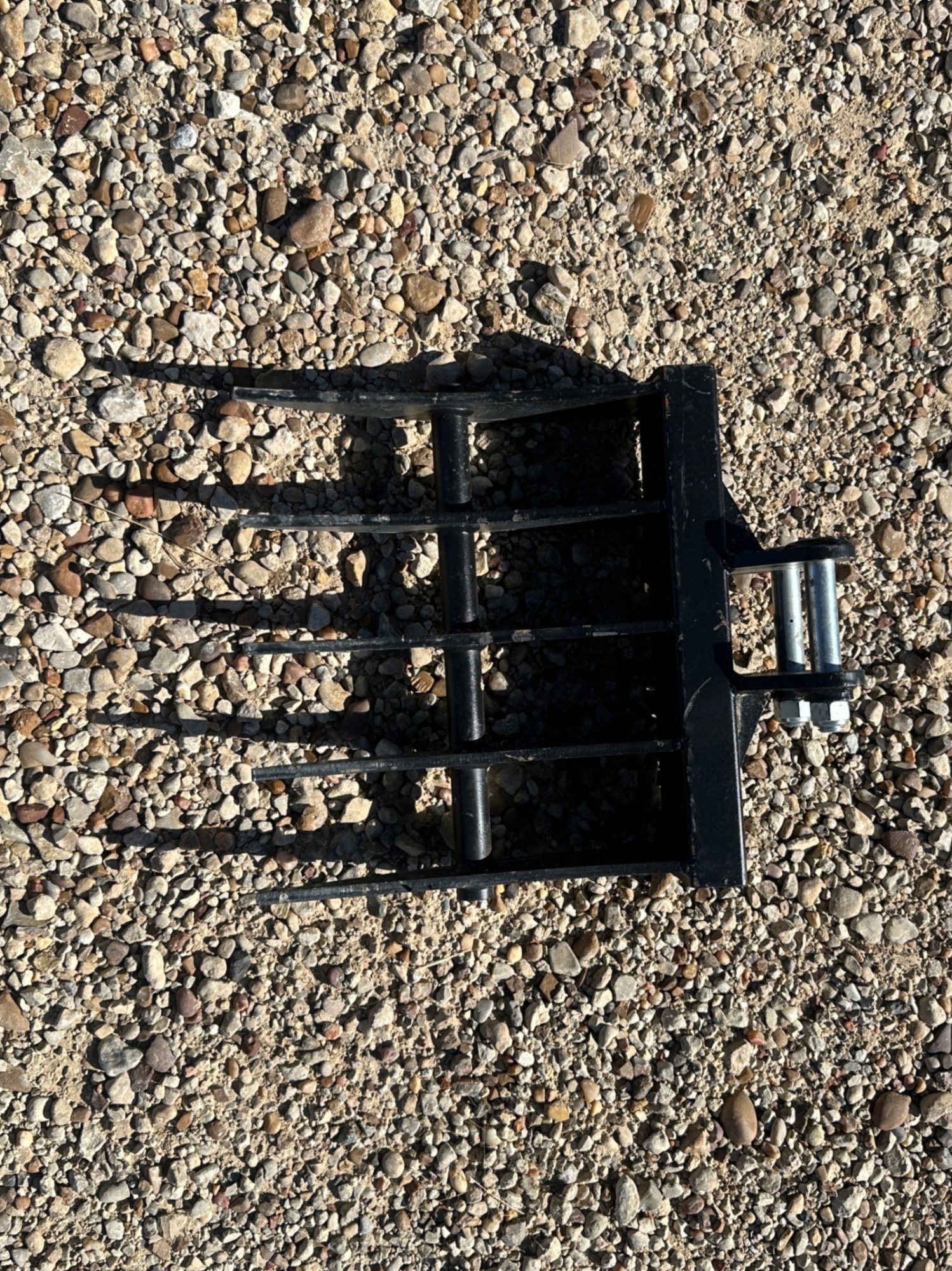

I will grind the tacks off and use this one today to make a custom rake.
These plates let you use the pivot point or real close, for maximum lift capacity
