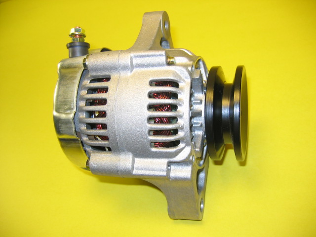

The hot rod world is dealing with problems like this for ages. Mini alternators exist - 4" diameter like this one. You can buy one on ebay for less than $100.
But you would have to fabricate a bracket and such.

If you're the one who got the kit will you post the alternator number. I've looked and see a bunch that look like the one in the kit, many are listed as Nippondenso/Kubota.
