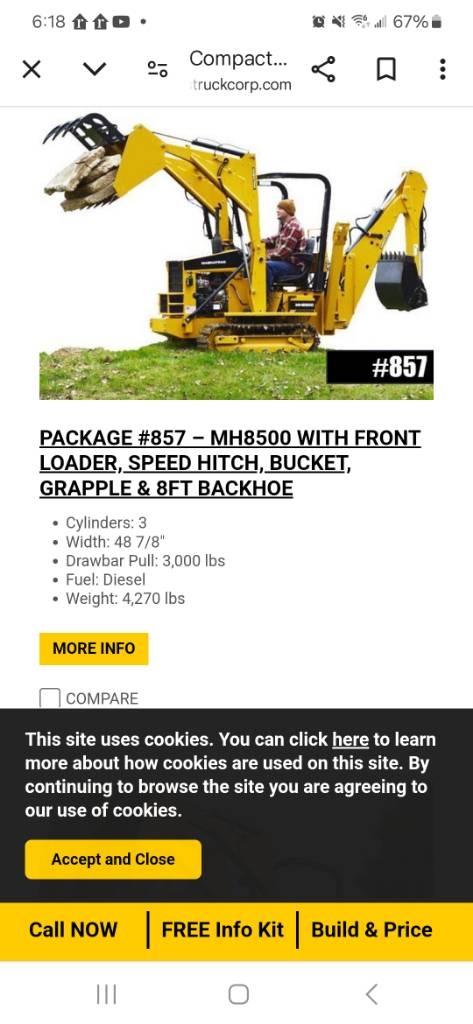

Just to be the weirdo;

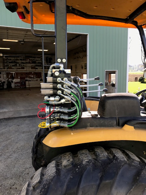

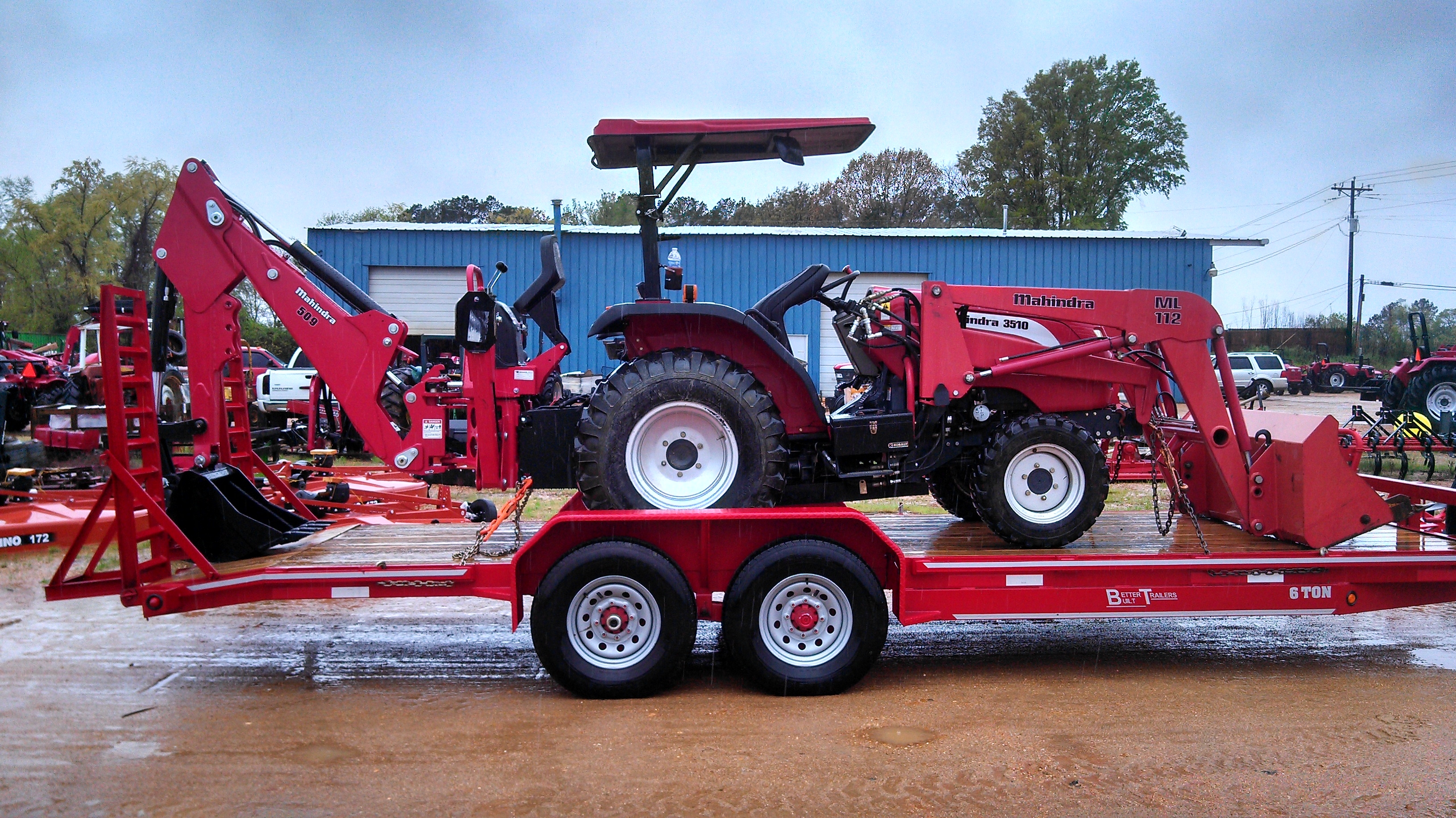

I choose to buy the correct 4 point attachment to mount a backhoe on a tractor.
I remove it maybe twice a year when the tractor needs to do something else.
It digs as well as any TLB I ever ran but it has a short reach so moves are less than 9’.
So, for me anyway, having another motor with old leaky hoses to maintain for about 3 or 4 days of use per year-
Or,
Having another attachment that will serve my needs.
YMMV
