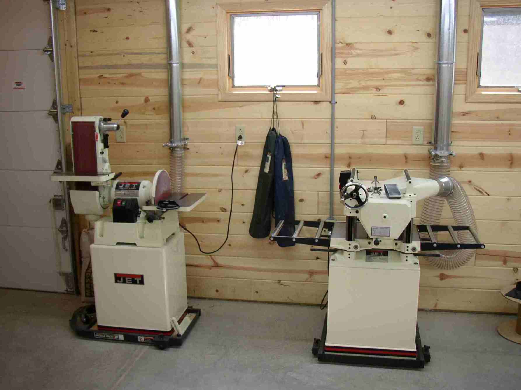

Somebody mentioned "milking parlor" sheeting, and another mentioned vinyl clad hardboard? I think these might be the same thing, and I already have a sheet or two that I use underneath my car lift as cleanable floor protector. I'll attached a couple of pix of it. Is this the same stuff? They call it "tileboard" at the big orange store.
-nosualc

The sheets you are showing is not what I was talking about. Those are as you described a hardboard piece with a smooth surface and will work well also. From experience I can tell you if it scratchs it will swell in that area if exposed to water.
The sheets I was refering to are more like a solid plastic and are completely uneffected by water. I wish I could tell you the name but I just can not remember.
