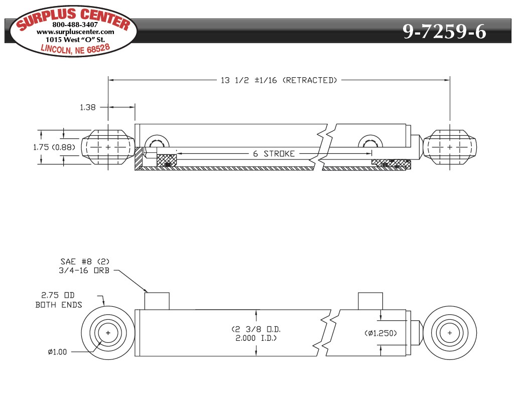

I intend to build my own hydraulic side link setup. I plan to use a 2x6x1.25 ball end cylinder from Surplus Center, cut the rod end off, and weld on the clevis from the non-adjustable OEM side link. No welding will be required on the cylinder body itself, something I wanted to avoid if possible. Total available travel on my OEM adjustable link is 4", but I'm going with a 6" stroke cyl to have a bit of leeway each direction. Hope I don't regret that. I'll move the OEM adjustable link over to the left side. The ball end on the new cylinder will be 1" instead of 3/4", but I should be able to cure that with a bushing. I won't have DPOCV on the new side link to start with, but later if I think it's needed I can get a local hydraulics shop to install one. Small form factor DPOCV's are available, but the ones I've seen are expensive at $70-$80 each. Here again, I'll post photos if I ever finish this little project.

MVR, may I assume you're talking about possible interference between the top of the cylinder and the lift arm when the lift arm is raised all the way up, as in the yellow-circled area in the attached photo?
If so, you are correct, it will be very, very close. Might even have to resort to grinding out a small half-moon from the lift arm at the touch point, although I don't like the idea of grinding ANY metal from the lift arm. Also, I might be able to gain a tad by grinding off 1/8" or so from the outside edge of the ball itself (where it rests against the linch pin), and adding a washer on the inside surface of the ball end to force the ball to ride outboard a little further than usual on the pin. It may also help that this cylinder comes with Cat 2 ball ends, which in addition to being 1" bore are also quite a bit larger in diameter than Cat 1 ball ends. If I do this I'm going to have to add a 3/4" bushing inside the 1" ball end anyway, and that gives me an additional 1/8" clearance in the critical area.
It also helps that this is a rather skinny cylinder at 2-3/8" OD, which is actually smaller than the 2-3/4" outside diameter of the Cat 2 ball end.
I'll jump through a few hoops, though, to avoid welding on that cylinder. That will be my last resort. I had another brilliant idea earlier about buying a clevis cylinder and welding a Cat 1 ball to the end of the upper clevis, which would avoid having to weld on the cylinder itself and give the ball a couple of inches of standoff distance. But if I did that, I'd have to go to a 4" vice 6" cylinder, I think, to avoid having the retracted length too long. Still thinking about that one. I could cobble up something (like fill in the clevis end with a chunk of steel and weld a Cat 1 ball to that), but it would begin to get ugly. :)
For reference, also attached is a dimensioned drawing of the cylinder in question.

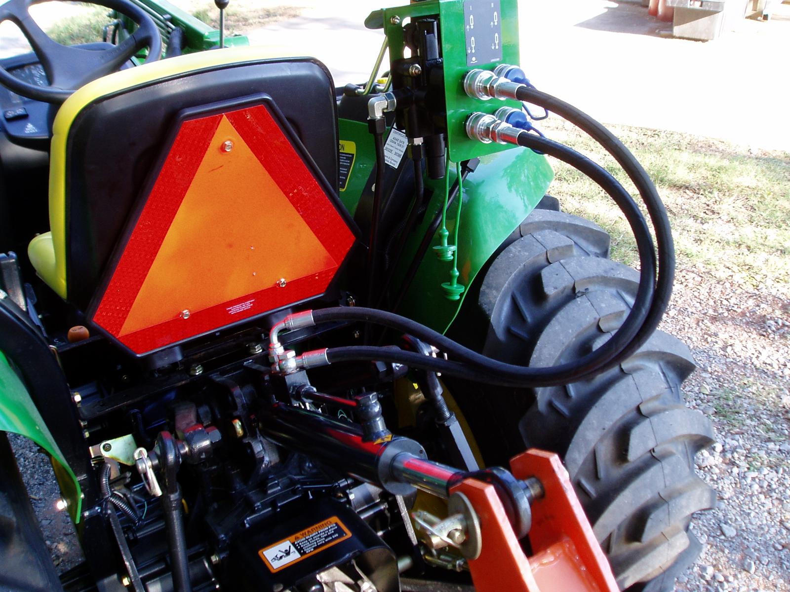

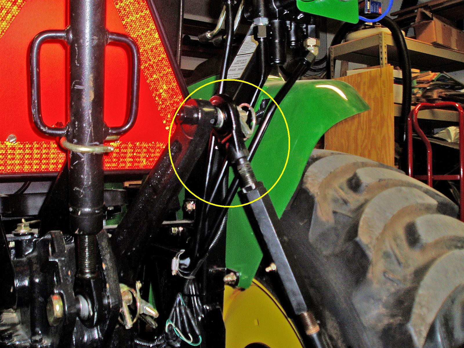

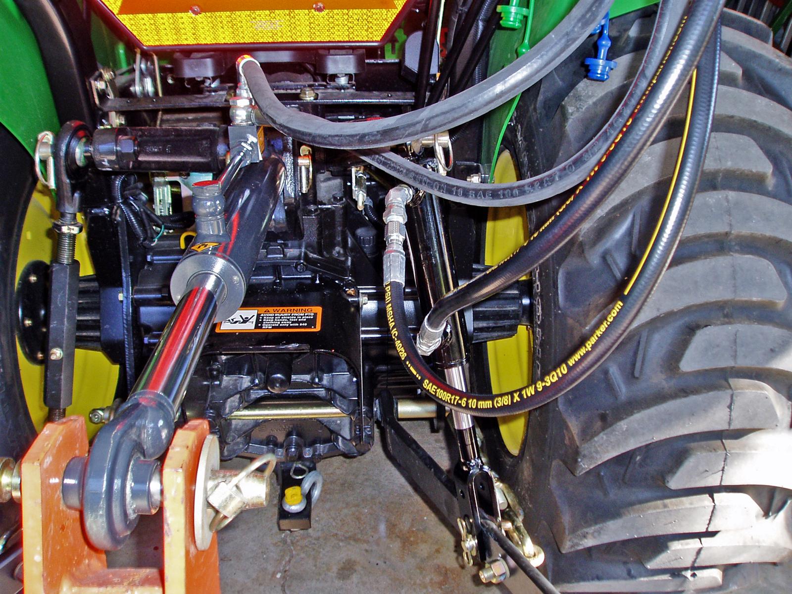

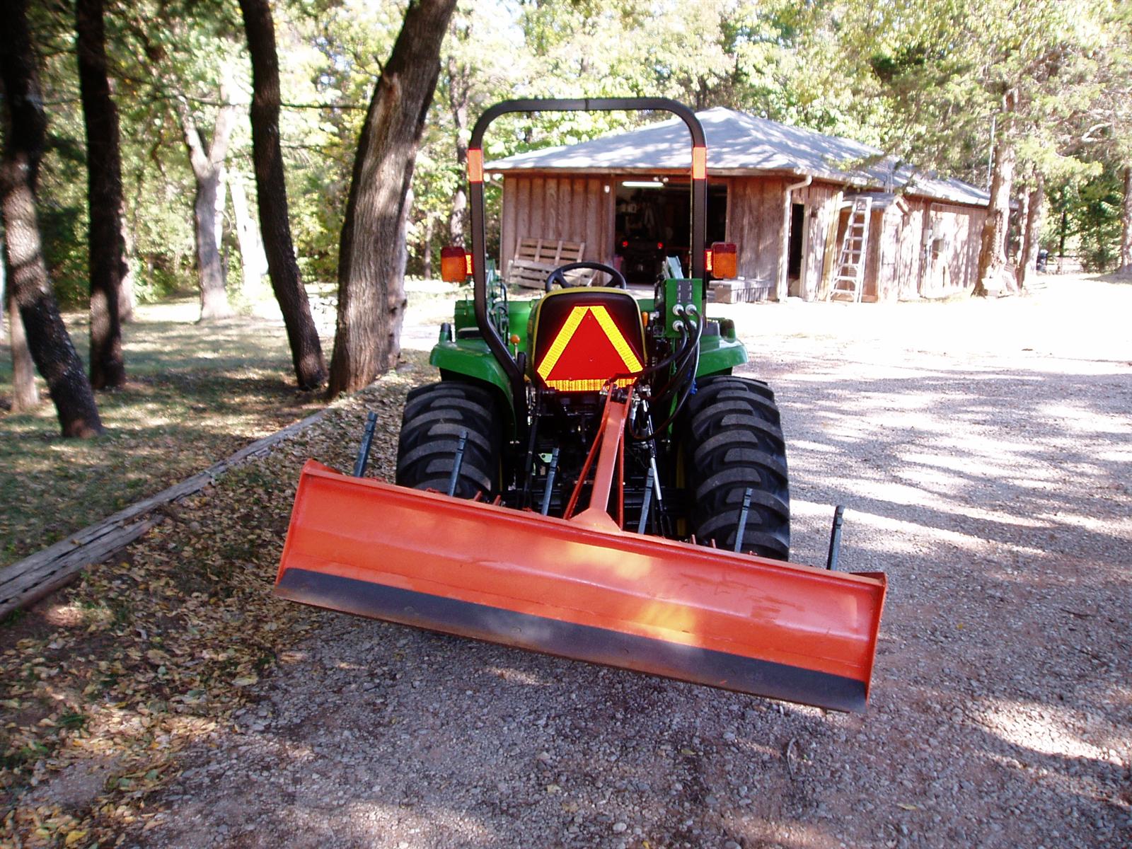

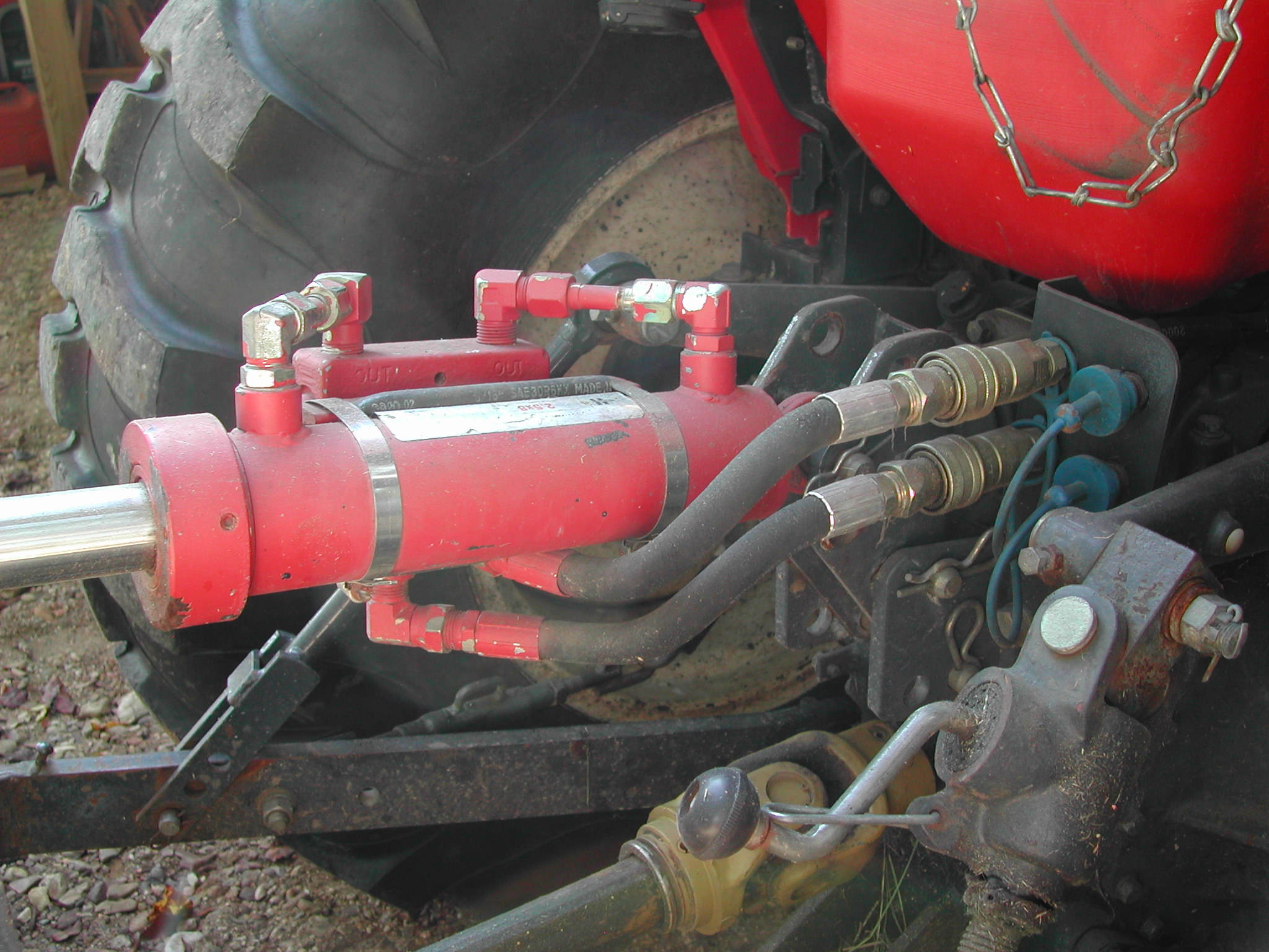

Yay. New Agristore USA hydraulic top link is installed, works great, life is good. No more busted knuckles when hooking up or climbing on and off the tractor to make adjustment when box blading. The control feathers really smooth and easy, no need for any restrictors for these 3/8" hoses.
Now to do the side link, if the cylinder I ordered ever gets here.

/ Alternate source for hydraulic top links? #11
@picker...
just curious...do your hoses clear everythng when the lift is all the way up? I had to rotate the cylinder a little to prevent jamming the hoses...?
#12
Yes, they clear fine. There is about 1-1/2" clearance between the bend in the 90 deg hose and the SMV sign at full up. However, to get that clearance I did have to remove the original S-shaped top link storage bracket. Even that wouldn't have been necessary if I had used two banjo fittings instead of one banjo and one 90 degree at the DPOCV. But I didn't need the OEM storage bracket anyway anymore, so I just took it off.
The side link will be a bit trickier for clearance in the max up position, but I think I have that figured out. Now I'm just waiting on the new side link cylinder to arrive from Surplus Center.

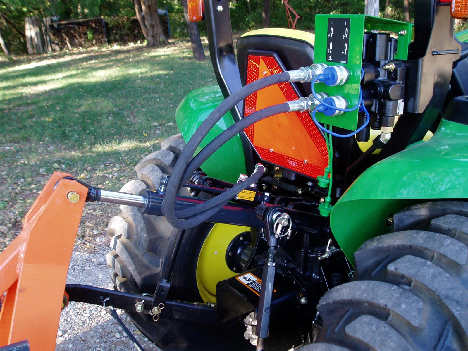

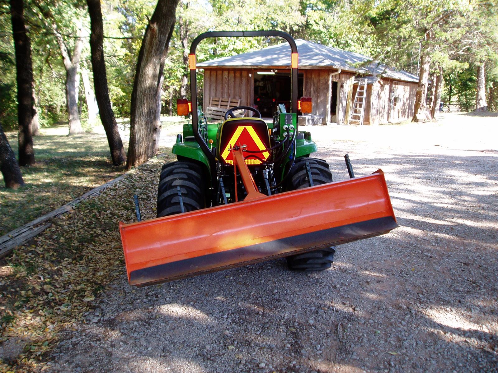

Top 'n Tilt Finished! Well, almost. I might swap the cylinder end of the two hoses on the toplink cylinder, or maybe change that tall 90 degree to a banjo fitting. It's just tall enough to scrape the middle of the SMV sign at full up and full tilt. I wouldn't have that problem if I didn't have to keep the seat slid back all the way all the time. I could just try to remember never to pull the top link all the way closed, but since I can't remember what I had for breakfast this morning I know how that would work.
Now I have to try it out on my gravel lane and get the left side link adjusted to a happy medium for the way I use it. I tried to make the the overall length of the 6" sidelink cylinder so that I'd have more tilt right than left (welded the clevis at 4" stroke instead of halfway at 3"). I have plenty of tilt, the only question left is will I need to add a DPOCV on the side link too, but I'd rather not.
Both cylinders feather just fine, but require a gentle hand on the controls to keep things slow, especially the smaller sidelink cylinder. A heavy hand will snatch that 400# box blade around like it was made of balsa wood.
After all my previous worrying about welding on the cylinder (I only had to weld on the rod end) that turned out to be a non-event. I extended the rod all the way and wrapped a wet rag around it, and it never even got warm to the touch near the cylinder during the welding process.
One question about banjo fittings... can they be removed and reused (as in swapping the hoses above) without changing to new copper rings, or is that a no-no?
