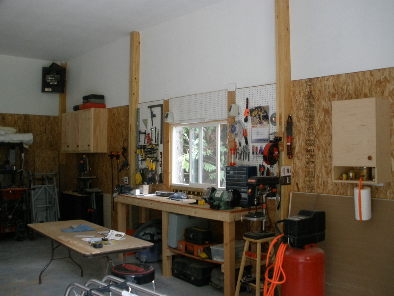

I used half-inch OSB inside my shop - over insulation. I disclose that the shop - a 14 by 35 pre-built garage - was acquired to store my furniture while I built my new house. Insulated and lined with a tight-fitting OSB, it kept at 40 through a winter with a single small, thermostatically controlled electric heater. Now its a great place to work all winter. The OSB is easy to hang things on and durable.
I took scraps from the job and built a Christmas display for our church. Painted, it set out in 7 winters in all weather and never started to soften or delaminate. That stuff is tougher than advertised.
   / Alternate garage wall materials. #34
With 12' walls I put OSB on the bottom 8' and drywall on the upper 4' and ceiling to help reflect light into my work area. It works for me, the girts are 2' on center if I need to hang something heavy otherwise I just screww into the OSB. I have 2" blanket type isulation in the walls and I blew in insulation in the attic to help hold in the heat in the winter. The thermostat is set at 40 degrees when I am not in it and I heat it up to about 55 when I am working. It runs me about $40.00 mo.
