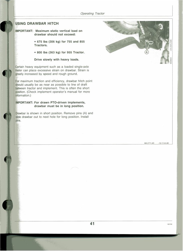

Does anyone have any literature or happen to know what the maximum allowable tongue weight is on the drawbar for a 955?
If you have the manual, tongue weight should be listed in there. Figure about 400 lbs or thereabouts.
/ Allowable drawbar tongue weight #4
The JD manual shows max drawbar weight for the 955 is 800 pounds. For the 755 and 855 it is 675 pounds.
