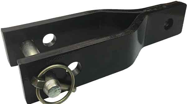

Another idea would be to use something like the this bracket bracket.jpg between the top link and the blower. Probably not exactly this, just an example I found for a visual. This would be more ridged and allow the blower to pivot but there would be a limit to how far it could pivot.
Has anyone ever tried this with a snow blower?
Does anyone see any issues with doing something like this?
/ Allow rear snow blower to pivot? #2
First thought that comes to mind for me is that would be tough on the U-joints. The angle of the snowblower input shaft should be the same as the pto output shaft angle. That way the two U-joints are working together.
/ Allow rear snow blower to pivot? #3
Something like a toplink that had a certain amount of telescoping might work. Perhaps long skids on the SB could help. You can float the blower on the 3 point hitch but it seems like you want it to have some amount of rotation. That is where the telescoping toplink comes in. If allowed too much of that rotation it could dig in.

It will be harder on the universal joints and the bearings if you do this. If your lower links can be extended that is the better way to to this.
It would be better if you just had longer skis made (the length of the side weldment plates) and just left the three point hitch in float to follow the ground.
Trying to obtain a finite adjustment for an implement that is made to be dumb, numb and stupid to do one job of snow clearing is a mistake.
You do not need a GPS unit to control the snow blower, you need to set the skid height and be done with it.
Just have longer skids made and your unit will be able to follow the ground better and avoid digging in.
Your going to wear out the cutting edge that much sooner and suck up stones and rocks if you try something like this and you defeat the bottom edge of the snow blower.

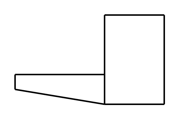

I also thought of a problem myself. This is a crude drawing of the blower blower.png
When pushing this snow as high as the blower would likely force the blower to tilt backwards because the force is applied to the bottom 1/3 of the blower box and the snow would push the top back if it was allowed to tilt.
I suppose that this could be solved by having skid shoes that are significantly longer than the blower box.
