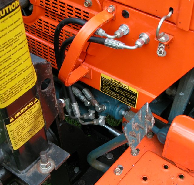

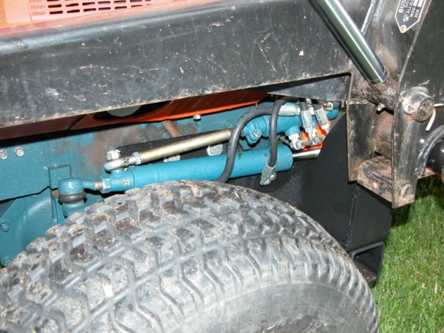

Just in case they might help, here are a couple of photos of the Kubota supplied after-market power steering kit I added to my B8200 10 years ago. The steering link was removed, and this valve unit went in its place. The valve controls the push-pull cylinder, and I believe it's an assist like what you are after. Works great, and not too complicated if I could install it.
