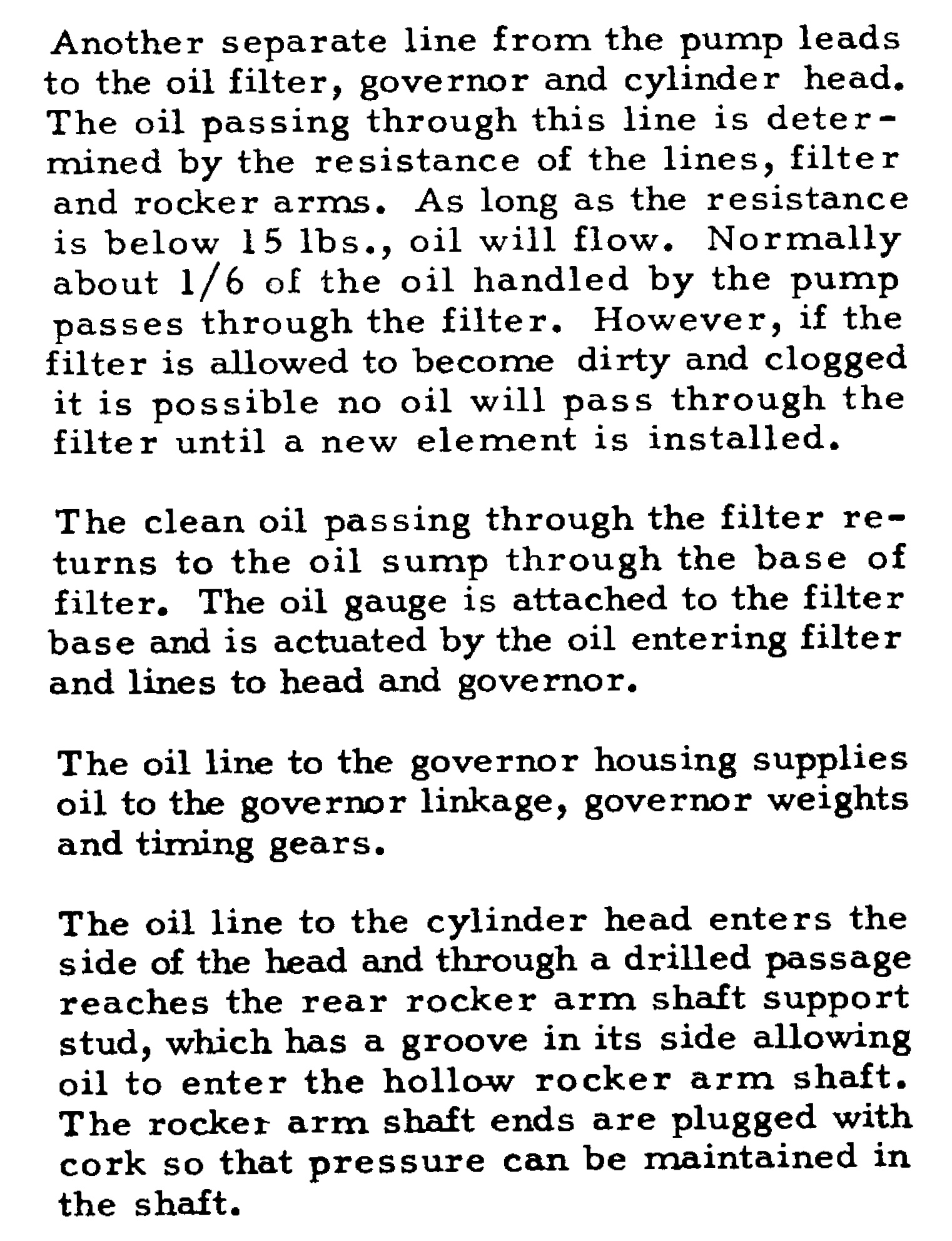

About 18 months ago I bought an Allis B with intentions of restoring. This little thing had been standing for many years outside, head off, no cover, many parts missing, all wheels and tires rotted, but I just had to have it as a "project". Wow what a project it has been. Putting it back together I find a small oil line coming out of the pump, across the rear of the engine, then forward on the left side, where it terminates. I know there is another line that connects to it but I have eihter mislaid it or it was missing to begin with. Try as I may I can't figure out where that line goes to. At this point it is terminated behind the oil bath breather. Can someone get me started on this thing again. I'm nearly to the finish line on it and would like to get it back together before my time is up.

Attached picture is text from the service manual from the B-C section about an oil line out of oil pump, this may be it but there is no picture in manual to go with it.
   / Allis B oil line a mystery to me
Thanks for the comeback Gator. This is the second time in about two days you've come to my rescue. I do remember a line going to the area of the governor but could not recall specifics. Again thanks for the info.

Could that have been a line to a long gone or optional oil pressure guage?
   / Allis B oil line a mystery to me #6
Kinda, see paragraph 2 in my previous attachment and this attachment.

Hi Stuckmotor, Yeah my gauge was in place. I found part of the line was missing with one part going down one side of the engine and the other end going down the other side. It threw me off since I had no idea what it was for in the first place. I have now rerouted the piece coming out of the governor, and spliced it onto the other end and everything is good to go. Thanks for the input. I believe your question concerning the AC D12 was meant for gator.
