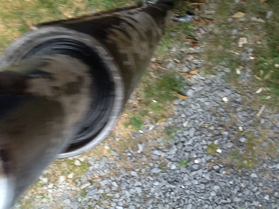

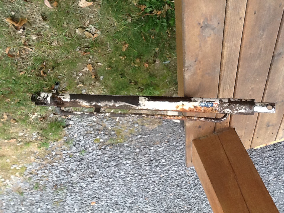

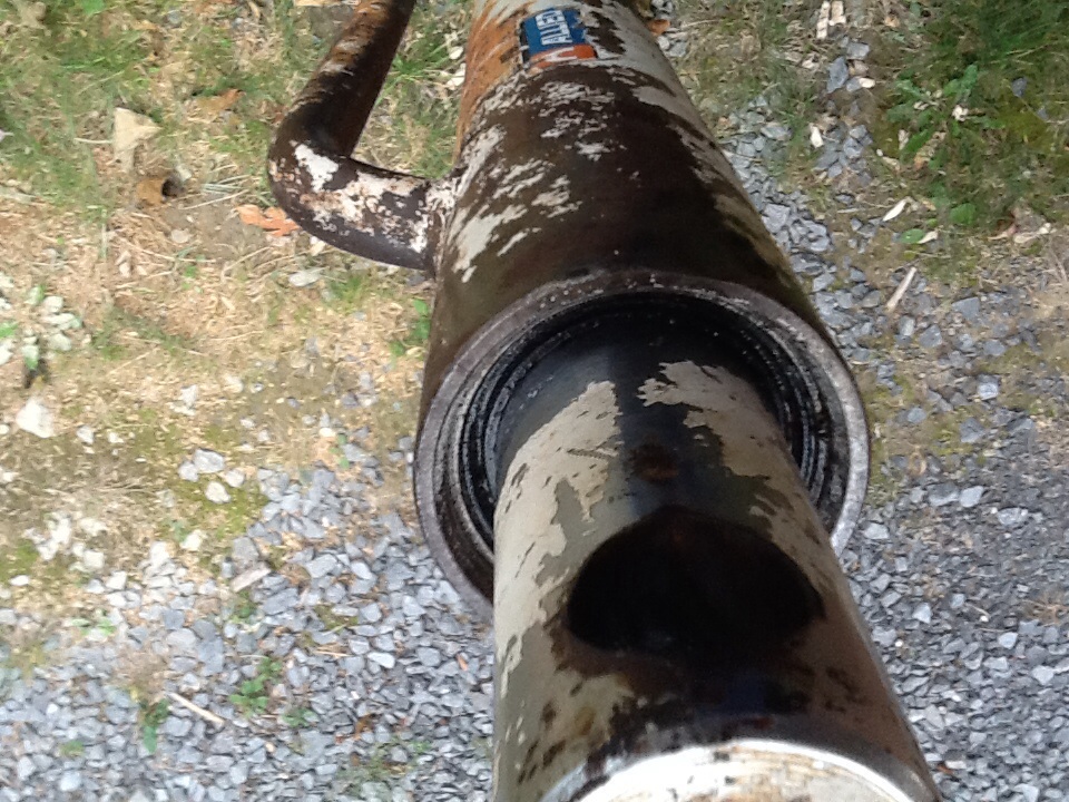

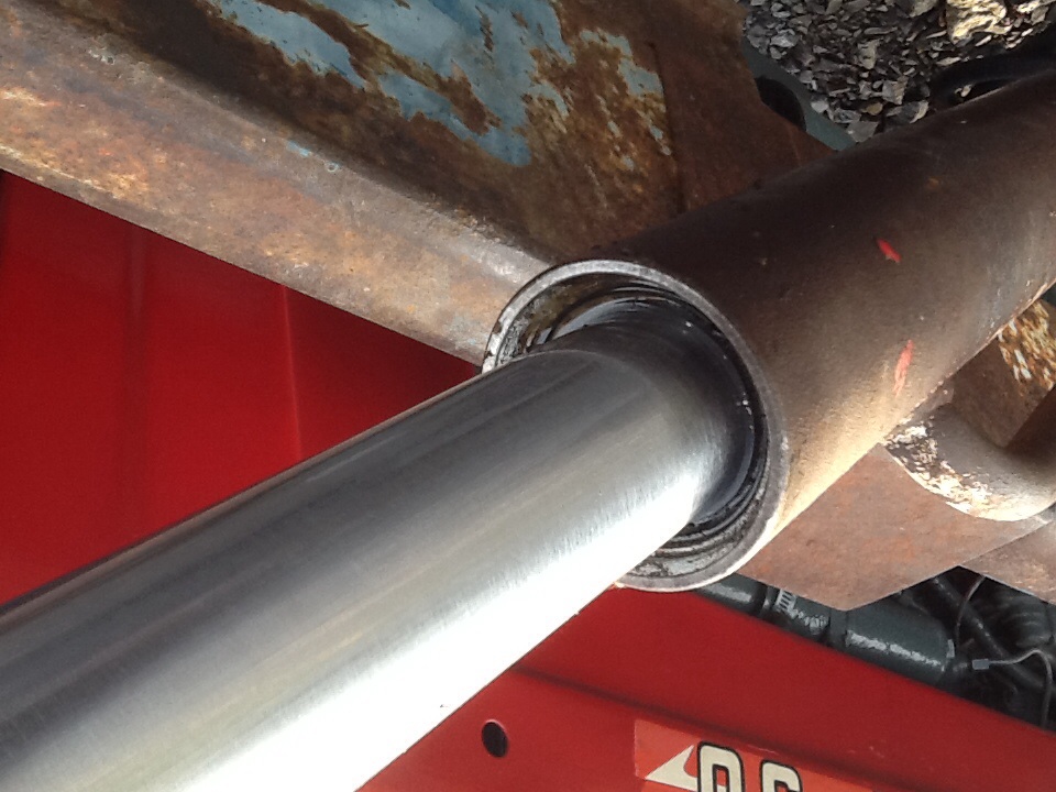

This cylinder came off an old allied loader. It is leaking miserably from the top end and I need your help determining whether it's worth the effort to rebuild it or just replace it for $150. I have attached some pictures that show the worn end, and it appears to be just a rubber gasket, no locking mechanism in view. First time dealing with a hydraulic repair so any help is appreciated.

At $150 if it is an exact match I would go that route.
That being said a good shop can OH just about any cylinder to like new.
Generally it is hard to get an exact match leaving U no choice.
Your shaft looks good so I'd suggest OH should be cheapest route to go as probably you only need a seal kit and wipers.

Ok thanks. I still don't understand how the cylinder is taken apart though as it seems like there should be a retaining lock ring or something similar. Are you saying that turning the rod would unscrew it?
   / Allied cylinder - rebuild or replace? #5
Item 12 is your retainer.
Remove it and then unscrew the head plate item 9.
I don't see a head plate - is it under the wiper?
   / Allied cylinder - rebuild or replace? #7
I believe the head plate is the part that screws out. item #9.
   / Allied cylinder - rebuild or replace? #8
I think the head plate(part key 9) is held in place by only the snap ring(parts key 14) no screwing required to disassemble.
#9
Ok I will try that, thanks guys!
   / Allied cylinder - rebuild or replace? #10
If you are looking at the cyl layout above,
Part key 14 is an o-ring. It is down inside the cyl.
Part key 12 is the snap ring/wire retainer. Whether is screws out or just falls out is ???????????
