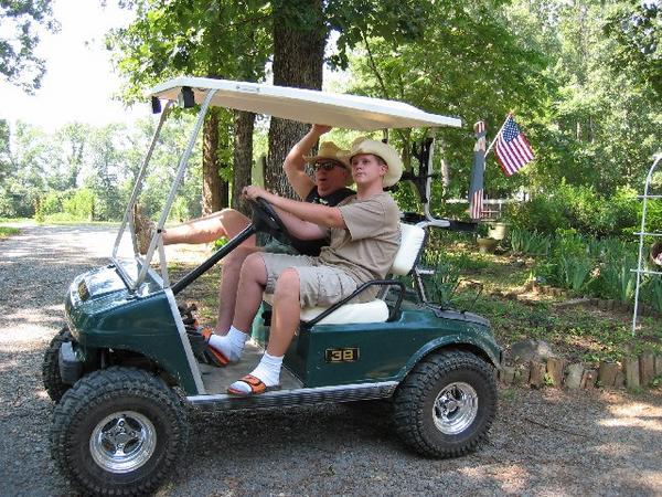

Golf cart. Electric. I bought this '99 Club two years ago for $1700. Another $650 for the 6" lift, wheels & tires. Pulls my flatbottom boat, manure spreader, or a little trailer with 1/2 rick of wood, 18 bales of hay, or up to 20 sacks of feed. And I've seen a half dozen thirteen yo boys pile on it without complaint. In two years the only breakdown has been a broken battery cable. Comfort, safety, carefree reliability. Marginal brakes are their only weak point. If you go flat out on the road the batteries will weaken in about 45 minutes at 10-12 miles. If you go slow with frequent rests it will go 30 miles no problem. Since this pic I've added a winch to the front making it the ultimate fence construction partner. I originally bought it as a temporary investment to chase off poachers and trespassers but I couldn't live without it now. I'd recommend a '97 or newer model as the solid-state circuitry that was introduced then is much more efficient than the old resistor-coil type speed control. Most carts '00 and newer have regenerative braking which is highly desirable but also very high priced.

I know this buggy might be "practical", but lose those butt-ugly schwinn wheels! /forums/images/graemlins/grin.gif
Kinda like puttin bowlin shoes on a horse. /forums/images/graemlins/tongue.gif
