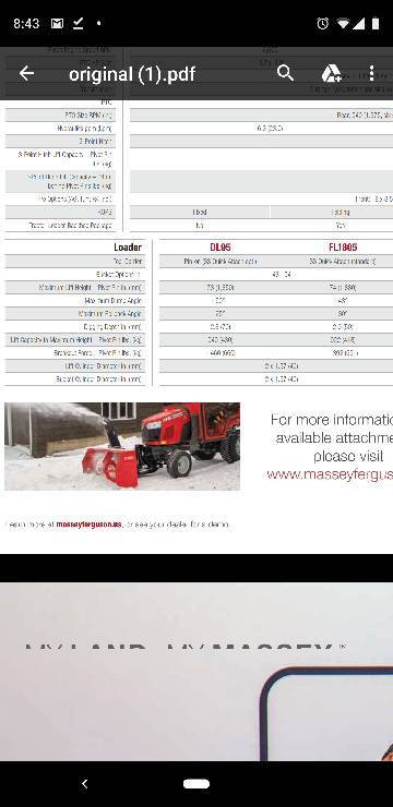

To me, other than 1" lift height gain and standard SSQA the FL1805 looks like a slight downgrade over the DL95View attachment 613567
From what I'm told, the lift capacity on the FL 1805 is rated with the SSQA installed.
The DL 95 is rated without the SSQA installed.

Makes sense

The FL 1805 has slightly smaller cylinders, which result in faster cycle times, but a slight drop in capacity.

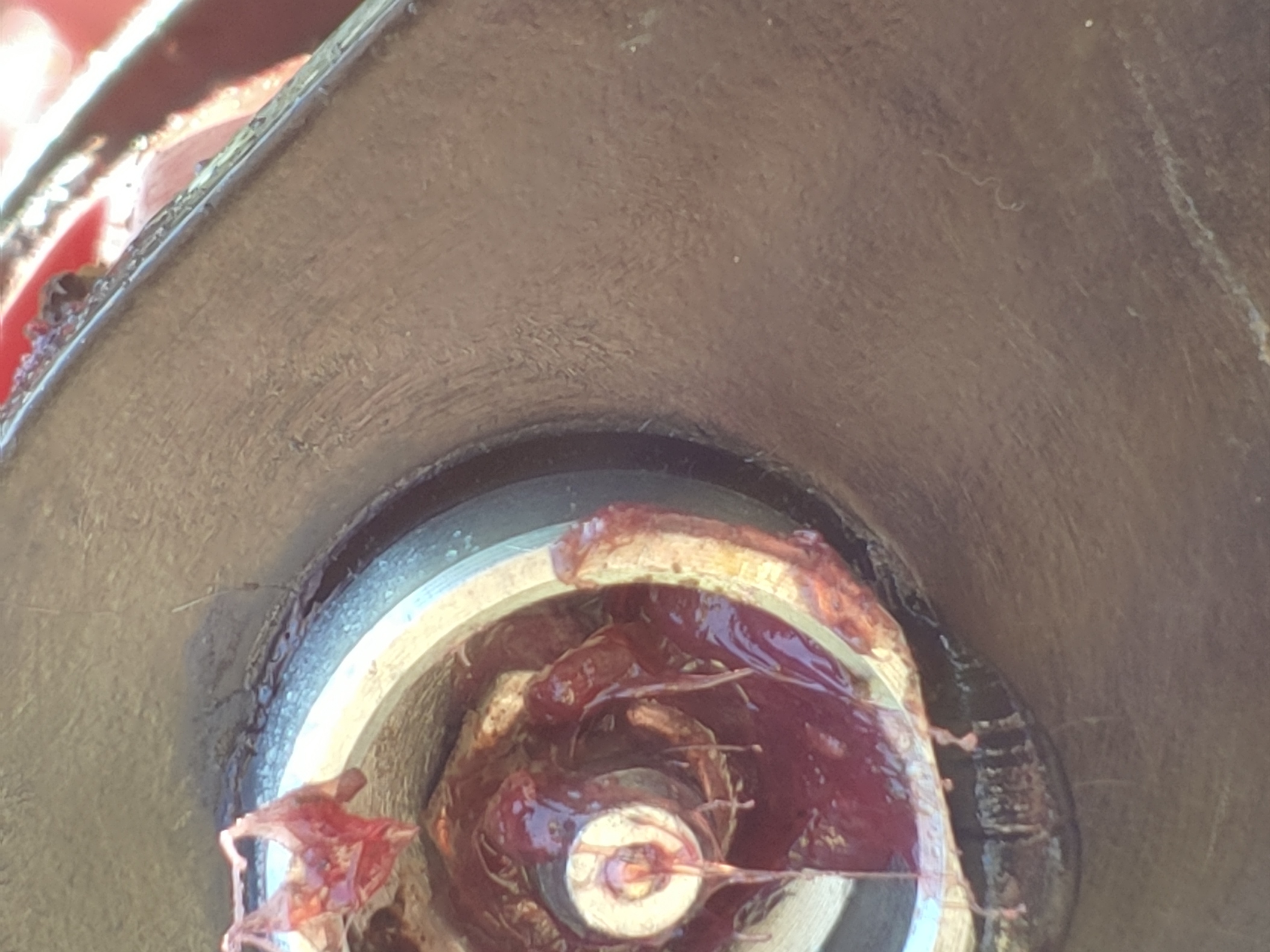

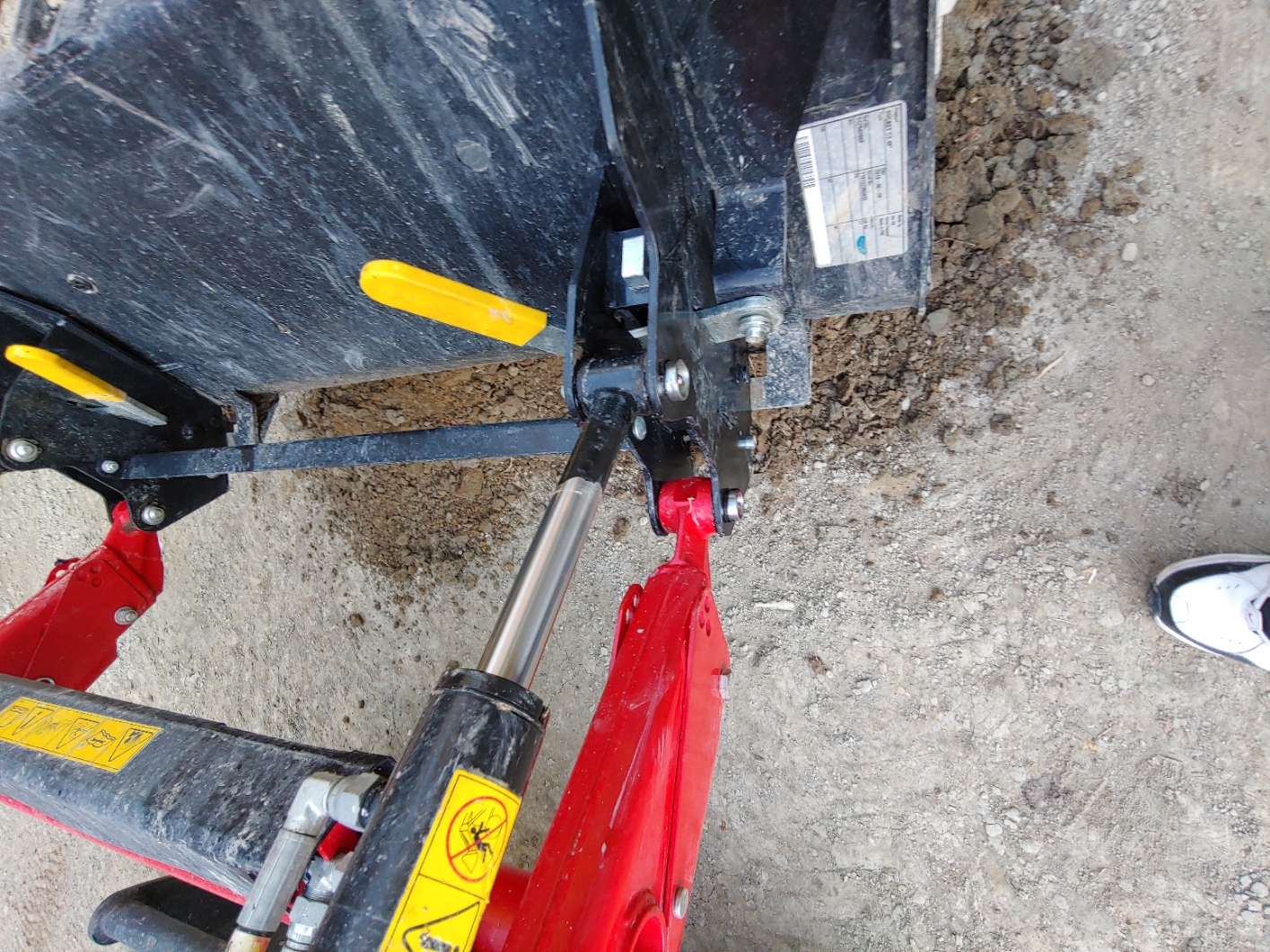

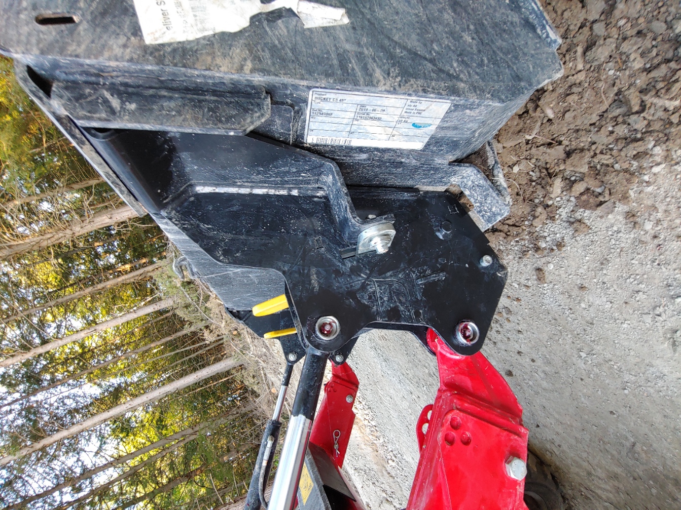

I searched and haven't seen to much on these, but I am having an issue on my new machine. It appears the pins where they meet the SSQA adapater are wearing the adapter. The loader frame it's self appears to be okay. I have quite a bit a gap at the pins with 100 hours on the machine.
