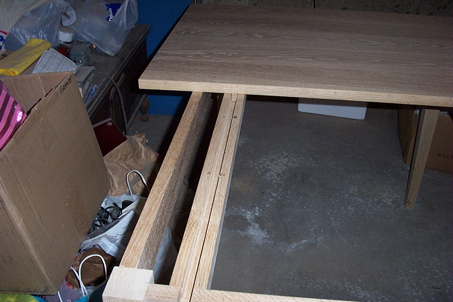

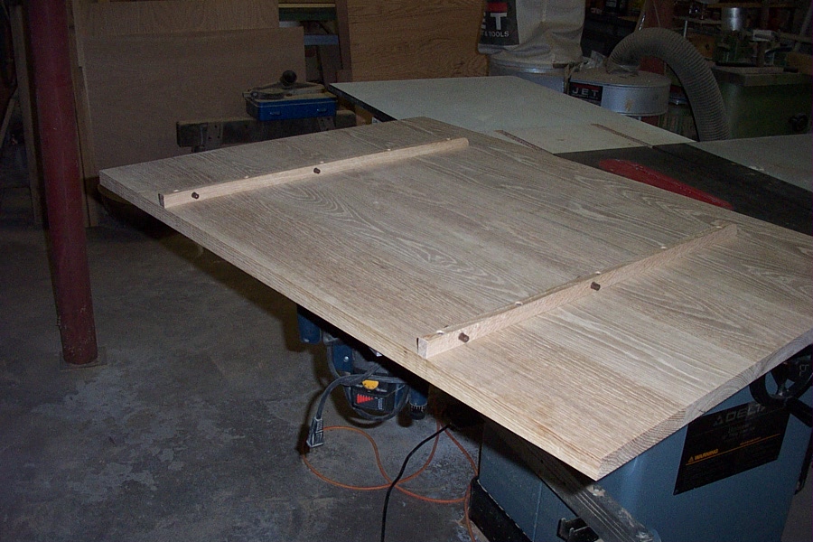

I block planed any board misalignment from the top glue up and then pre sanded both halves. I mounted the guide rails to the under side of both tops. I had some alignment issues with the guide rails in the T slot rails:( but nothing my trusty laminate trimmer couldnt take care of. :) I still have to mount limiting stops on the underside of both halves. Both leaves will be 10" wide so Im thinking of having the stops allow the halves to slide back 11" which will more than enough to accomodate the alignment dowels. Speaking of dowels, I havent put them in yet, but 3/8" with sufficient chamfers should take care of the top alignment.
First pic is the guide rails mounted.
Second pic is the T slot rails with the cutouts to allow the top to be mounted to the table.

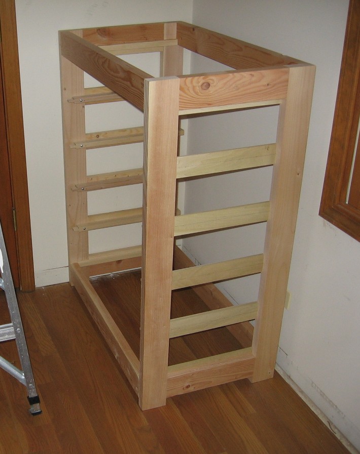

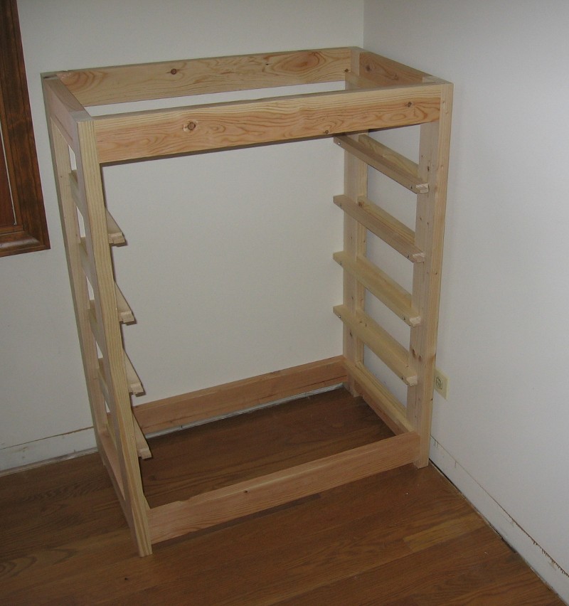

I am at the point on the built-ins that I need to move a couple electrical outlets. Around here, everything is in conduit, so that can be a pain in existing walls. Then I need to patch the walls and then see how well the cases fit into their respective corners. Then I will attach contouring strips to the carcase corners if I need them. I am also thinking that once I've fit the carcases, I will paint the room before I do the final intall. Just seems easier that way.
I included a couple photos of the chests standing in their corners. You can see the Electrical outlets are in the way of where the chests want to be.
This part goes really slowly, so I probably won't have pictures for a while, but Scotty's moving right along, so the thread shouldn't get too stale.

Looking good on the built ins ! Bad luck on that darned electrical outlet. That will definitely be a pain ! I also like your idea on painting the room before the final install. At the very worst a small touch up would take care of any small marks on your newly painted wall ;)

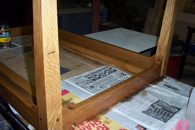

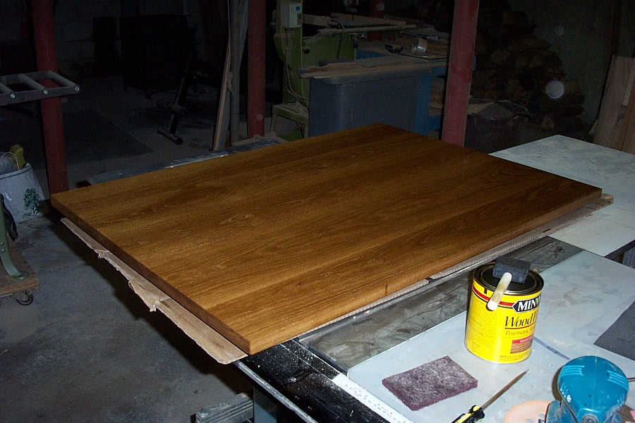

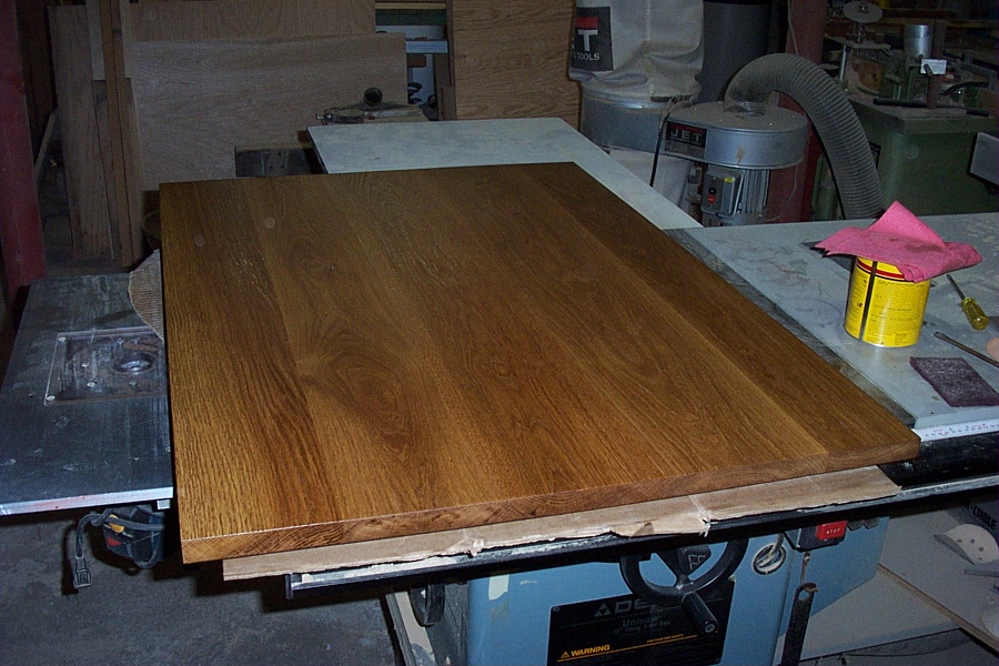

I got both table halves sanded down to 240 and then I dampened them to raise the grain. I resanded again with 240 and then finally with 320. I cleaned both tops and started staining with Minwax Golden Oak. I applied a liberal coat and let it set a few minutes before wiping it off. Im attaching a pic of one side stained.
Cliff, I think your right about that marine tung oil. I contacted a local dealer and they only sell in gallons :eek: I wont tell you how much ;)
I have decided to go with plain Watco Tung Oil, multiple coats and when all is said and done I will put a couple coats of Butchers Wax on the top.
But Im still open to suggestions ! :)
Im adding a better picture I hope!

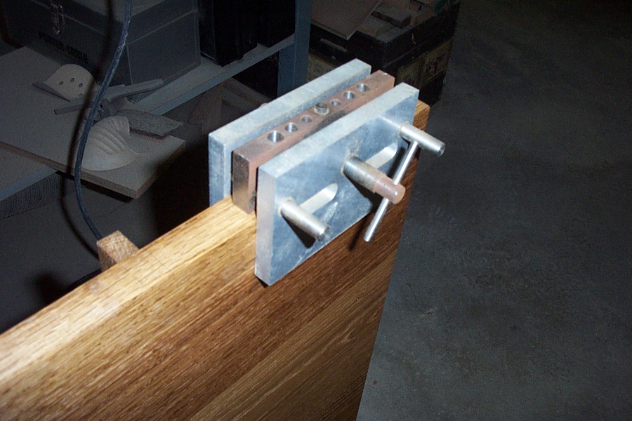

First pic is a doweling drill jig I made years ago, it goes down to 1/2" thk and up to 2" thk. I decided on short aluminum dowels for alignment rather than wood dowels which can get damaged easily. I used a knurl on one end along with epoxy for the fixed end.

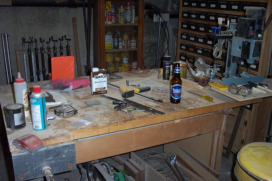

Second pic is my messy bench taking a beer break ! ;)

Ah yes, Watco beer. Strong mineral spirits for real men.
Aluminum dowels. That's a good idea!

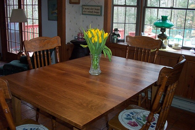

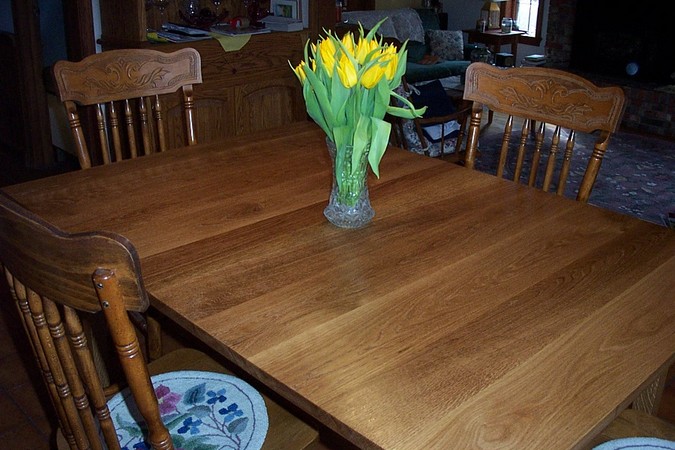

I guess this pretty well wraps up my project ! I put four coats of Watco Tung Oil on the top. The first two coats I cut with thinner to allow better grain penetration, and the last two coats were full strength. The top is still really not totally dry yet and needs to be totally dry before I put a couple of coats of Butchers Wax on it. Im quite happy with the way it cam out and so is Kathleen !:)

The second and third pic are of the table in our kitchen getting ready for many years of use !
